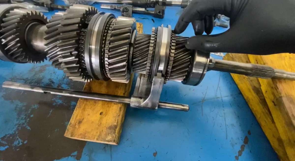

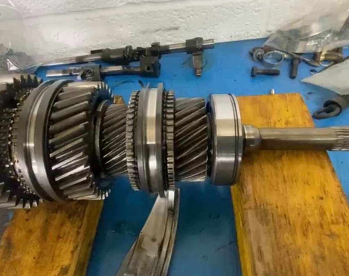

The first being an issue that I picked up on the drive home from picking the car up...gearbox issue, crunch from 4th to 5th. Not good! So I got the car down to Horsham Developments and told them I thought it was a worn syncro, they were skeptical at first until they test drove it and saw how bad the crunch was, very alarming as the car has only done 30,000 miles, so two things the issue needed to be sorted and I needed a full health check to make sure I had not bought an absolute dog.
After taking the gearbox off and stripping it down what I initially thought was correct, worn syncro. You can see in the pictures just how worn the teeth on the ring are. Parts from Nissan EU was going to take 5-6 weeks so Jez ordered them from Nissan US and they took 2 weeks to arrive.
New syncro and other parts replaced, gear box cleaned and built back up!

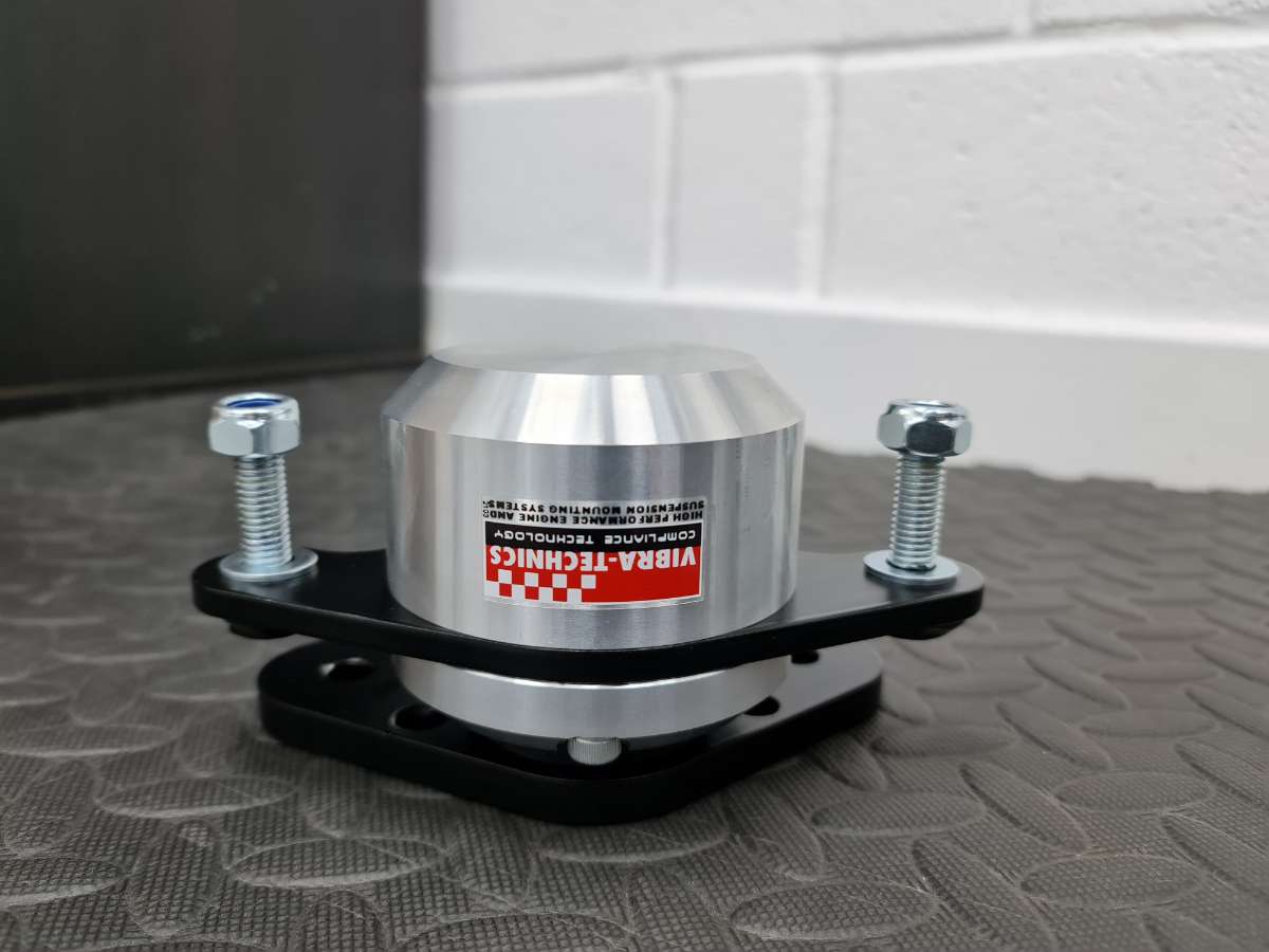

With the gearbox back in, fresh genuine fluid, I also had purchased a new transmission mount from vibra-technics for Jez and the team to fit.

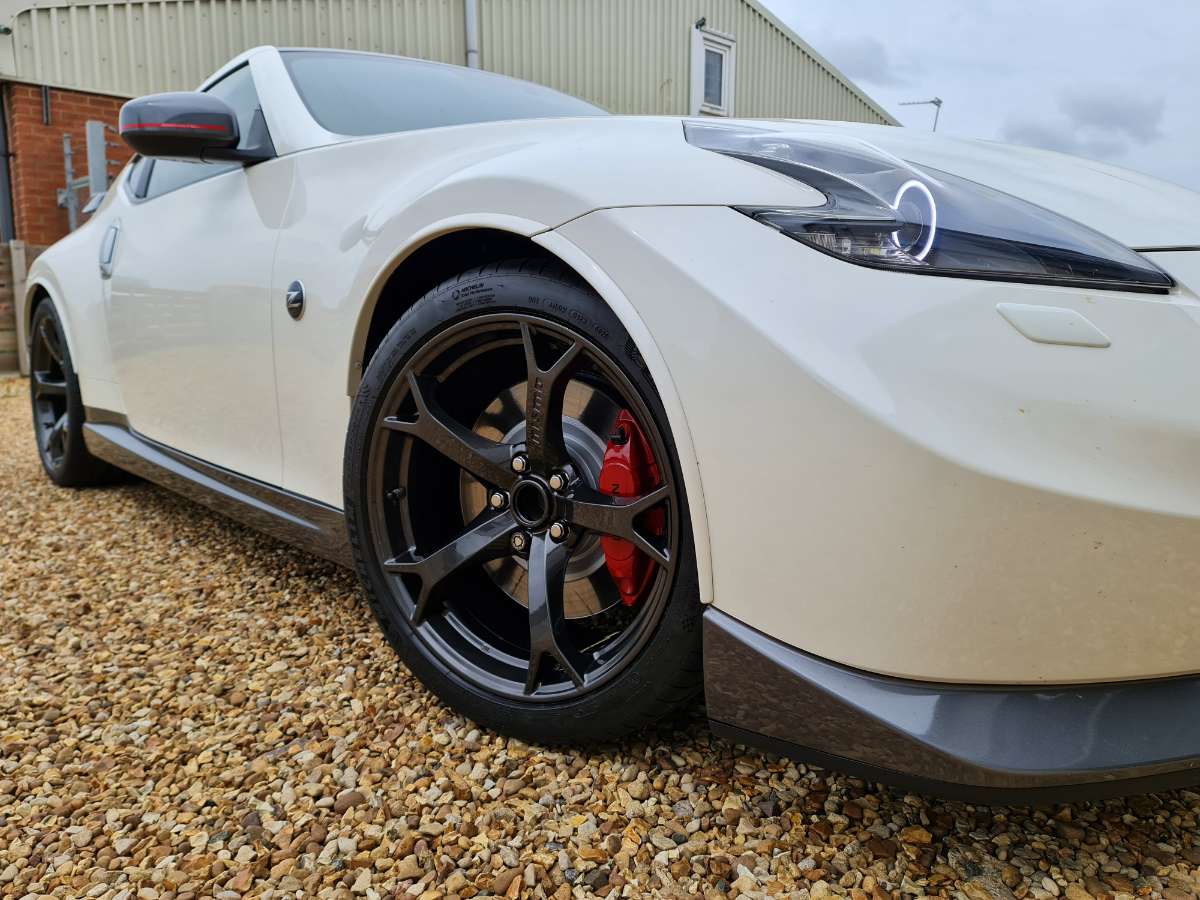

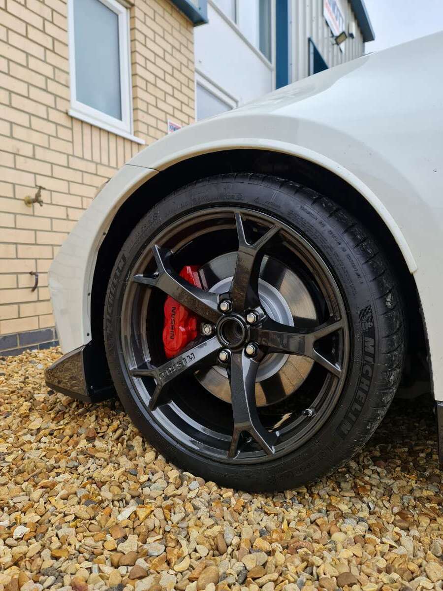

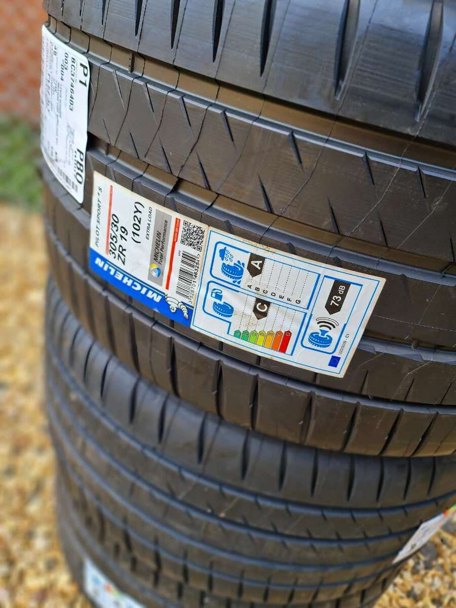

New tyres! As mentioned before the previous owner had put standard sized 370z tyres on the rears (275-30-R19) shame as they were Michelin Pilot Sport 4s, and up front were some Advans.
Odd tyres were driving me crazy so new tyres all around.
As many of the Nismo owners I upgraded to 305-30-R19 on the rear and 265-35-R19 up front. Went with the Pilot Sport 4s. Tempted by the new Bridgstone Potenza Sports as they have been on par with the 4s on all the testing done so far but too early to test the tread wear so was safe and stuck to what I know.
Car looks and feels so much better now, just gives that perfect look where as standard sizing the wheels look a bit lost in the arches.

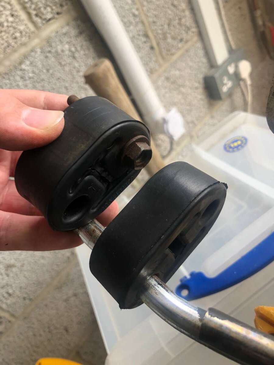

Exhaust, now I've never been a fan of short tails especially when the OEM Nismo system looks so good. The car had come with short tails on and the owner didn't have the original back box. Tbf the short tails don't sound too bad but they look awful :lol:
A very kind gentleman was giving his OEM system away for free as he had just upgraded, so I snapped at the chance.
After two hours spent cleaning it up using various grades of tar remover, wire wool, microfibres and Mothers Mag polish, it came up well!
Exhaust on, looks so much better. Lost nearly all sound but I'm not overly bothered plus the cabin noise is so much better, can hear more of the engine noises which is nice.

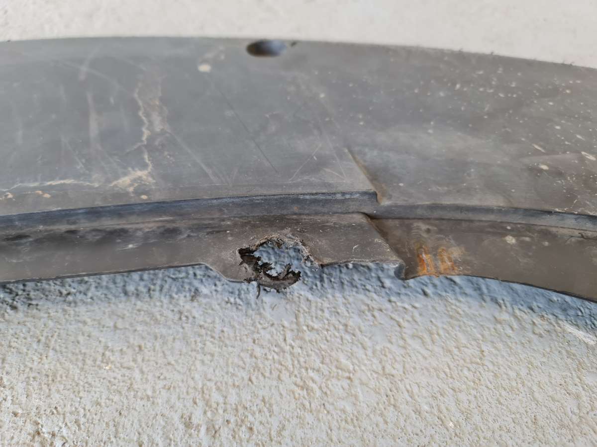

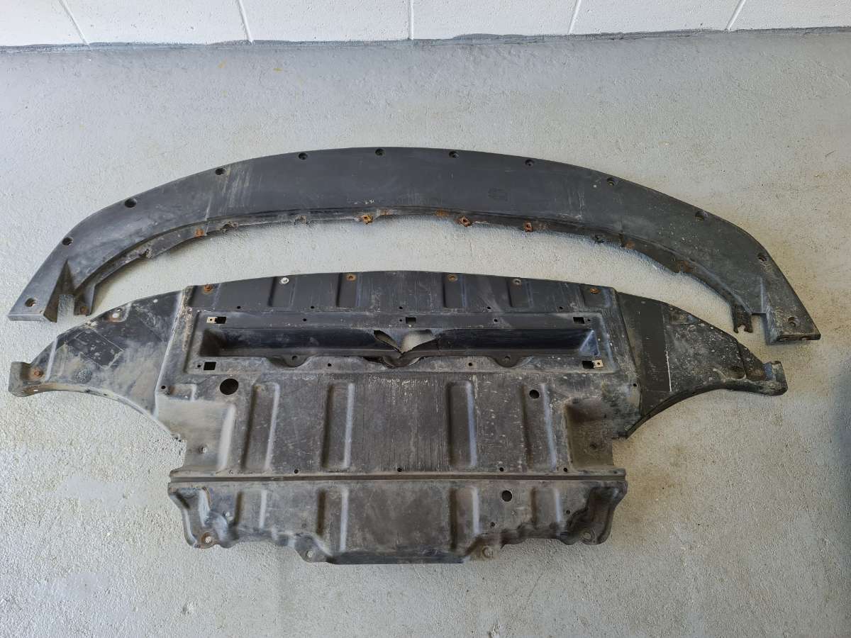

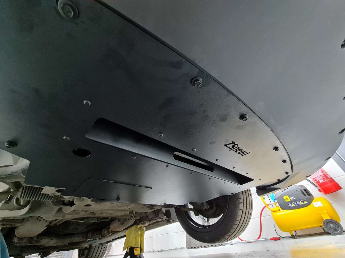

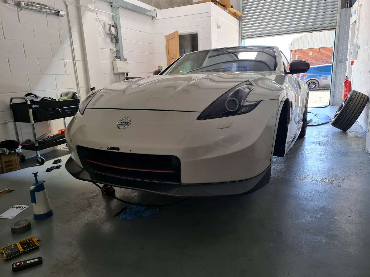

Finally my new front diffuser arrived from Japan. I had bought and received my Z Speed under-tray from Z1 Motorsports a while back but didn't bank on having to replace the front diffuser AS WELL!
My original under-tray was absolutely trashed, and was hanging on by about 3 bolts, a few self taping screws and cable ties. It would bottom out over the slightest of bumps and would flap around violently above 70mph. TBH it was ruining the driving experience and got so bad I didn't want to drive the car until it was sorted. So long story short I went to order a 370z Aluminium under-tray from Torqen then quickly realised that the MK1 Nismo has a different under-tray to the standard 370z and MK2 Nismo...great so after to speaking to @dave_7 he told me about the Z speed one from Z1 Motorsports. All in I paid £491.52, eye watering I know but it needed to be done, pay the money forget about it. Then after going to fit it I quickly realised the front diffuser which the front of the under-tray attaches onto, pretty much every plastic tab was snapped :dry:
So finding a new front diffuser it was! Nissan UK/Europe had nothing so looked on Z1 and to my surprised they had it listed on the site...the price was just, I thought the under-tray was bad. I expected it to be expensive being an exclusive original part by my oh my. All in I was going to cost me near £800, I honestly couldn't stomach that and at this point I was really deflated about the whole situation. After mentioning this to my customer who owns Ross Sport, he kindly said he would try and help me out as they ship parts in from Japan every week. He was able to get me the part for £720 all in so at least I had saved a little bit of money. When I received the text through saying found the part, will be £720 all in I replied yes thats great thanks, put my phone down, forgot about it and would just deal with the financial heartache once the part arrived :lol:
So here is OEM + Old Diffuser vs Z Speed + New Diffuser.

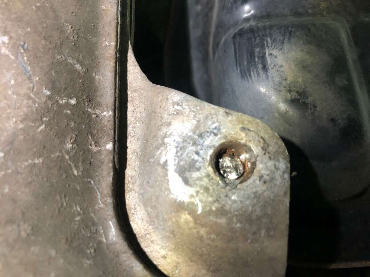

Everything was easy to install...thats if you don't discover snapped bolts in the pressed rivet mounting points :headhurt:
After spending hours trying to extract the bolt without damaging the thread of the rivet we gave up and just drilled out the rivet itself. Was lucky a friend came to help out and keep me company throughout the night. It was only the two back points that were like this so cable ties will do until I put another rivet into the hole we drilled.
Everything on and now feels solid, hats off to Z Speed the under-tray is a very nice bit of kit (ignore our greasy finger prints haha)

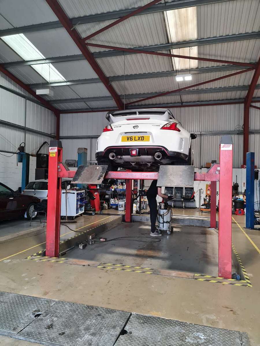

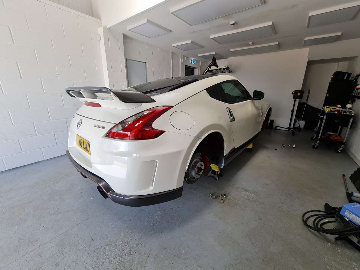

Moving on a few weeks I had a cancellation at work so used the time to get my car in and finally get the wheels refurbished and do the front brake hubs to match the rear.
Hubs sanded down, masked up and painted with Hammerite. Went with the OEM silver look as had already done the back ones that colour. I actually think from factory the hubs are black but oh well!
I also cleaned the wheel arch liners, de tarred them then coated with Gyeon Trim. Also whilst I was cleaning I popped this cover off to flush all the crap that this traps, its such a bad design, very surprised they carried it over from the 350z, doesn't make sense to me. I will sand down and seal properly at some point as you can see its already rusting.
Hubs complete, brake calipers cleaned, machine polished and coated. New bleed nipple covers put on as well. Looking fresh!
Wheels back from the refurb place, I decided to sway away from the OEM colour slightly and went for a darker metallic grey, so pleased with how they have come out! :yahoo:
I think they suit the darker tone of the car very well with the roof being black and the internals of the lights. Of course these were coated too.
IPA wipe down, then coated with Kamikaze Collection Stance Rim v3.
Wheels back on. Just waiting on brand new lug nuts and new Nissan Centre caps to arrive from Z1 and that will complete the whole wheel area. Going to take a break now with the car as I've definitely spent a lot more money then expected over the last month. But really happy at where its at now :D

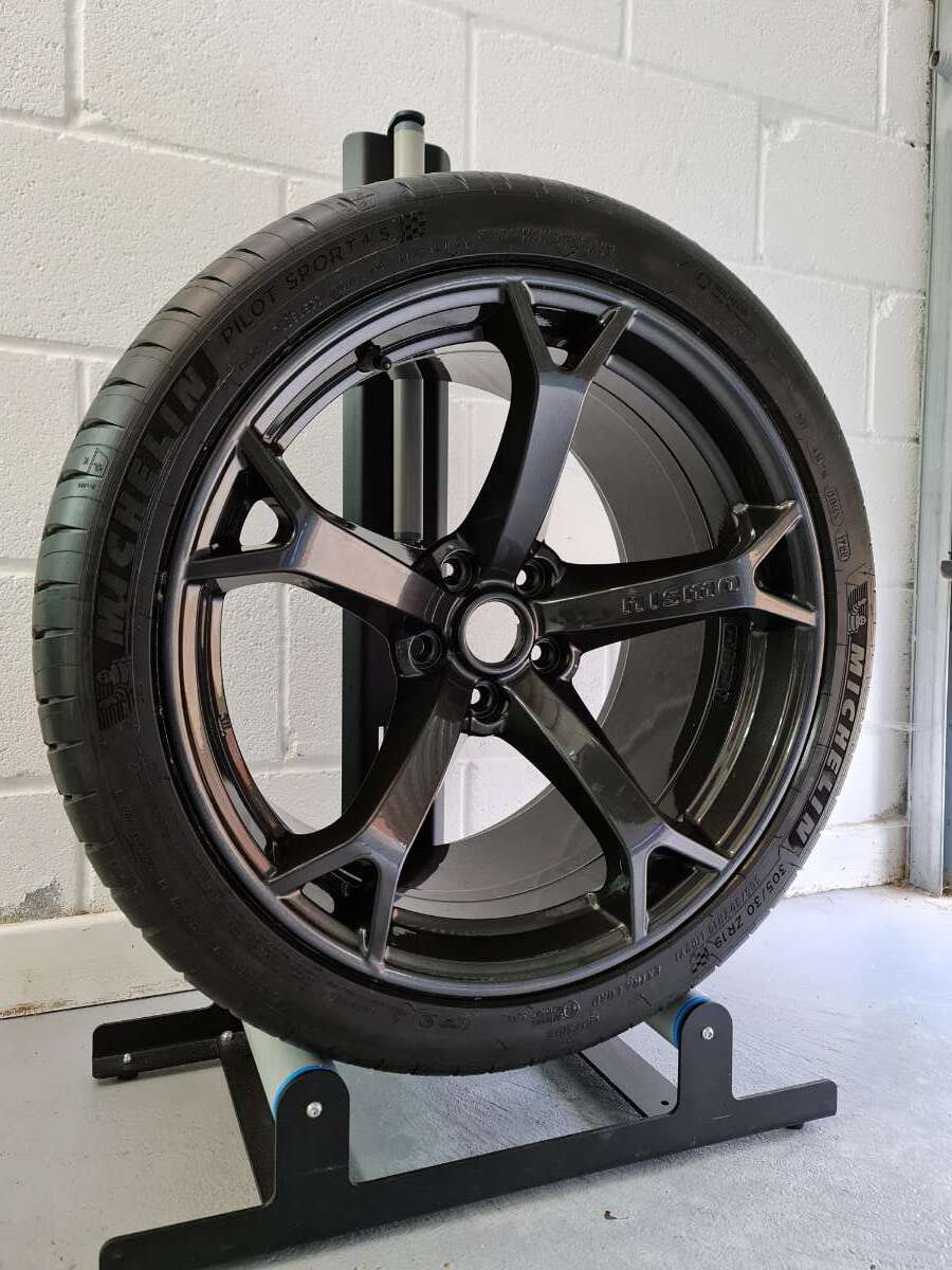

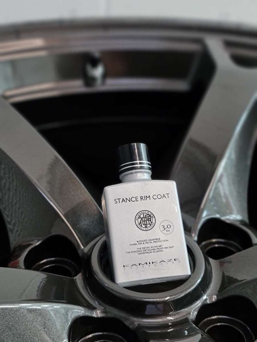

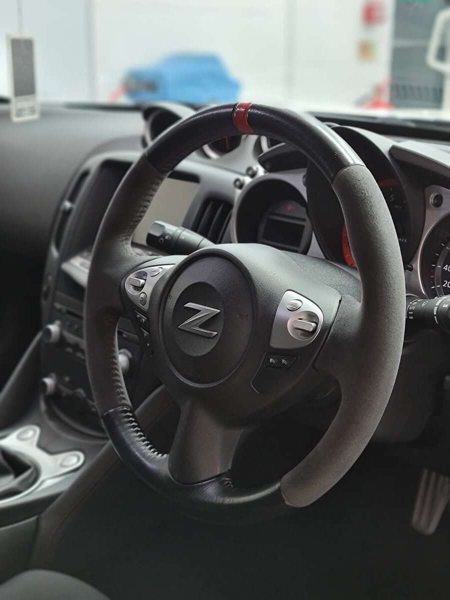

Unfortunately Nissan use a faux alcantara on the steering wheel so the quality is not great and the fibres tend to build up. So used Colourlocks leather sanding pad and fabric cleaner. Worked a treat! I think I will end up getting it re-trimmed by Royal but thats good enough for me atm.

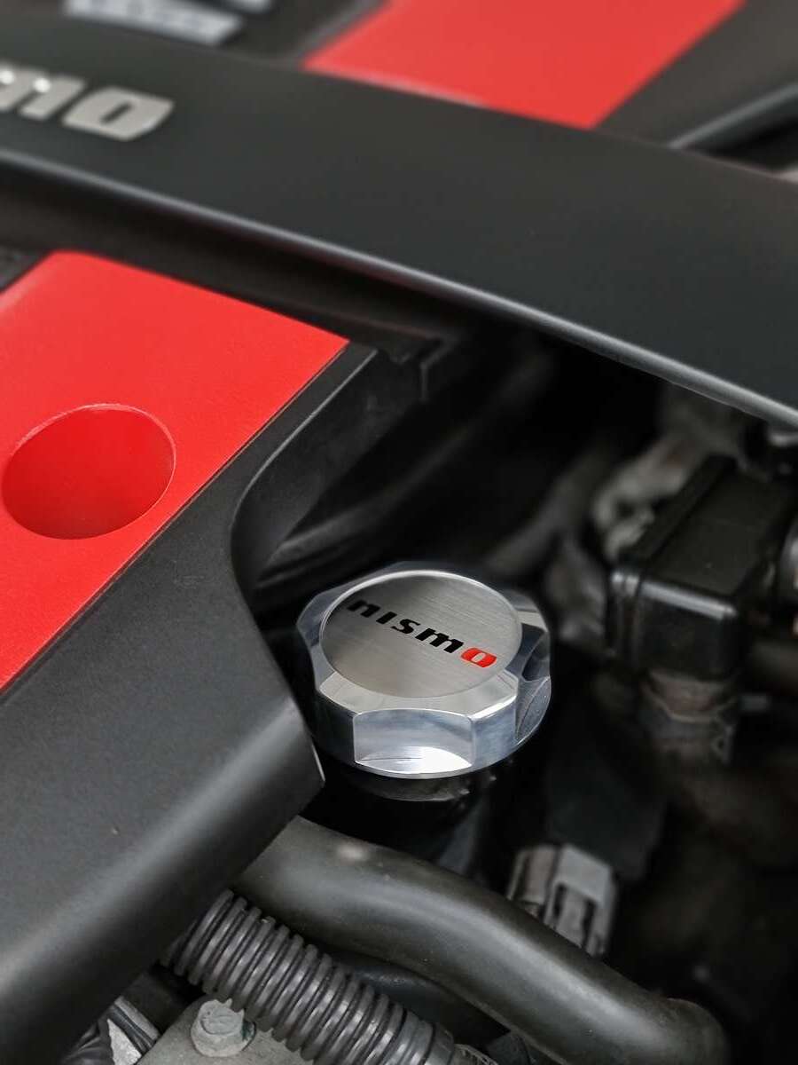

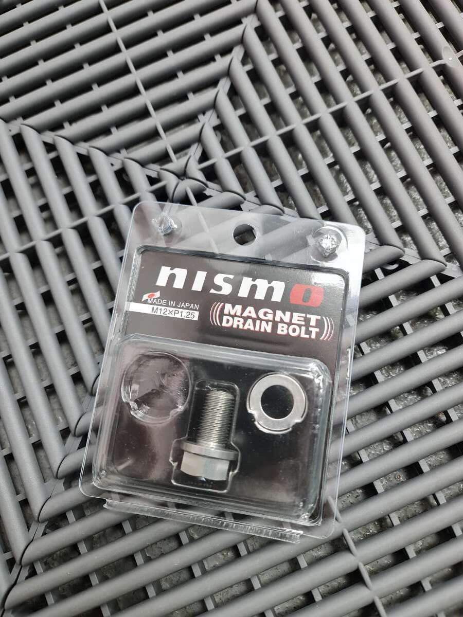

Santa came through with some Nismo goodies, floor mats, oil cap, fuel cap and oil drain plug :yahoo:

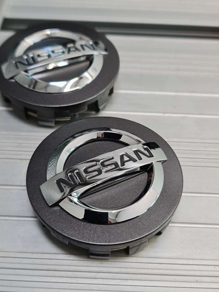

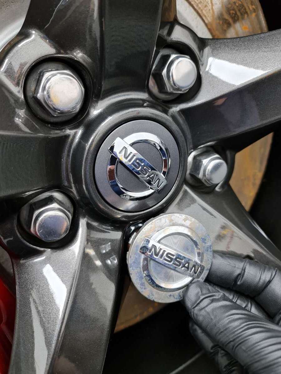

Finally fitted new centre caps after coating them. Only replaced 2 out of 4 as the others were okay, after a quick polish and touch up they were as good as the new ones. As for the other crap I have no idea what one of the previous owners were thinking.
20210929_160844.jpg.5c061e87122163cfb94061f1febd75fb.jpg20210929_162339.jpg.c6583bdce066703f19fd164c542cc62d.jpg
