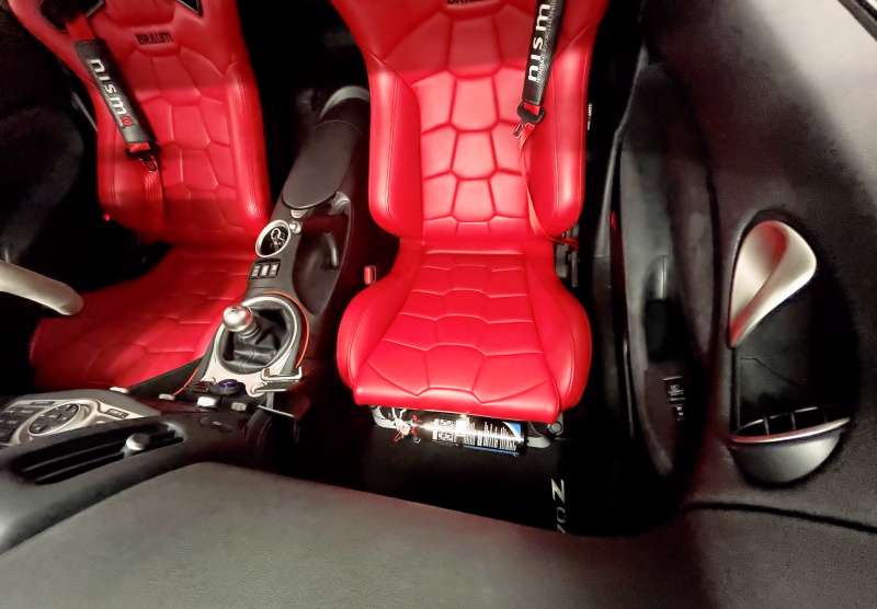

V1H Posted August 26, 2021 Author Share Posted August 26, 2021 (edited) From a long time I've been wanting to get a car fire extinguisher, you never know, Youtube is full of burnt-down builds. So I bought from Amazon a Firexo 500ml Extinguisher (good for all fires A, B, C, D, E, F, that is, incl. LiFePO4 battery!) and a Kap Industries fire extinguisher bracket through Tegiwa Imports. I like the extinguisher is NOT SIMPLY RED and my mounting location in front of the passenger seat hides it almost entirely yet is in direct reach in an emergency. Edited August 26, 2021 by V1H 3 Quote Link to comment Share on other sites More sharing options...

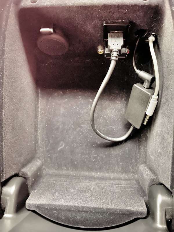

V1H Posted August 29, 2021 Author Share Posted August 29, 2021 (edited) On 22/07/2021 at 15:52, V1H said: 1) Final Infotainment upgrade with a DAB+ Radio adapter, since the 370Z FM radio reception sucks balls 😅 This will be the Pure Highway 400 V2 EU/UK [#151603] I now installed the DAB+ and found 67 stations right away. There is the occasional drop out when driving around town but radio reception is better than the factory FM radio. I'm not yet decided on the mounting location of the wireless Display unit (battery operated). An alternative might be the door panel: The DAB+ antenna is attached inside the windscreen, virtually invisible with my sun stripe hiding the receiver unit. The power cable is routed to the nearest cigarette lighter socket and uses the included 5V adapter. A magnetic grounding cable slides in between the roof liner to bare roof metal. A third cable is for optional audio Line-In to the factory radio. The Highway 400 can be piggy backed by either hook-up to an unused FM frequency or via said Aux-in/Line-In. I opted for the latter (quality is said to be better). That is, feeding the audio signal via the Z's USB/iPod port in the centre console. In below image, the black audio jack is routed to here straight from the Antenna/Receiver on the windscreen. (The white audio jack is the Line-In cable from my Android Infotainment Unit, but it becomes obsolete now with the Highway 400. The short Audio jack-to-USB adapter came with my Android Infotainment Unit, which might otherwise have to be purchased, e.g. this but cheaper) I can also play any music from my smart phone via the Highway 400, when in BT Mode, and I used the Pure Go App initially to notify me about an Antenna Firmware update. I needed to use a Windows Laptop to upload this update, though. Edited August 29, 2021 by V1H 1 Quote Link to comment Share on other sites More sharing options...

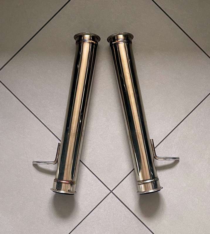

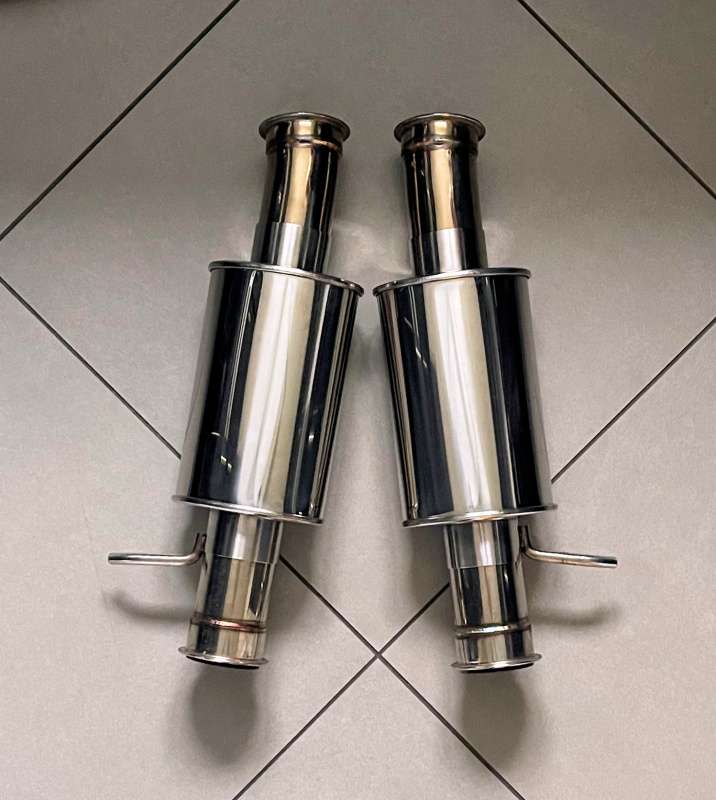

V1H Posted September 17, 2021 Author Share Posted September 17, 2021 (edited) On 22/07/2021 at 15:52, V1H said: 2) 'inspired' by my 5yr old son who loves to drive in my Z but dislikes the noise when I accelereate, I am going to slightly tone down the noise with a pair of 3" straight-though silencers courtesy of Vibrant Performance Ultra Quiet S/S Resonator [#1142], which I got for a steal at Amazon US. Here we go, the silencers are in and I just fired her up in my garage. Instant reaction: I ABSOLUTELY LOVE THEM !! 🥰 I havent measured dB before or after but my exhaust feels approx 30-40% quieter. It's still a loud cold-start but not obnoxiously loud anymore (and neighbours should thank me). Neo will also be pleased I hope when he sits in it next time. Fitment is excellent in the driveshaft tunnel, when done right. I removed my Motordyne midpipes, cut them up myself and positioned the silencers exactly before I took them to a TIG welder. Else there might have been clearance issues. Original 3" midpipes Midpipes with Vibrant Ultra Quiet Silencers (before TIG welding). This mod adds 3.37 kg weight. Fitted back onto the car. Clearance all round. Edited September 17, 2021 by V1H 2 Quote Link to comment Share on other sites More sharing options...
