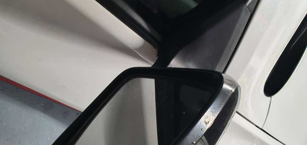

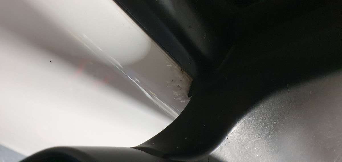

Midlifemick Posted January 12 Share Posted January 12 Hi Guys, Having purchased a used 2015 370 Nismo with 47k on the clock, I was surprised on closer inspection to find upon it's first 'proper clean' that there is some corrosion forming under both of the wing mirrors (one side worse than other). Having searched the subject I can see this is fairly common and others have had the issue sorted under the 12 year anti-perforation warranty. However, I'm not going to be that lucky, as mine hasn't been serviced at Nissan in the most recent years. My question to you all is, am I better off leaving it until it becomes obvious (at the minute it isn't really) or shall I get it sorted sooner rather than later? I understand the doors are aluminium so struggling to see how they are corroding so easily Pic so you can all see it 😬 Thanks in advance! Quote Link to comment Share on other sites More sharing options...
ZMANALEX Posted January 12 Share Posted January 12 Common issue because of poor design causing a water trap resulting in "corrosion." Don't let the lack of dealer service history put you off from asking your Nissan dealership to raise a claim under the 12 year perforation warranty. The Nissan dealership may well support you with your claim as it is Nissan UK that will be footing the bill, generating much needed revenue for your dealership. 1 Quote Link to comment Share on other sites More sharing options...
Midlifemick Posted January 12 Author Share Posted January 12 20 minutes ago, ZMANALEX said: Common issue because of poor design causing a water trap resulting in "corrosion." Don't let the lack of dealer service history put you off from asking your Nissan dealership to raise a claim under the 12 year perforation warranty. The Nissan dealership may well support you with your claim as it is Nissan UK that will be footing the bill, generating much needed revenue for your dealership. I'll give them a call, cheers for the advice Quote Link to comment Share on other sites More sharing options...
ZMANALEX Posted January 12 Share Posted January 12 33 minutes ago, Midlifemick said: I'll give them a call, cheers for the advice I would just rock up at there dealership unannounced and ask them to inspect your vehicle and to raise a claim. I would not even mention the lack of service and paint inspection history, just keep shtum. Good Luck. 2 Quote Link to comment Share on other sites More sharing options...
Midlifemick Posted January 13 Author Share Posted January 13 17 hours ago, ZMANALEX said: I would just rock up at there dealership unannounced and ask them to inspect your vehicle and to raise a claim. I would not even mention the lack of service and paint inspection history, just keep shtum. Good Luck. Good shout, will give that a try! Quote Link to comment Share on other sites More sharing options...

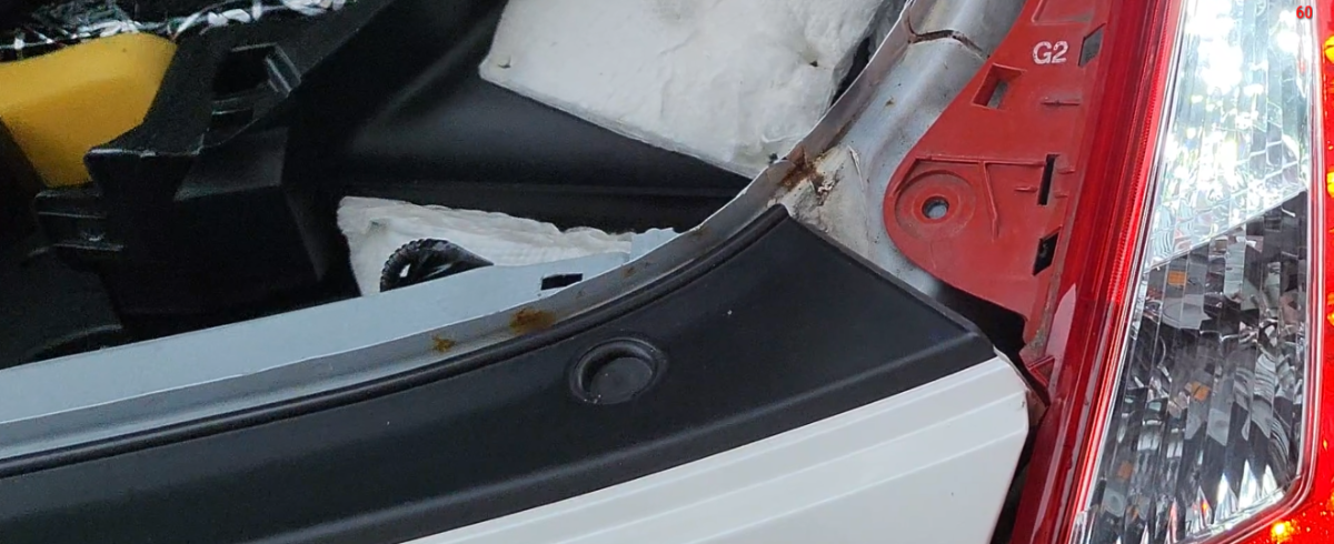

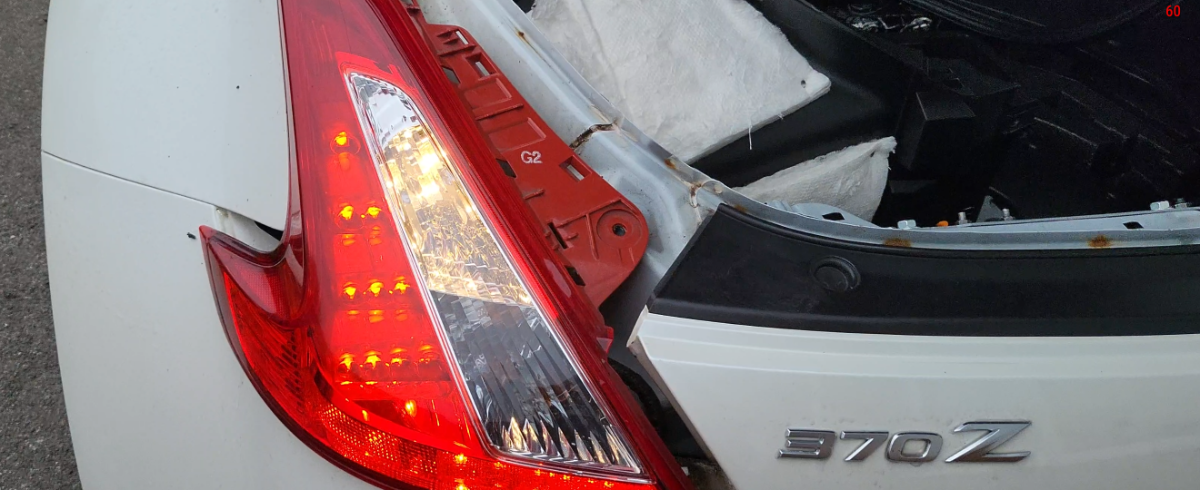

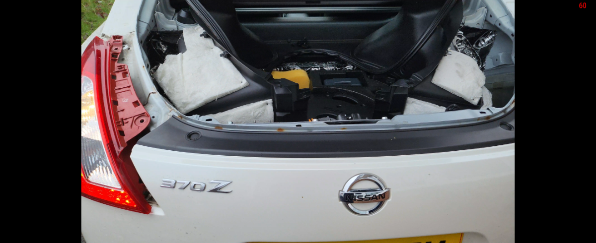

StormtrooperZ Posted January 16 Share Posted January 16 Sorry to hijack the thread, but while we're all checking for corrosion. I noticed this on mine yesterday while changing out some bulbs for LED ones, rust spots all underneath the weatherstrip in the boot...eek! 1 Quote Link to comment Share on other sites More sharing options...

Midlifemick Posted January 16 Author Share Posted January 16 4 minutes ago, StormtrooperZ said: Sorry to hijack the thread, but while we're all checking for corrosion. I noticed this on mine yesterday while changing out some bulbs for LED ones, rust spots all underneath the weatherstrip in the boot...eek! Oh that doesn't look great, wonder if mine is the same! Not great for corrosion these cars it would seem! 1 Quote Link to comment Share on other sites More sharing options...

Willsy1980 Posted January 16 Share Posted January 16 @*!#. Guess i'll be pulling some weather strips off and checking mine. May invest in some cavity wax and get her covered before its too late. 1 Quote Link to comment Share on other sites More sharing options...

Olly350z Posted Friday at 09:00 Share Posted Friday at 09:00 On 16/01/2022 at 10:42, StormtrooperZ said: Sorry to hijack the thread, but while we're all checking for corrosion. I noticed this on mine yesterday while changing out some bulbs for LED ones, rust spots all underneath the weatherstrip in the boot...eek! What was the outcome to this? I've looked at mine and have exactly this, in exactly the same places. It's caused me to go over with a fine tooth comb and I've not found anything else but want to get this sorted. I have full dealer history so wondering if Nissan will be kind especially as I work for them Quote Link to comment Share on other sites More sharing options...

StormtrooperZ Posted Friday at 10:52 Share Posted Friday at 10:52 1 hour ago, Olly350z said: What was the outcome to this? I've looked at mine and have exactly this, in exactly the same places. It's caused me to go over with a fine tooth comb and I've not found anything else but want to get this sorted. I have full dealer history so wondering if Nissan will be kind especially as I work for them I cleaned it up a little and left it to that. I don't have full dealer service history, so doubt Nissan would entertain looking at it. But for you sounds like a no brainer mate. Get on to them & see what they say. Quote Link to comment Share on other sites More sharing options...
