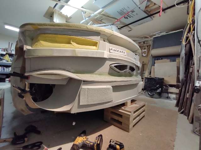

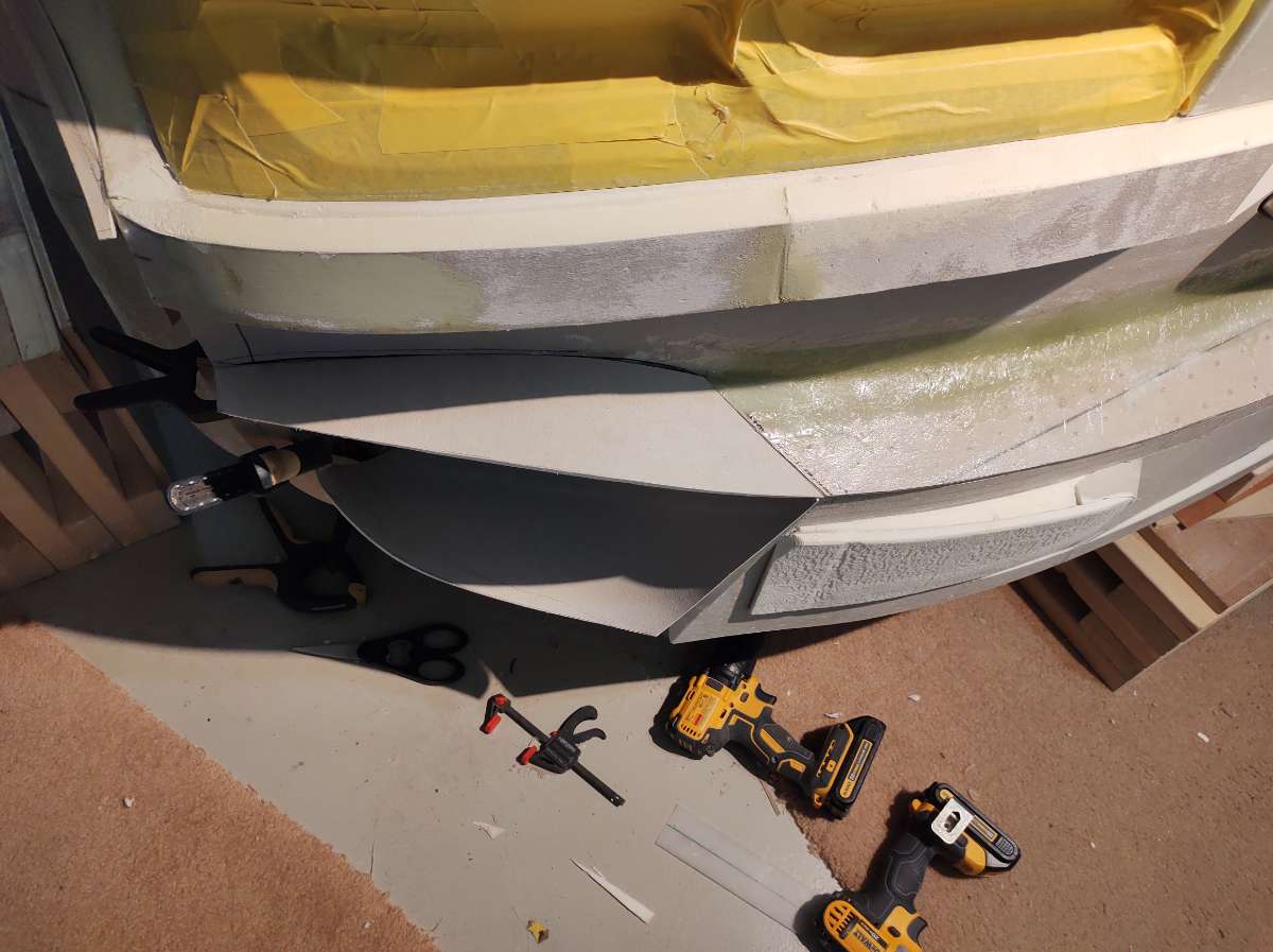

More on the back of the car , trying to get the quarters filled in , but in order to do that I need to finish some of the back to find out where I am going to end up .
these pieces go under the tail light tray to hold the contour of the large panel around the exhaust.
here they are installed

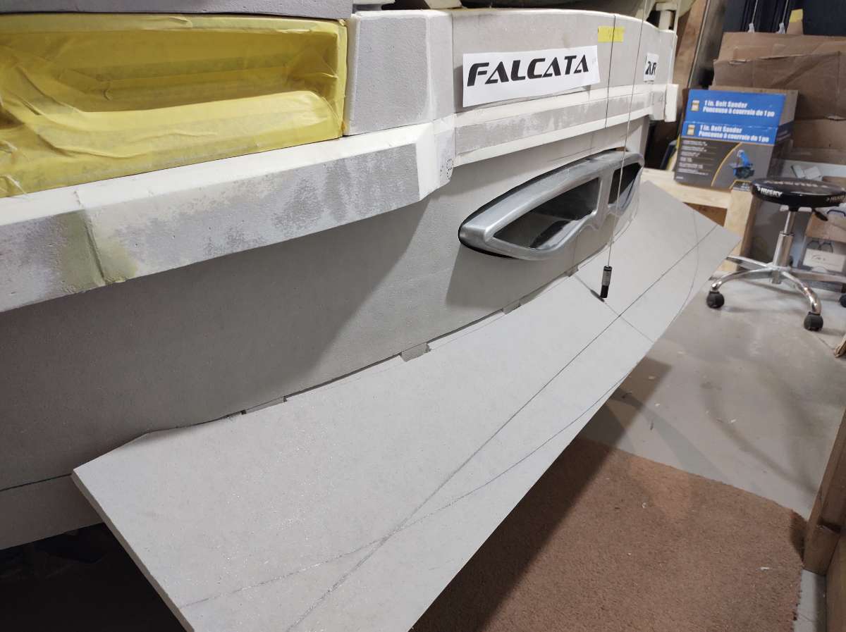

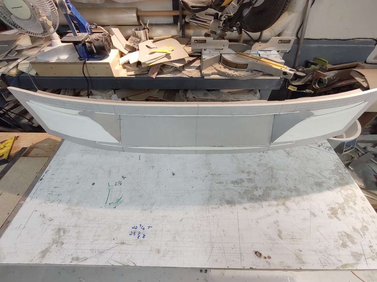

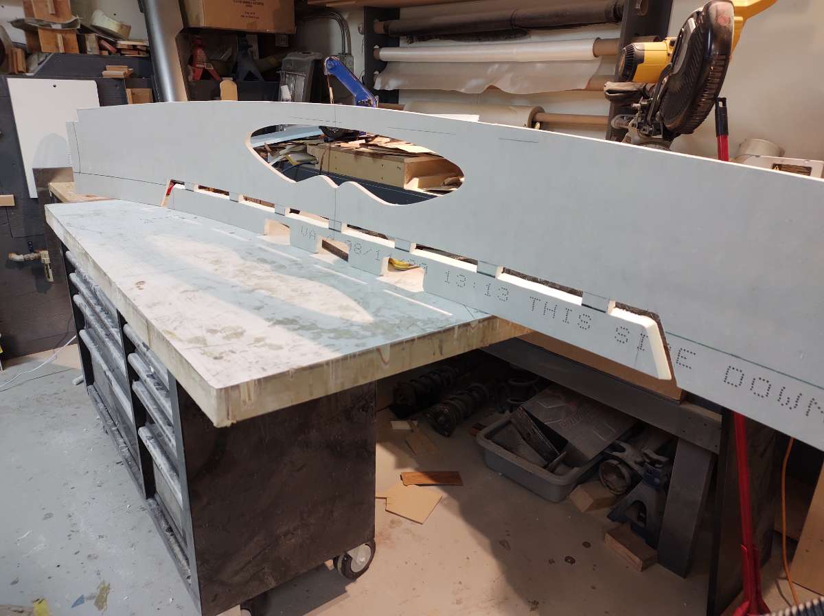

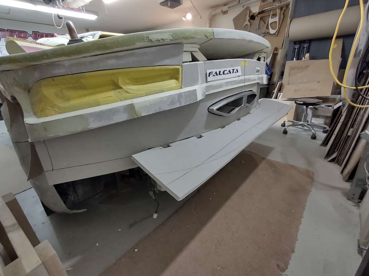

next is the large panel , tricky with the curve ...
fits pretty good if I do say myself

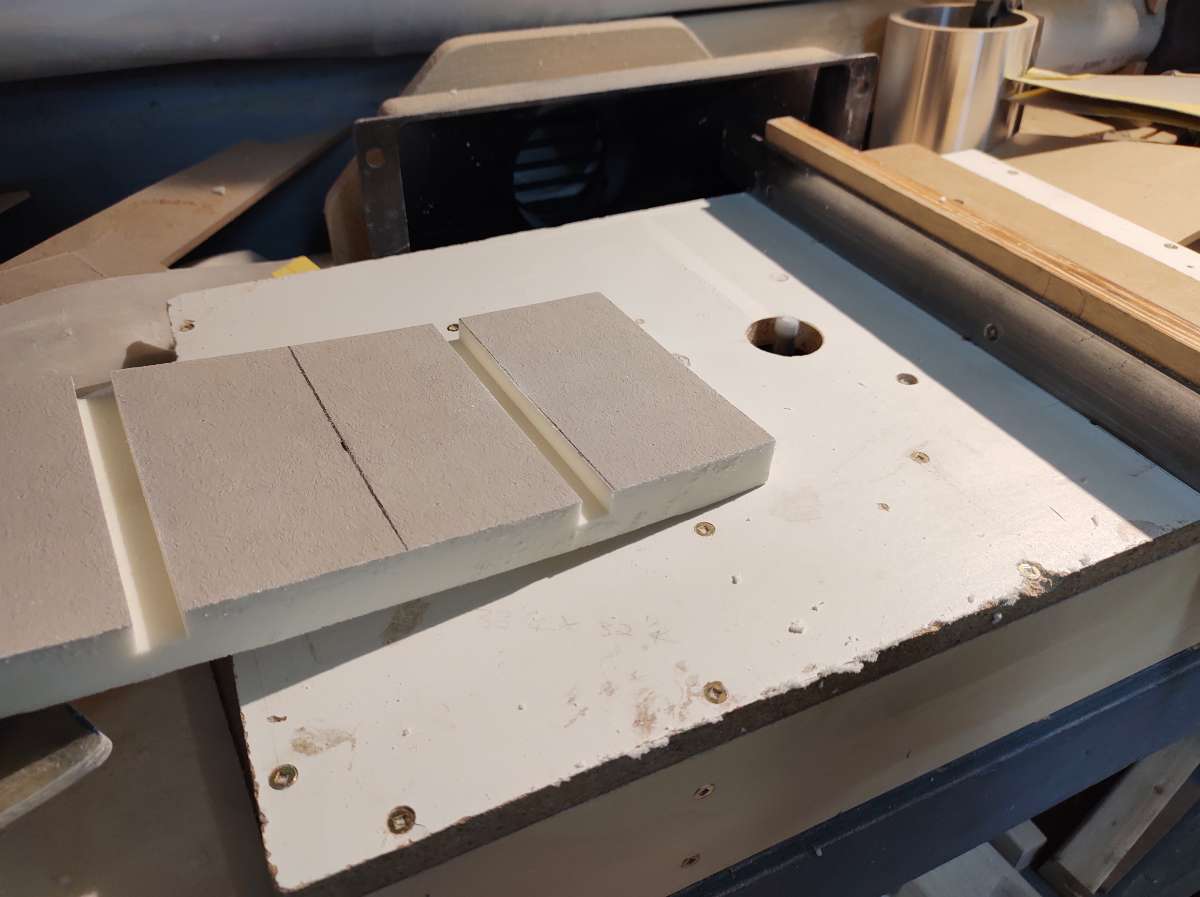

I slotted these parts to make it easier to hold together .
Just a bit more trimming
Checking the overhang to the end of the trunk lid
quick skim of filler to hold it for now .

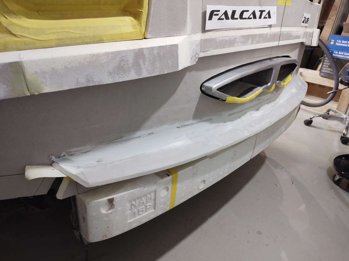

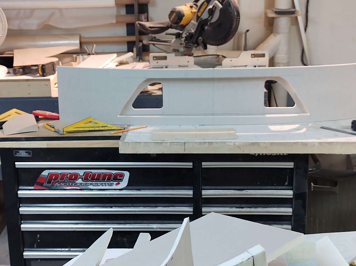

Laying out the licence plate surround , it will be long enough for Euro plates also, just incase someone wants one ...

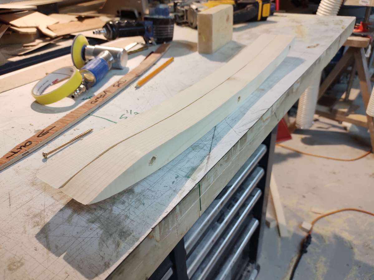

routeing the parts to lock together
gluing the bits
I made this wider so i can trim to the contour later .
This is it right side up lol .
Stay tuned and stay safe everyone !!!

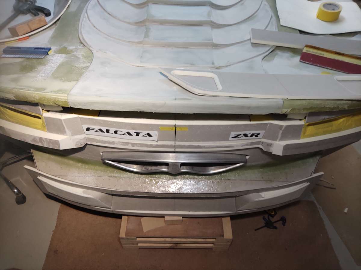

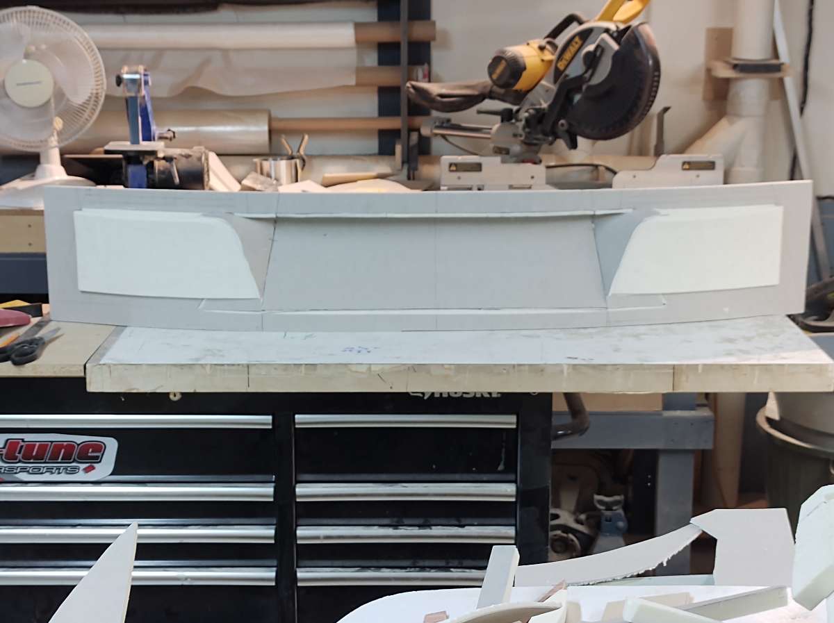

Ok licence plate area ............this is like version 3 now  .
The first one just didn't flow with the rest of the car
Will show you version 2 ...........just was ugly
This is the back ...................of course

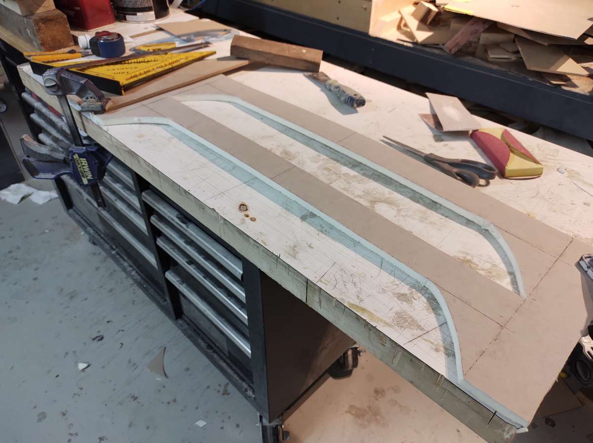

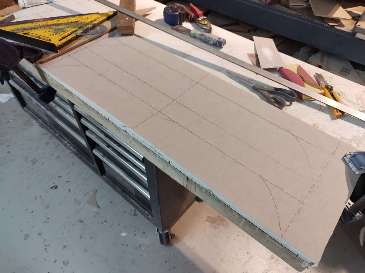

Router template
It just didn't flow so it had to go ......
So this is what I came up with version 3
I kept the main body but changed the middle , first cut out he center and made a new one , with the same angle as the inside line of the tail lights then added some strips to bring out the feature line to flow with the exhaust tip .

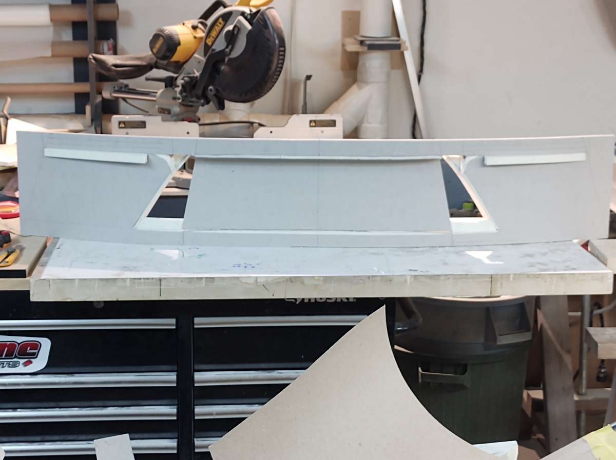

Planed down some foam to make the compound curve
Added a one inch block to reduce the bottom opening and made a pattern for the thin foam
with these ready I made the cover plates
Ah much better

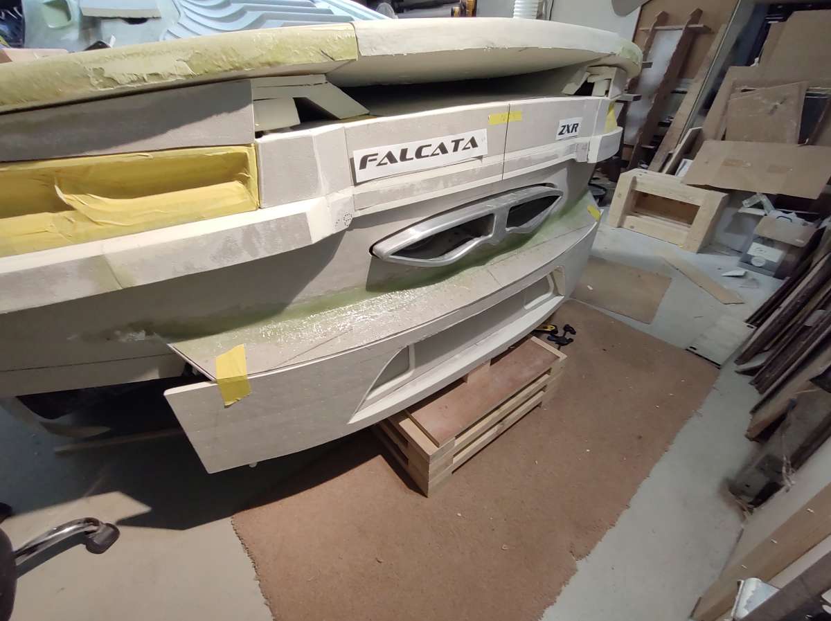

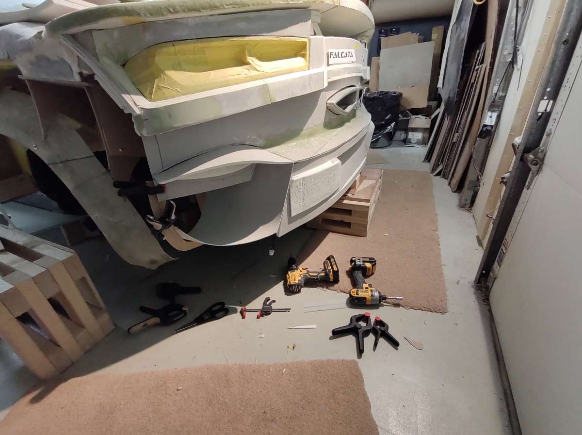

I had the garage door open for the first time in a long time to stand back and look .... just thought I would add a couple of pics for fun !!!!
Oh it's going to be Nasty ......

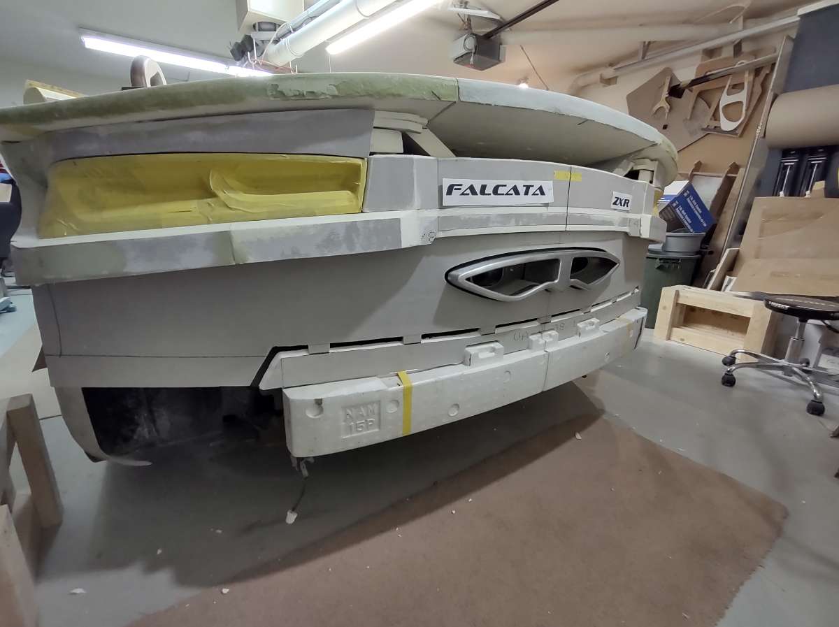

Still tons of bodywork ahead ..... here you can see the symmetry is much better now , with the angle of the inside of the tail light and the part right below to the inside edge of the licence plate area , now it flows , working on the bottom rear corners right now .

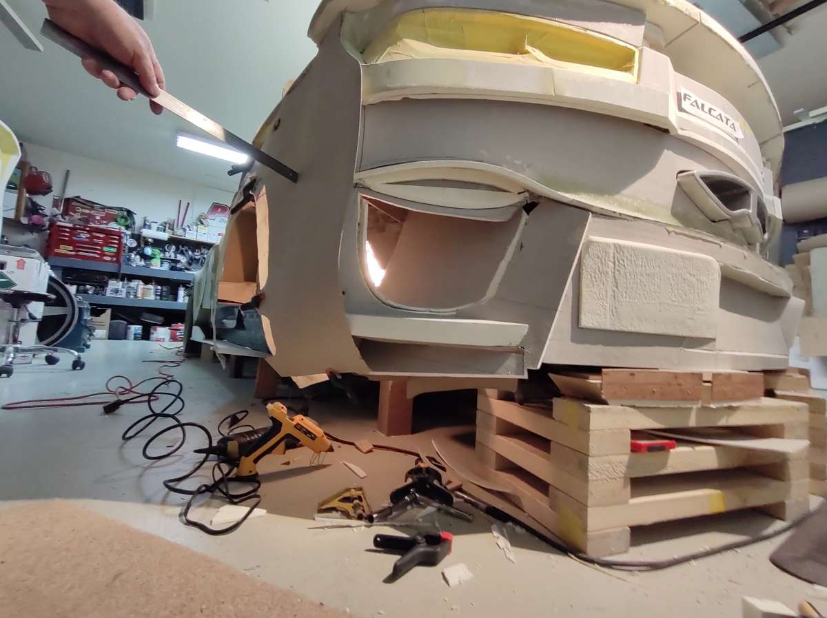

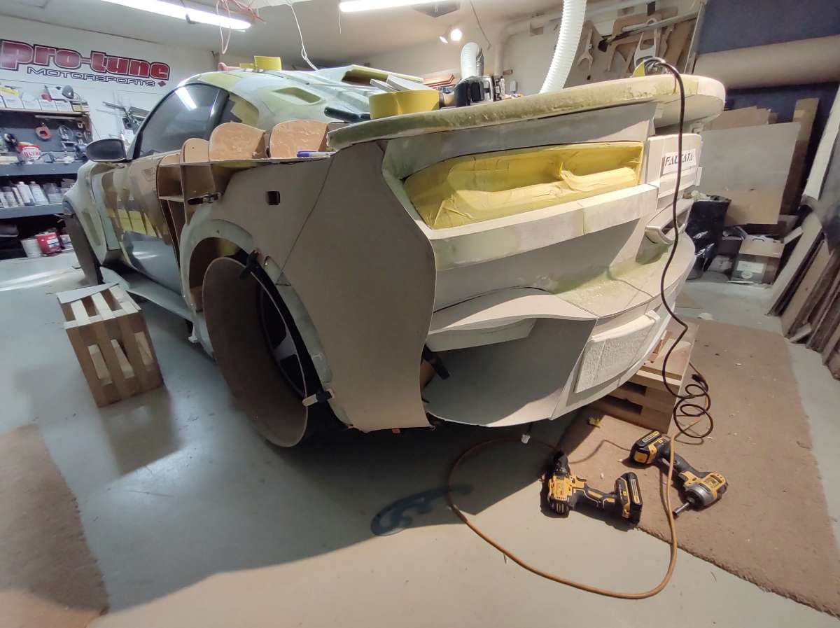

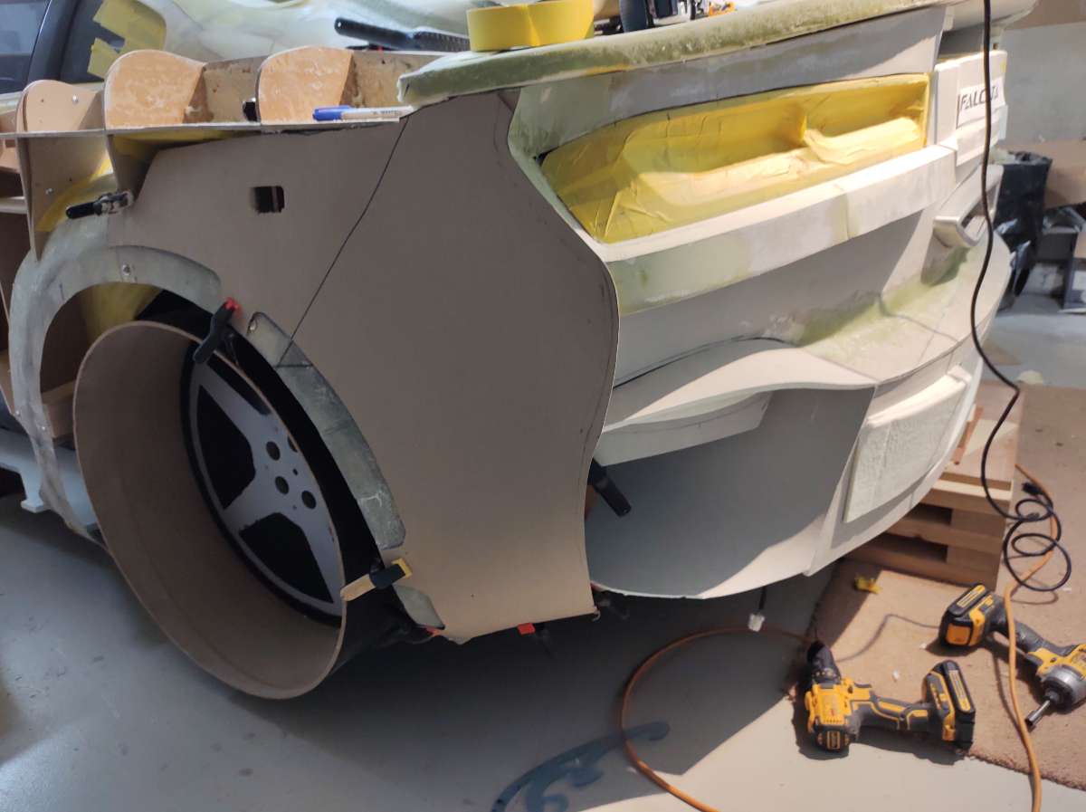

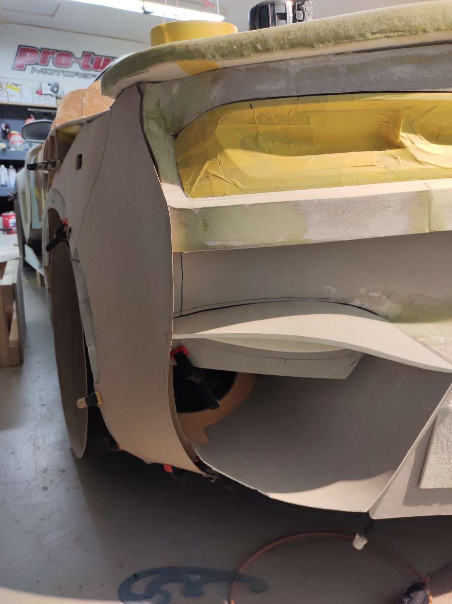

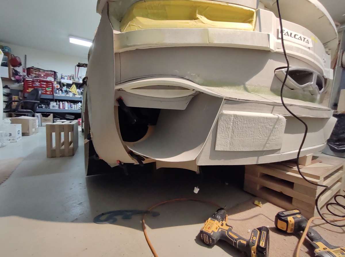

Just have time to post a few pic's of the back corners .
Rough idea of how it's going to be in the back  corners .
It's just mocked up , still need to finish the bucks to hold the ducts in place
the top of the eyebrow will get closed as it goes into the duck roughly were the lower black line is , i wont cut it until I know i like it .

Hi
Another small update on the back corners , this a mock up of what's going to happen .
This piece will be removable to access the tail light , the parting line is black line on an angle .
the eyebrow will have a bottom that goes into the duct , the inside of the duct on the outboard side will be the removable panel

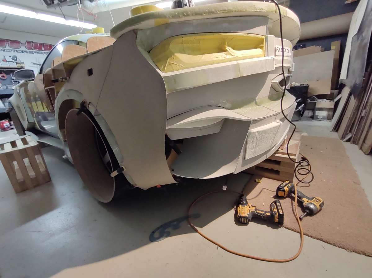

I was just wondering if the internet was broken .....? or if there are fish nibbling on the cable again ......lol

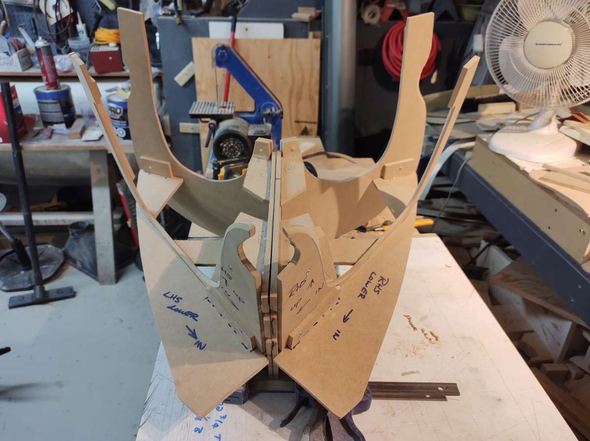

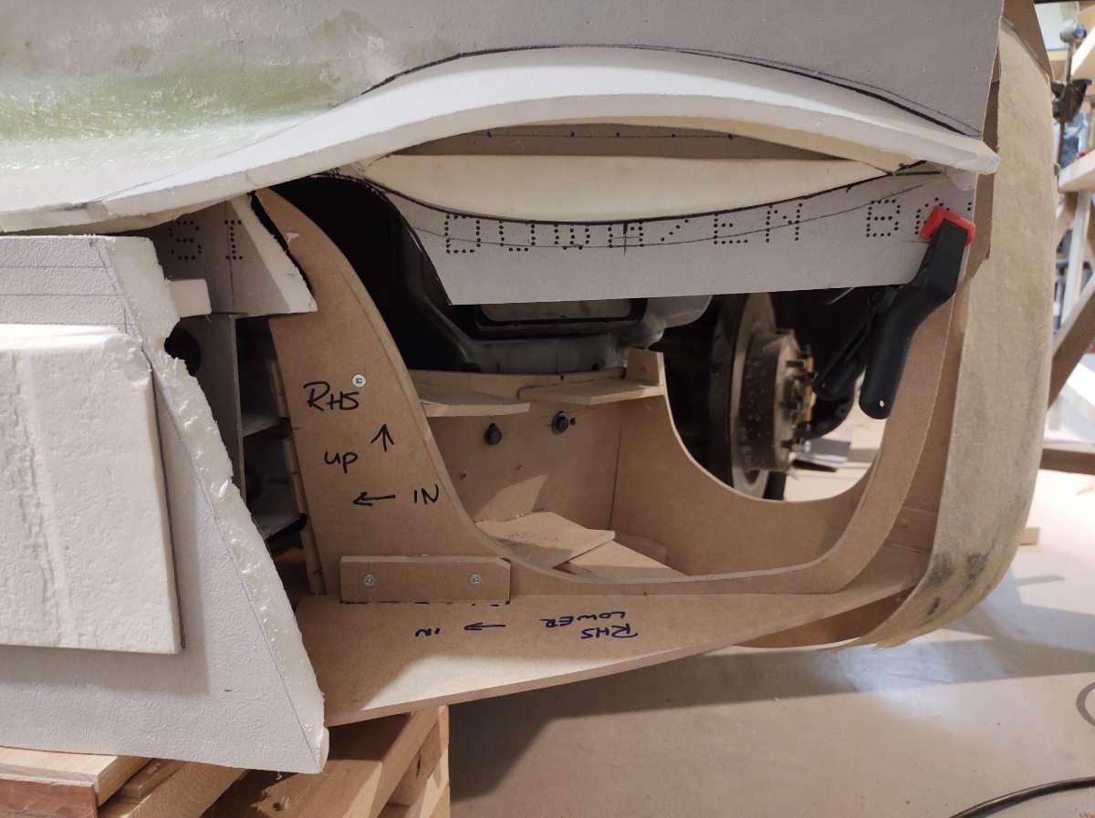

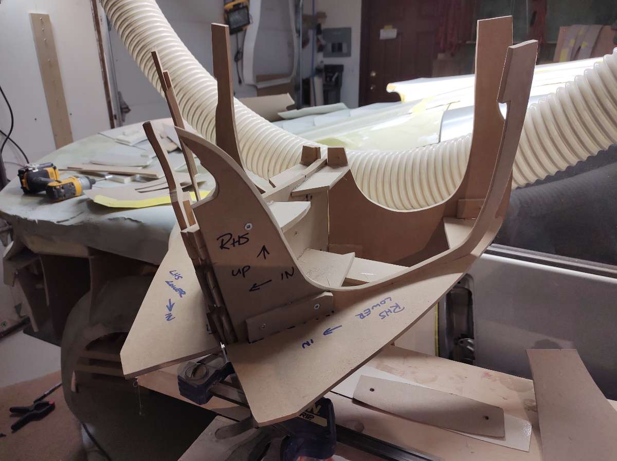

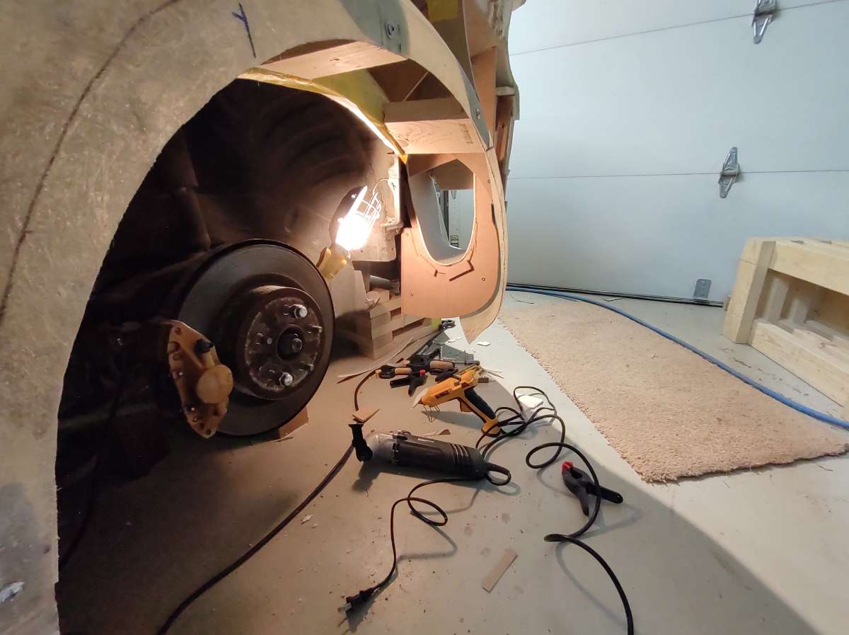

these are the wooden bucks to go in the back corners they are back to back so I can make sure the are the same .
Of course the car isn't the same underneath , charcoal canisters etc .
like my buddy tells me if it was easy everyone would be doing this ..
Left hand side
and the right hand side , next is to install the foam , these have to be removable because I really don't want to glass these and do the bodywork on the floor .
So i have to be able to reach up inside and remove the bolts, so the back panel including the corners can come off .
  • Like 5

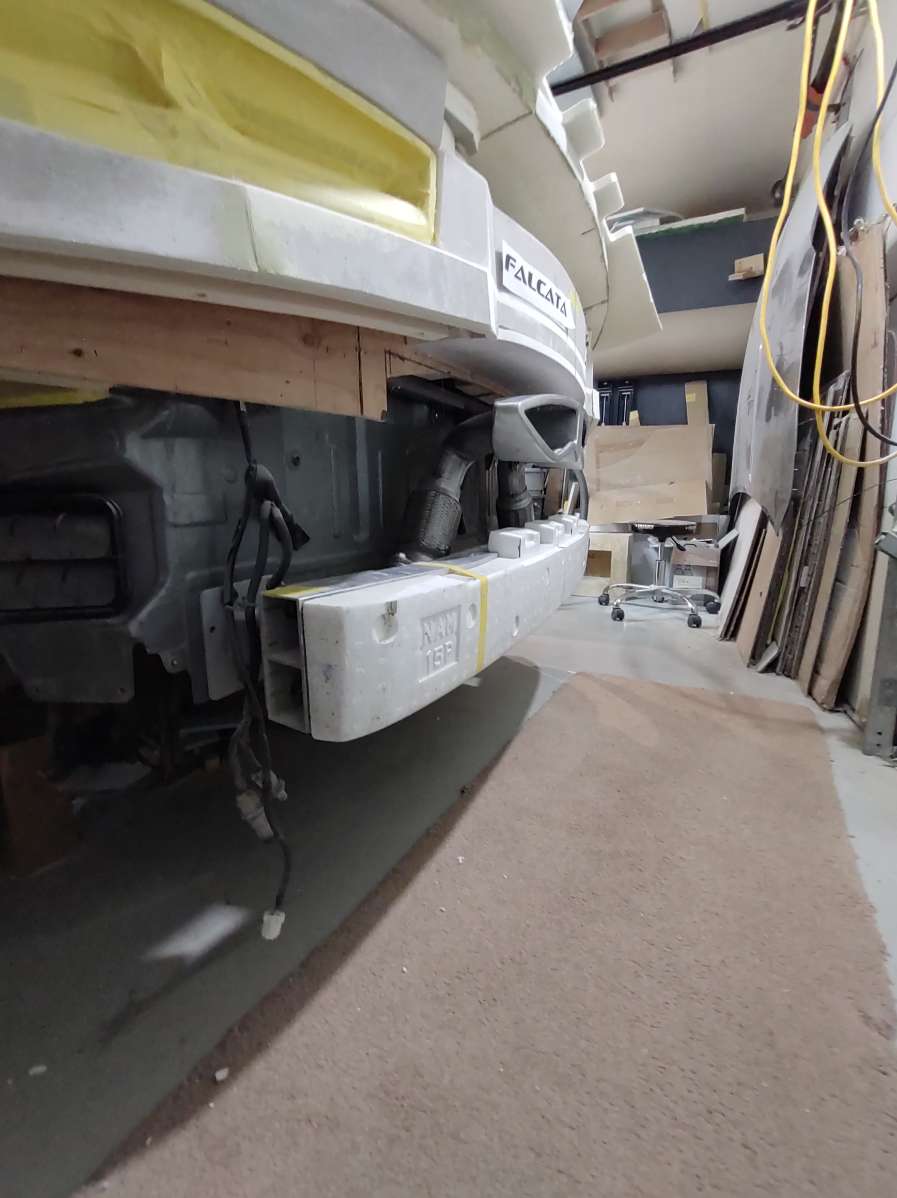

Made a few small changes to the rear vent area

Hi everyone
Thanks for hanging in there , so slow times on the car at the  moment , still chipping away at it .
a little more on the back end .
