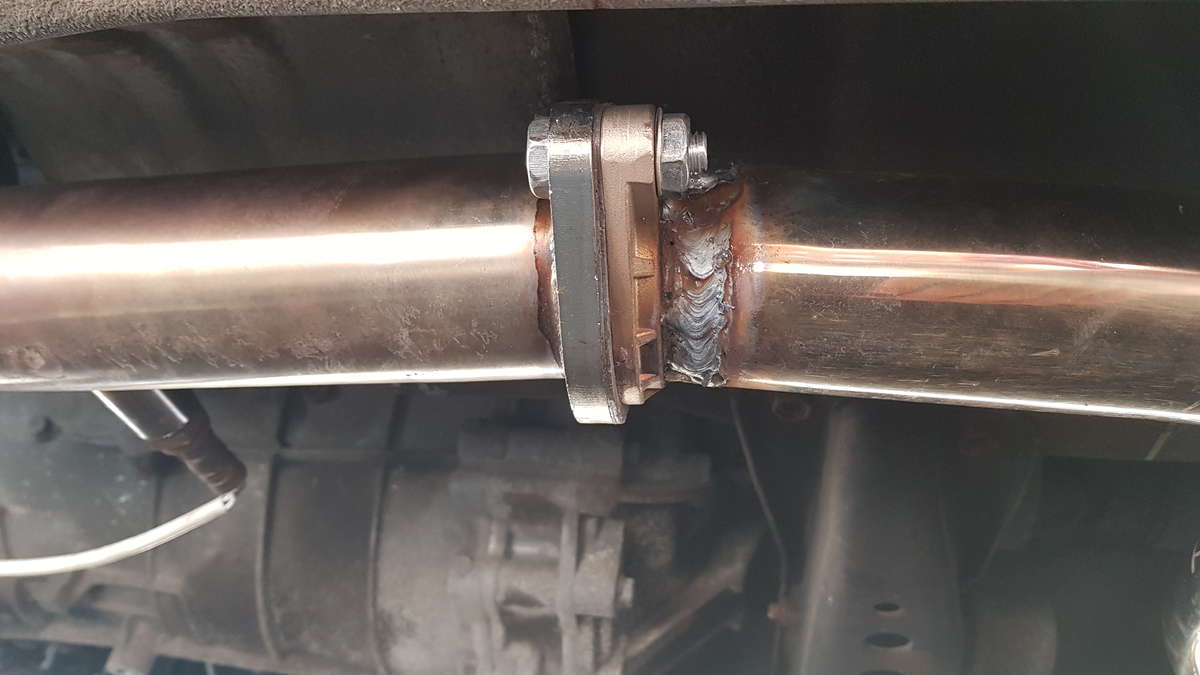

Time for a long overdue update, not all of it good. I've been quiet for a few months now as I was having no end of issues with the Z. The new exhaust didn't cure the engine light as hoped, and at MOT time it became painfully obvious that my current sports cats had failed, with emissions being through the roof. Bugger
So as mentioned above I had purchased a set of Torqen high flow cats
Attempted to fit them and yet another issue reared its head, they wernt compatible with the Injen. The injen was miles out meaning the car was yet again off road.
Talking to Steve, he recommended Owens Garage in Haywards Heath, and Olly to take a look at it. So a trip booked up there and it soon became glaring obvious that there was no hope in hellit was going to fit without welding. Brilliant, brand new exhaust not even a month old and the warrant is voided
I left Olly to do his work while me and Steve met up with Martin for lunch. I'll let the pictures talk
And three hours later the end result was this. Can't recommend Owens Garage enough, great honest guys with no BS. I'll be back for sure
So with that it was back for the MOT, and to see whether it had cured the engine light. I can report that 1200 miles later I am engine light free. Now that it fits I'm happy with the exhaust and cats however the near 2 grand price tag stings, especially as it was far from easy or perfect. You shouldn't have to weld something that costs that amount of money!

Hard to imagine Injen wouldn't be a plug and play affair. IF the new cats were at fault (very possible) you've now made the cat back system ALOT harder to move on, if you ever wished to sell.

Regarding your exhaust.....if it fitted everywhere perfect and just the 2 bolt flange angle was slightly off I'd say it could be faulty weld there, however given it doesn't fit anywhere and is pressed against the underside of the car in a few places I'd say it's not been correctly installed.....maybe some pipes are upside down / wrong way round?? Seems very odd........cutting it up and welding it wouldn't have been my first move!
Surely its vibrating and banging under the car as you drive down the road too?

The issues with fitment happened AFTER the new sports cats were fitted. Prior to them, I had japspeed HFCs fitted and there were no issues at all. It was tight, but didn't touch anywhere. The reason for changing the sports cats was that they had failed
The exhaust was fitted by the head master technician at my work (I work for Honda) who has some 40+ years in the trade and I checked it over with him, he had followed the instructions to the letter. Being a duel system it can only be fitted one way with over and under pipes for the anti roll bar.
Those photos were taken by Olly at Owens Garage after I had fitted the new cats. I had taken the car to them to get them to rehang it all for me to see if anything could be done. He rang to say that basically it was impossible due to the amount of places it was touching, and that the issue was being caused by the angle of the flanges on the HFCs and the injen. In effect, rather then being >| |< it was more of a >\ /< which was lifting the entire exhaust once bolted together. You can see that angle in one of the weld pictures. And yes, the drive up there minus one back box because the system was too tight, was hell. Imagine being In a washing machine filled with stones?

If all the issues where AFTER fitting some nasty no name decat pipes then all the more reason to not start cutting up a perfectly good and expensive exhaust!
Sounds like a change of decats would fix it.........and another spot of welding of course. Best thing would be to fit an oem set of cats and then you’ll know exactly what’s in and out for correct fitment.
