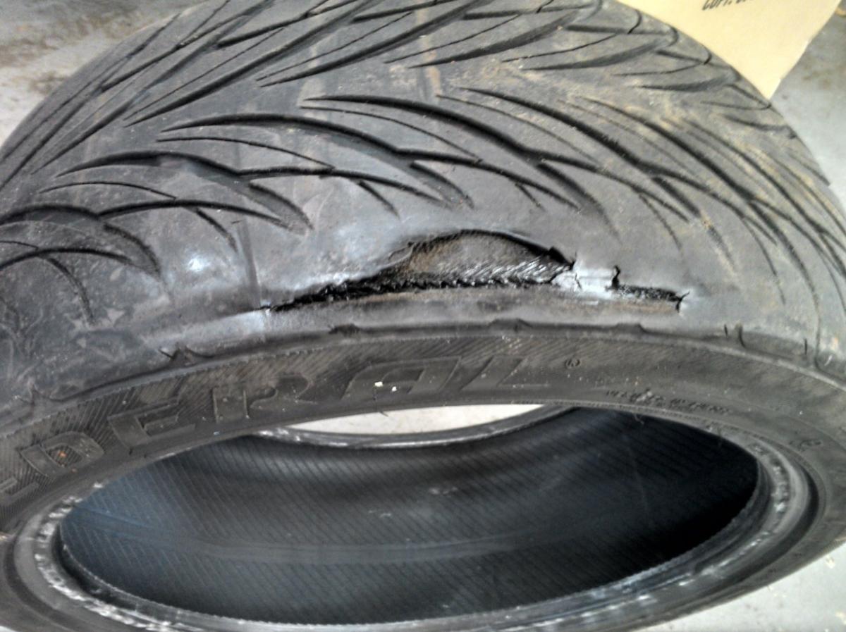

MOT Friday gone.
Had a quick look around the Z.
Wipers, lights and tyres look ok to me.
Anyway all going well untill the Eagle eyed inspector found this.....
I personally think he was being a bit picky. What do you guys think.
Yep it actually was on my car and it drove fine.
I have 2 theorys.
1. Its a cheap tyre and that part was softer than the rest. This happened to my father many years ago on a brand new Datsun Cherry. A tire with plenty of tread developed a flat spot. The dealership had it examined and the results were that that part of the rubber had not been vulcanised.
2. For some time (quite a few months) I have had some brake judder on the front. I was waiting until the service and MOT to get it all sorted together. It was not bothering me that much because by daily comute is 20 miles motorway and a couple of miles back roads. It is possible that the tight spot on the disc was causing most of the braking force to be consentrated on this part of the tyre.
Any knowlegable types please chip in.
Where you can see the braiding split the rubber was around 0.5mm thick. Just perfect for a blowout on my way home. If on the motorway, damaged wheel, crash barriers and lorrys etc. If on the back roads, head on into an inocent family? I dont want to think about that.
If you are going to take the effort to check your tyres dont just take a look at a bit of it and check the pressure.
CHECK THE TYRE.

1. Federals arent cheap tyres.
2. Brake judder is pretty difficult to get out and check, and is hardly unheard of on RWD cars, its usually bushes ......... which an MoT is an ideal opportunity to check.
Id say thats been damaged somehow, if you had the arches touching the tyres over a long period youd see exactly that kind of damage, it might just be bad luck though.

To clarify a few points,
These tyres were fitted a couple of years ago because its all the garage had in stock to fit and I had a nail in a tyre. I now have four Avon tyres.
The brake judder was not serious enough to be of immediate concern, intact it was within MOT limits. The front rotors have now been skimmed.
Yes I tried to make the post slightly amusing but my intention was to get a serious point across which is:- I checked the tyre pressure and wear on inside edge and outer edge what I could see on full lock. I foolishly expected the edge wear to be more or less even around the circumference of the tyre. So I missed this damage on the inside edge which is why I put in big bold letters "CHECK THE TYRE"I think if you read my post again Wendy you will see it is Serious if slightly amusing. How often do you check the full circumference inside and out?

i presume you had a wheel alignment after the new tyres were put on? really bad wear on the inside edge of the tyre while the rest of it looks fine is a surefire sign of the tracking being out.
Even so, it would have had to have been out for a long time to cause that much damage. Consider yourself very lucky that you had your MOT due, that tyre cannot have been more than a few days away from catastrophic, potentially life threatening failure.
I did not get the tracking done as the tyres were evenly worn except this part. If I had pictured more of the tyre you would see that the rest of this edge is ok.
I am now thinking to get the tracking checked anyway.
its really a no brainer to get the tracking checked, as if you put new tyres on a car with bad tracking, it'll just eat through the inside edge again. I've had front tyres that were fine across 90% of the tread, but the inside 10% was almost down to canvas.
most reputable places will check tracking for free, and only charge if an adjustment is actually needed.
