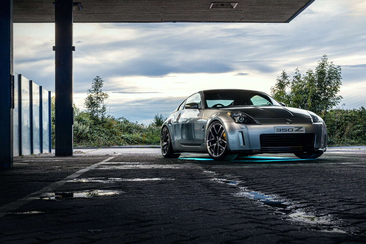

Quite a few members are running Nismo LMGT4 rims.
These fit the 350z really nicely.
Manchester Tyre Services350z still looking fresh after more than 10 years
The design gives a small lip with the spokes coming back out from the lip to aid in a look that's flush with the bodywork.
Also they seem to hold their value well and come resale don't take long to sell on.
They pop up now and again used for about £1200
