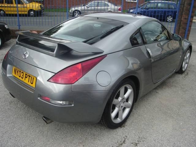

The one we're looking at today is at http://www.richmondcarsales.co.uk - titanium with heeeeyawge spoiler and pop charger. Apparently full service history, leather and the lower tax bracket.

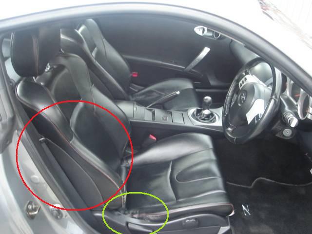

If you look inside the red circle the stitching looks red to me? it may be the camera that makes the colour look off but it should be orange which would suggest the seats have been re-covered? looking in the green circle might also suggest this if that's wrinkled leather?

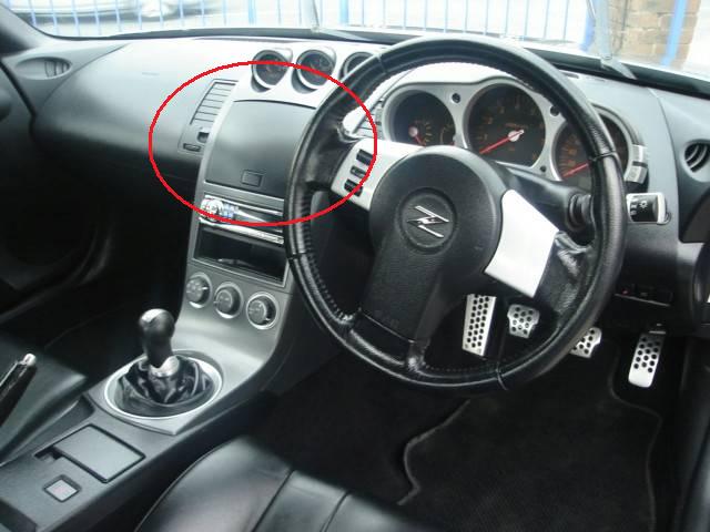

The cubby circled in this picture isnt the original unit, the cubby from this car should be an up and over type opening cubby not a flap type and it should be grey which matches the rest of that section of dash.
thats not a big spoiler :p quite a common one on here :thumbs:

There's no cruise control on the steering wheel, so it's NOT a UK spec GT.
If you look in Husky's 2nd photo, the steering wheel shows the lights operating on the right hand stalk - IMHO it's an import that has been fitted with a UK rear bumper
Husky/Rich - thanks for the advice. I noticed the wrinkle on the leather too but its so difficult to tell in the pics - asking the garage would no doubt illicit some sales burble so I'll investigate for myself.
Good tip on the stitching - I'll check that out. Is there any real implication to the cubby being different? I was assuming it previously held a dud sat nav and had been replaced - deffo a different head unit anyway.
I know its an import (reg 2005 apparently so it sneaks in with the cheaper tax)......assuming that its not got the UK rump due to any bumpercar action but I'll have to check it out.
