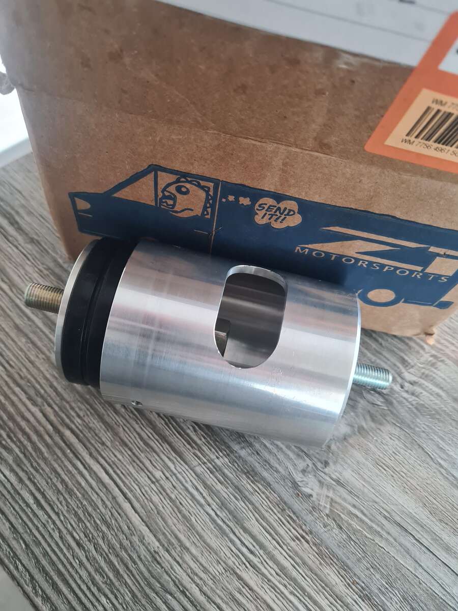

Today's update is the arrival of my new Z1 poly motor mounts - thanks @Umster They're a nice bit of engineering and very very light weight
Plan is to get these fitted along with, replacement diff bushing (probably whiteline polyurethane) and diff bracing after my stock diff bushing has decided its had enough. May also try and get some z1 rear subframe bushing collars to do at the same time if funds allow.
If anyone has and input into this, either best places to get parts or tips for getting the job done (i already know getting the old diff bushing out will be a battle) it would be very helpful.

Avoid Whiteline Poly diff bushing and get yourself a solid bushing instead.
Ok, how come you say that if you don't mind me asking?
I've been looking into this a lot over the last couple of weeks and have seen a handful of examples where people have gone for a solid bushing, regretted it and swapped out for poly bushing.
Another thing I've notice is that the prices for solid diff bushing are outrageous for what they are!
It's a bit of a tricky one to research really as its all very subjective so I appreciate the input.

Diff bushings
I run whiteline and have no issues with them
If your cars still to be enjoyed on the road I'd avoid solid
Best mod by far I've found is the vibratechnics gearbox mount its mega perfect blend of stiffness and comfort

Thanks for the feedback on the Whiteline diff bushing - it seems to be the best solution in my price bracket and will not make the car an annoyance on the road. Gearbox mount is in the plan as I've heard nothing but positives about them

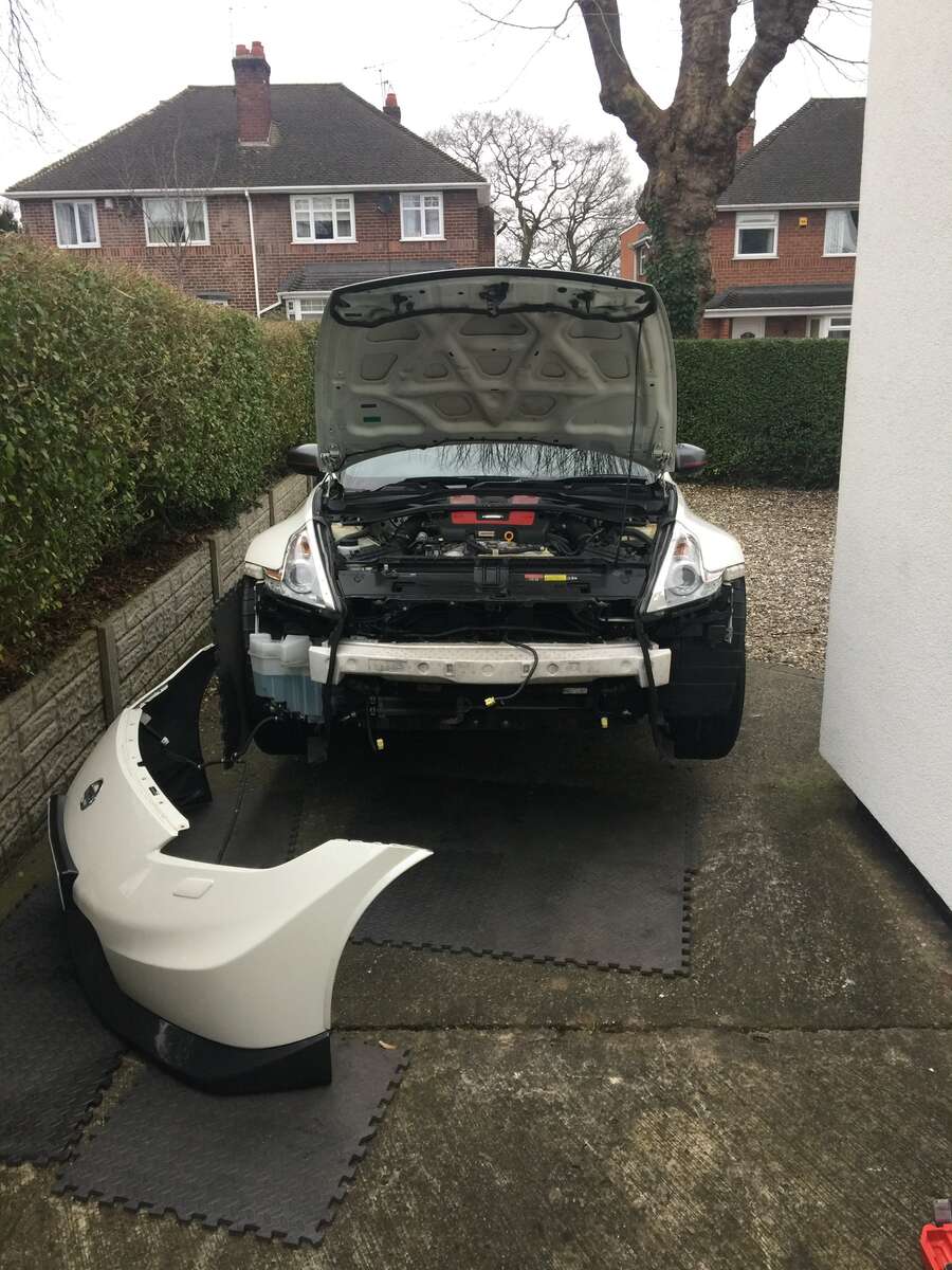

Quick catch up from some of the first things i did to the car after the first track
First was to address the noise or lack thereof from the stock Nismo exhaust, very disappointing. I opted for a Cobra cat back at the cheaper end of the market as it suited my needs at the time. Have to say i was very pleased with it, sounded great - not too droney but still loud enough to suit my taste. I daily drove the car that this point and apart from the loud cold starts I fond it perfectly liveable. The large 5" rolled tipslooked great at the back end of the Nismo as well. Only downside i could say was that despite it being a full stainless steel system the bracket supplied are not and corrode quite badly. Not a big deal but definetely something to consider. Would 100% for someone not looking to spend a small fortune. I also think paired with HFC's it would have been next leavel noisy.
The Cobra was later replaced by an Arc grip i picked up further long the way and paired with some Berk HFCs and the Cobra was sold.

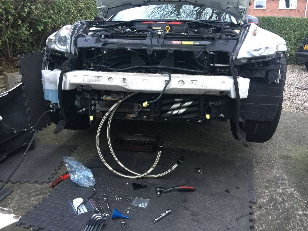

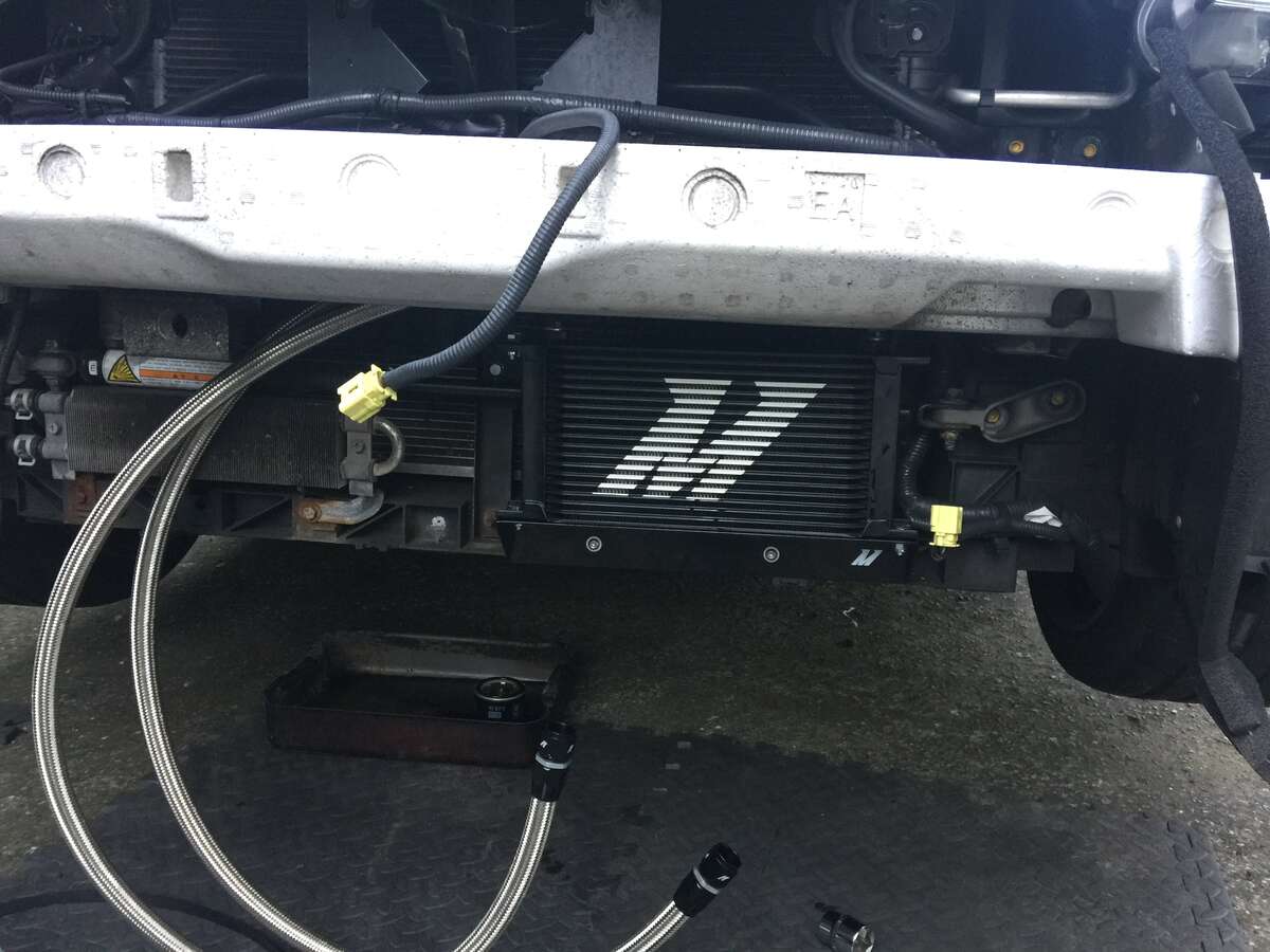

Shortly after the exhaust i also picked up a Mishimoto 19 row oil cooler kit with thermostatic sandwich plate. For track work this is an absolute must. back then I wasn't pushing anywhere near as hard as i do now and the oil temps were still a big issues even on colder days. I can now saftely say that i have tested this to death on track and is more than up to the task. I went from quiet quickly getting the temp upto 130+ degrees in a short 10 minute session, to very rarely getting it over the 110/115 degree mark on a 20 minute session. Temperatures are much more stable.
For anyone interested i run Fuch Titan racepro S oil.
Still being a daily at the time however during the winter the oil temps took too long to reach normal running temps despite the sandwich plate. The sandwich plate is always partially open, even when "closed" to prevent the thermal shock of the cold oil suddenly rushing into the warm engine. This combined with the tiny oil cooler that Nissan added to the later model cars meant i was over cooling slightly.
My solution to to make a couple of stainless steel covers small enough to fit though the bumper opening to block the airflow through the cooler which works and absolute treat. So now i can cover the cooler to reduce its efficiency on cold days and have it open on warmer days and track days. Covers are painted black so you can't even see them.
Cooler looks great paired with the braided stainless steel lines peaking through the bumper. A subtle mod that only people who know about this stuff will notice but will instantly know the car is used to its full capacity B)
IMG_5153.jpg.532bca0bc2dd32b382425b650e40d679.jpgIMG_5151.jpg.de370884ae3c1998a592f4dcac7f9806.jpgIMG_5150.jpg.3f09afe1b4ea269d64b1bf0a41ff8989.jpgIMG_5149.jpg.fda3ba9df566a1c2423fb53dc8d790dd.jpgIMG_5148.jpg.bd2294dcdfee952615ed345be2111fb4.jpgIMG_5124.jpg.afb5e2c2796de3f9a423e8488186b3ee.jpg
