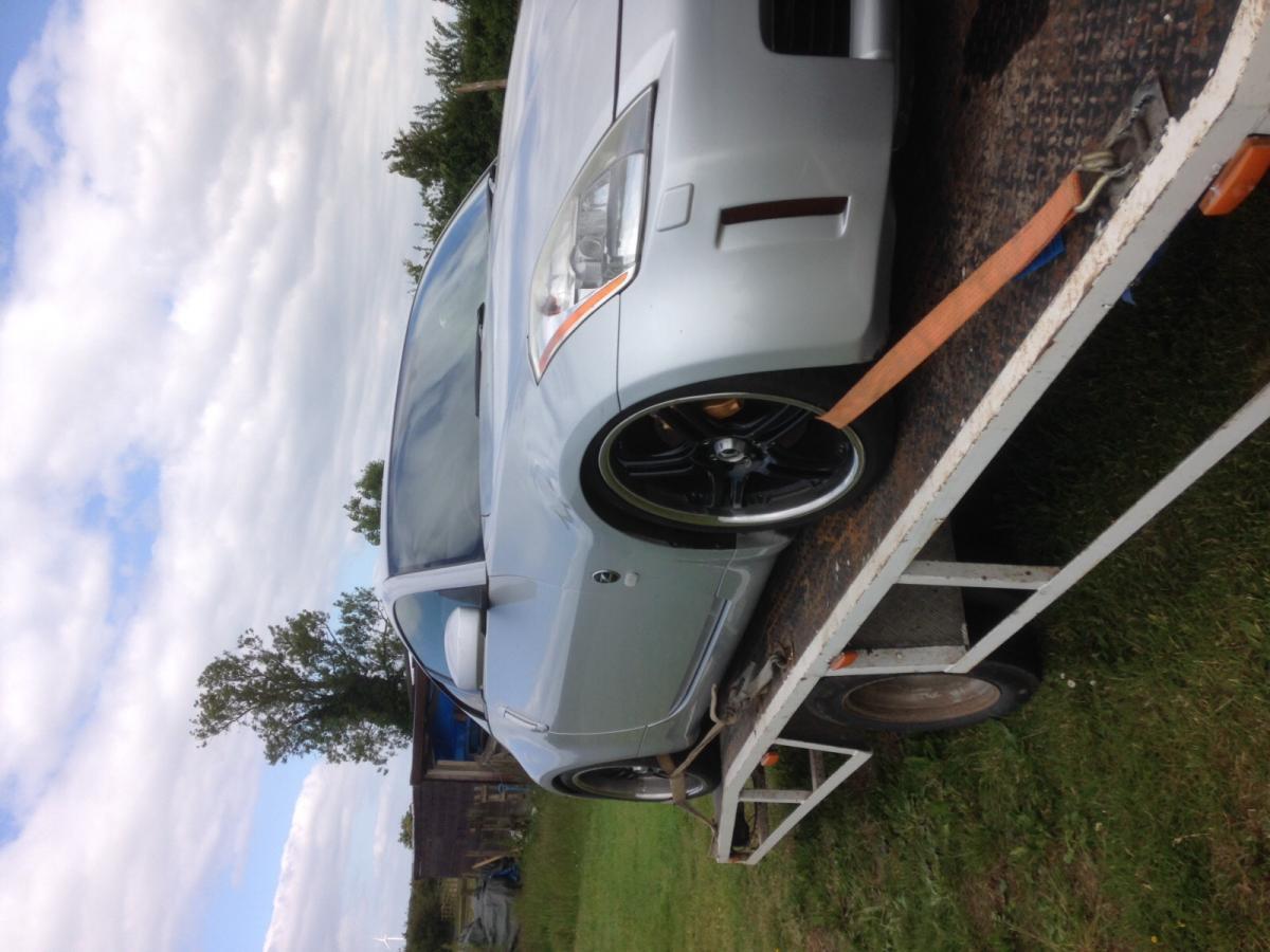

I bought a 350z a few weeks back with a damaged engine.
I bought it totally bind with only a handful of pictures.
I had it picked up with a trailer. The following day I looked at it and confirmed the engine had seized. But i needed to know why so I removed the engine and stripped it down. I found that one of the shells had welded to the crank meaning the engine was behond repair.
