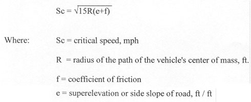

and if you want to find out why this happened may I suggest you pop down to your local library and read a few books on Physics. since you obviously did not pay attention at school.
