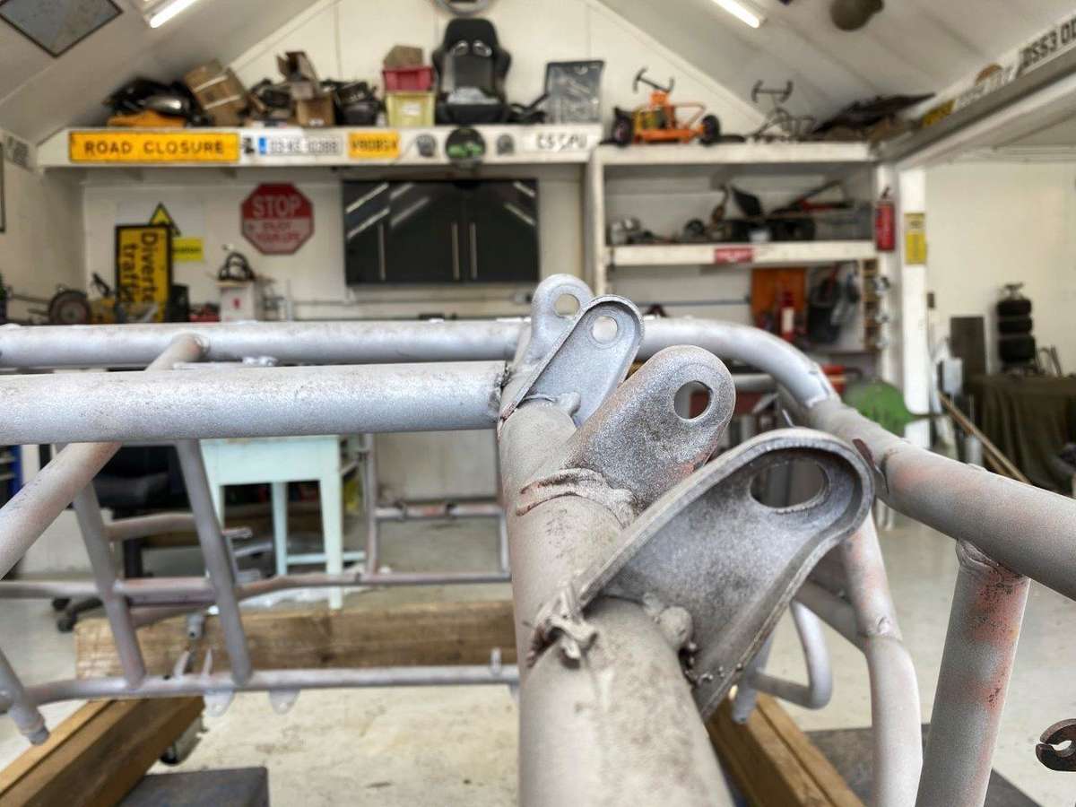

As promised the fitting of my lovely new brackets, (brought to you with hardly any sarcasm) :lol:
So I cut off three of the four brackets as the last one looks OK and a reference point is useful
Now I need to line the little beggars up again and I came up with this – not sure it is up there with a Hunter laser alignment system but given how this thing is thrown together it should be good enough
I used a 10mm bar that I just happen to have laying around
Took a load of measurements, then I used another and created a mirror image
Used the wishbone for the gaps ant spot welded it in place
Took the bar out and welded it all up
Looks fairly straight now :thumbs:

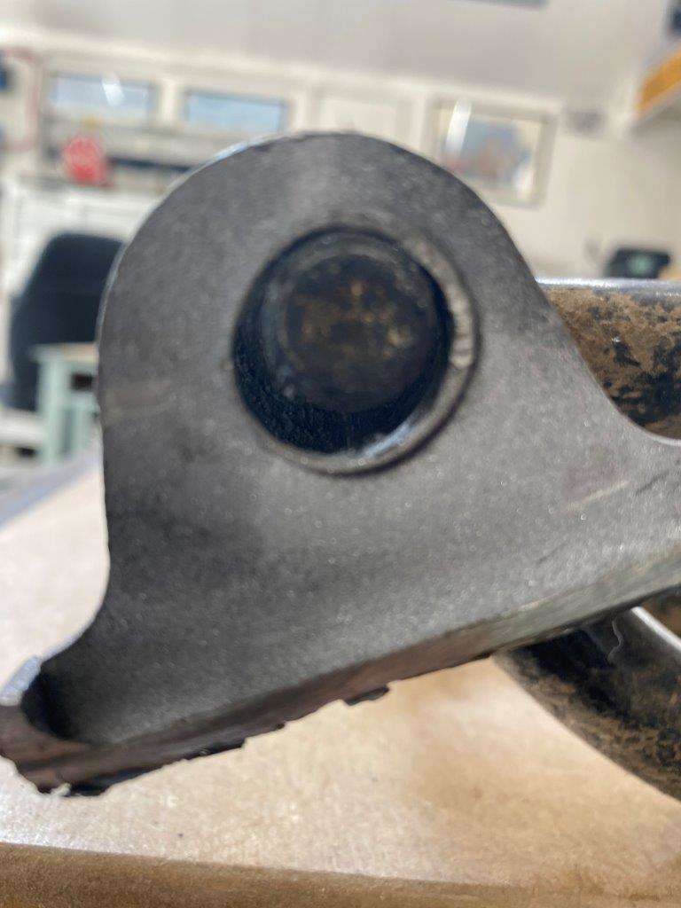

From The MOT fail list –
Suspension arm pin or bush excessively worn Nearside Rear (trailing arm)
Suspension arm pin or bush excessively worn Offside Rear (trailing arm)
The bush is fine, the pin is fine the hole said pin goes through on the other hand is the size of an Easter egg – one of those big overpriced Easter eggs!!!! :lol:
The huge amount of play in the hole is what makes the trailing arm wobble really badly, when you look at the design and see that it is nothing more than a flat bit of 3mm mild steel it’s not really surprising it has worn out. Anyway I used the bar trick to check alignment and also took some measurements, it’s 201mm wide if anyone cares.
 I only had 12mm bar and it is a 14mm pin so :shrug:
You also start to get an idea of the wear here
I considered options, one was to weld a washer on the outside face but that’s only about 1mm thick and would not last long, another was to weld a plate on the outside, an easier option but the bolts don’t have much spare thread on them when done up and I don’t want them coming off!
I decided the best repair was to replace them completely so I  cut out the bad bits -
As seems to be a thing at the moment a bit of old box from the scarp pile has the right, actually slightly thicker, steel sides  with the advantage of a built in “L” shape to make fixing it easier and I should get a stronger weld.
Cut out the bit I want
Drill to 14mm then cut roughly to shape and clean them up with the sander
Then using the bar and a steel rule to get the alignment I spot welded those on
After double checking both alignment and gap to be sure the trailing arm will fit back in I put a proper weld down each side.
Inside
Outside
Fairly simple repair but it looks OEM and should last another few years :thumbs:
This is the old carrier on the bolt, it shows the amount of play they had!

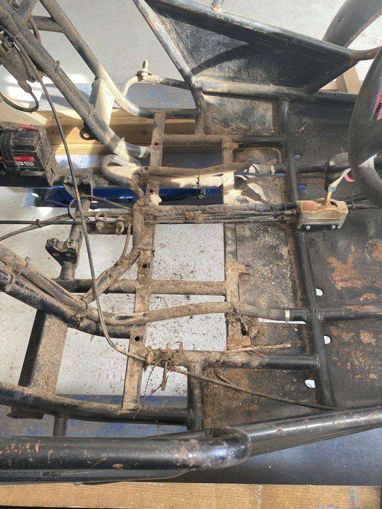

When we first got The Bug and I was underneath it you could tell the previous owner broke it while having some fun in the mud, fair enough that’s what its for, but it looked like this underneath
That’s the bottom of the seats not the skid pan they looked like this underneath
And removed the bottom from The Bug
Now two things struck me about this, firstly, surely it would be sensible to have at least a splash guard under the seat just to keep the crap of and secondly, somewhat more worrying if you happen to go over something sharp and pointy, you know like a stick, when off roading the only thhing protecting your backside is a piece of foam and a thin layer of faux leather – I don’t like that idea!
So it was always planned to extend the undertray/skidpan back to give the driver some protection as well as making the buggy more rugged,
Now I have stripped the buggy completely so the frame looks like this,

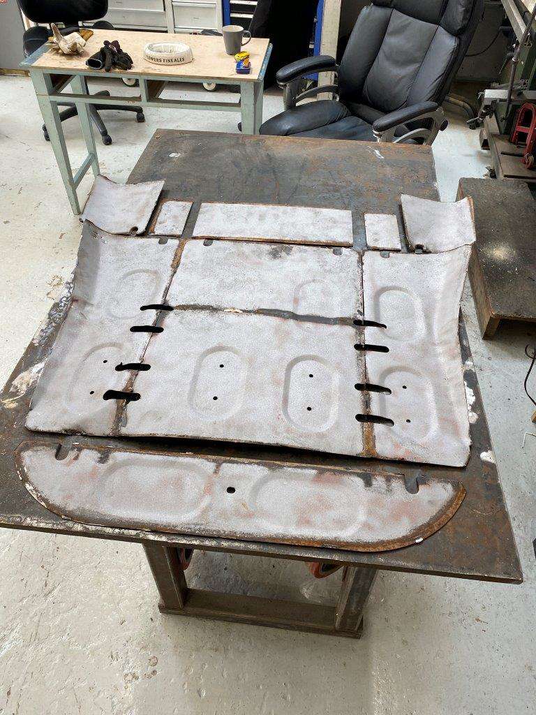

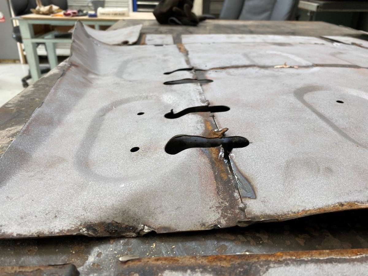

This is the removed skid pan
As you can see it is pretty beat up and made in lots of sections and has gaps in it, so I had to consider the best way to improve on it. In a perfect world the complete under tray would be one big sheet and extend all the way to the back of the cockpit area, this would be a major undertaking though and you would need a large piece of heavy weigh steel I’m not sure I want to go there!

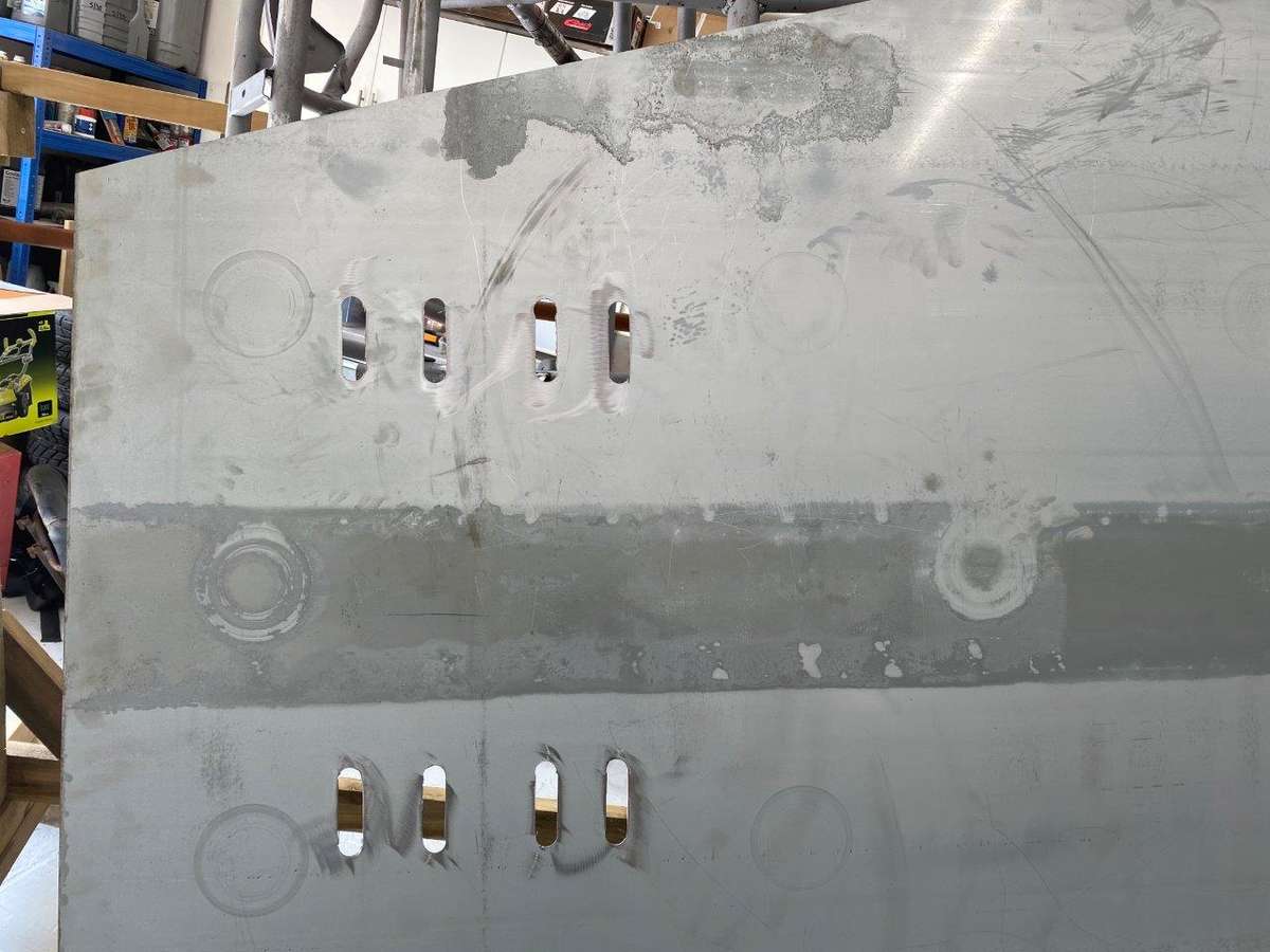

I went to my scrap pile – it always surprises me that no one has ever asked exactly how big my scrap pile is, I call it a scarp pile, its more of a stockpile but I acquired it over time at the best price FREE!! :lol:
You may be surprised just what I can dig out from it when needed ;)
Anyway as I was saying I went to my scrap pile and found this
Yes I’m going there!! It’s the best thing really  :lol:

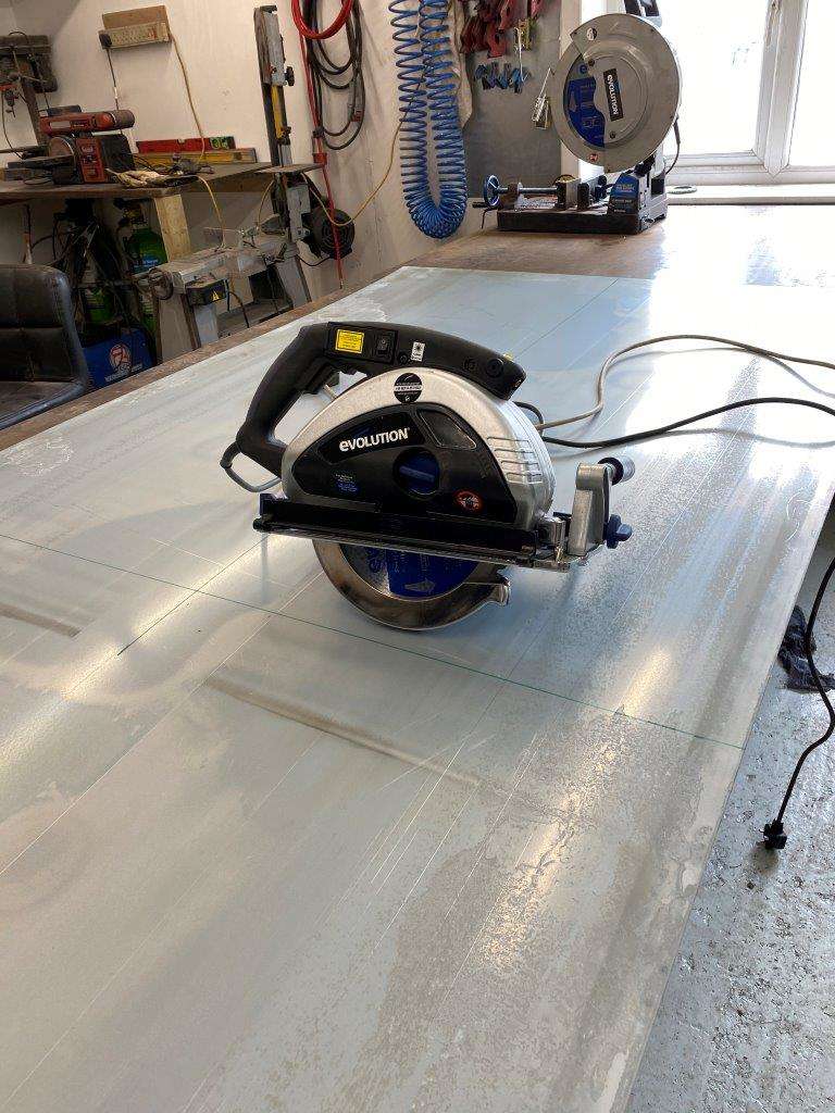

That’s a 1.2M x 3M 3mm thick sheet of zircotec coated mild steel (zircotec is like galvanised but different Goggle it if you need more info) that however is why it isn’t rusty.
After roping Mrs K to get it into the garage I got out another one of my toys to start trimming it down

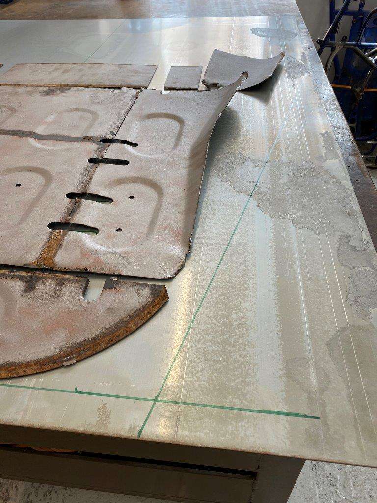

Add a centre line
Get a rough idea of dimensions from the original tray
Now some measurements and marking out
Then I started by drilling some holes
Joined the dots and test fit,

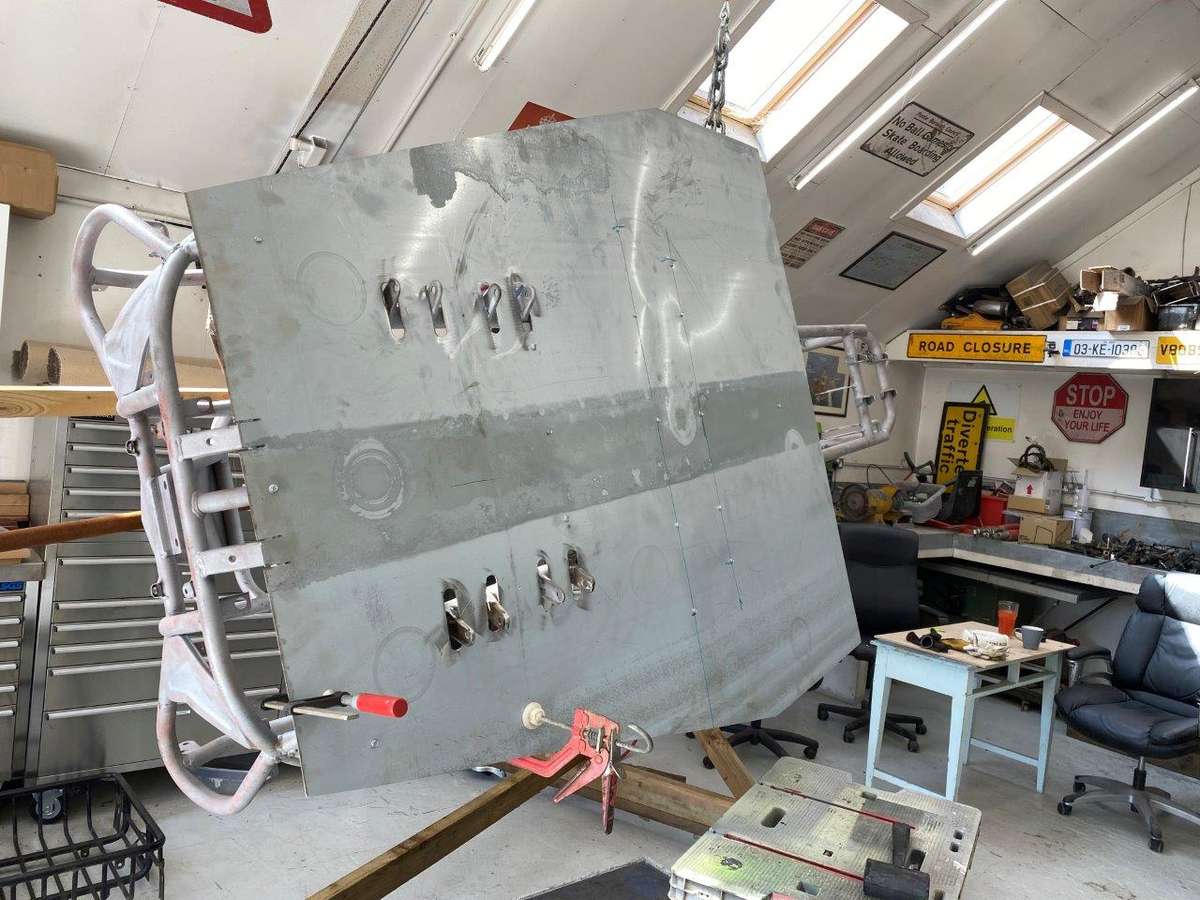

At this point I had to come up with a way to hold it in place for shaping but I need to be able to take it off for both the shaping and for paint later. I used these they are for roofing sheet but with a pre-drilled pilot hole they work fine.
That gets us to here
More coming I said this was big!!!.........................................
Edited by Keyser
  • Like 4

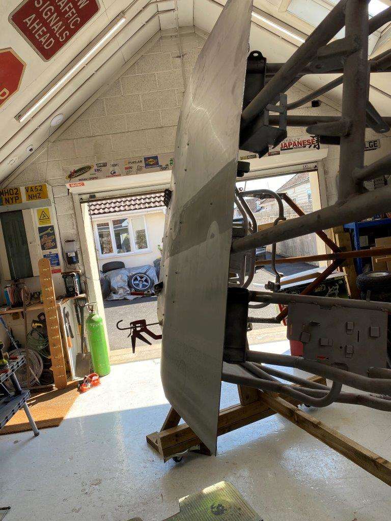

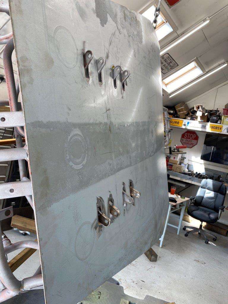

At this point I realised the error of my ways, this is 3mm steel, this is less like panel beating and more like armour plating!! :lol:
I mean how the F**K am I supposed to bend this stuff into a nice uniform snug fitting shape :headhurt:
Pleas note the following is not a lesson in panel beating and should probably not be tried at home, It’s just what happens when I’m left alone with a bit too much time on my hands and decide to try and attempt something that sane people would just not even contemplate.
Ratchet straps!!
Please note I had to upgrade the bolts holding it in place the small ones were snapping under the pressure :lol:
You may also note I had 2 sizes of bolts too long and too short I went with too long :lol:
After a lot of pressure was applied it started to see things my way (judicious use of hammers may have been involved)
I did have to cut some reliefs into each side, only about 6 in total but all that metal has to go somewhere!
Then some fine tuning – I had to roll out the oxy acetylene and apply heat in a few places
Then back to the straps and hammers
The inside is snugging up :thumbs:
Back to the bench
Trim off the excess weld the relif slots up and angle grind smooth
That’s it for now, more on this tomorrow – I’ve done enough typing for one morning :lol:
