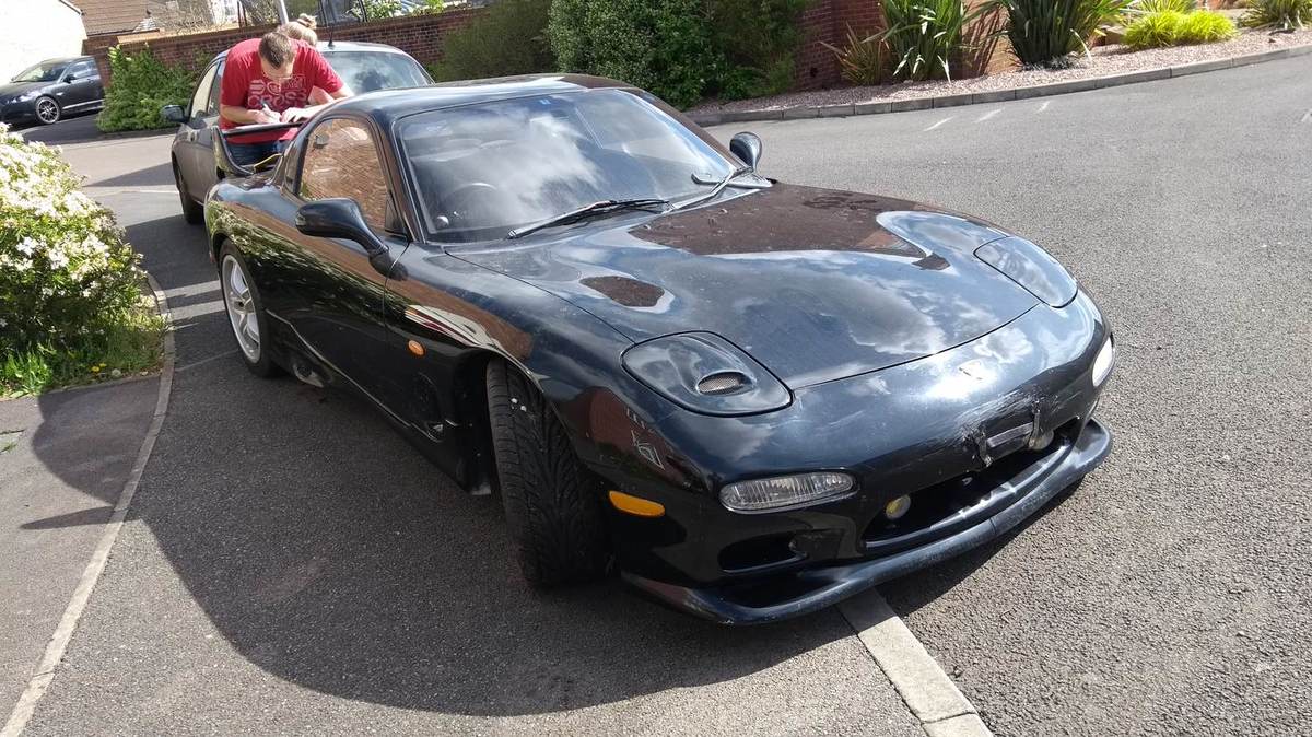

My rx7 fd3s daily *apexi ecu now fitted*
Posted (edited)
After a few years searching for the right one for me ive finally found it :).
Needs a bit of work as it has been sat a few years.
The car came with a few goodies like
gauges , controllers and after market stuff inside.
Ohlins coilovers worth more then what i paid for the car.
Hks pipes,massive bean tin exhaust, racing clutch.
There is only 30k on the clock and apparently was owned by an old lady in japan who used to drift.
Thanks for looking :).

Thanks guys, its still running standard turbos and not sure what ecu yet the guy i brought it from did say it was running over standard power but how much i dont know ,
Just put a new fuel pump on it as that was seized and might drop it at a rotary specialist soon so i can have it checked over properly.
We got no power to the fuel pump either so got alot of fun times ahead trying to get this sorted.
These things fly even with circa 350hp.
Run a new supply buddy, its pretty easy and safer as the original looms are now old and tired and have been known not to be able supply a constant voltage, thus resulting in running lean.

Ecu is in the passenger left footwell behind the plastic kick panel, very easy to access to see what you have.

Thanks jetpilot for the info ,ive just uploaded a pic of the ecu is that any good or still recomend an apexi down the line ?
Did a bit of work on it today fixed a few things like the passenger door , both windows, passenger headlight motor, fitted a couple of little covers that go over the seat belt bolts and took the neons out the boot.
Still needs a clean but that will be last after we've got it started .
Hope i can get it ready for for the drive to japfest lol!

So its a std ecu thats been flashed mapped by Knightsports, it is a good outfit but wont be tunable over here, so yes would still get an Apexi, fully mappable and very well known and cheap too and often come up 2nd hand.

Took the plugs out today i must have flooded the engine when i last tried to start it up cos they were pretty wet , so today ive deflooded the engine and fixed a couple of brackets on the headlight cover as it was only held on by one screw.

So after a new fuel pump and some expensive sparkplugs this thing fired into life after 8 years off the road, to say im happy is an understatement.
Now its started ive booked it in to rx motors tuesday for compression test and a check over.
