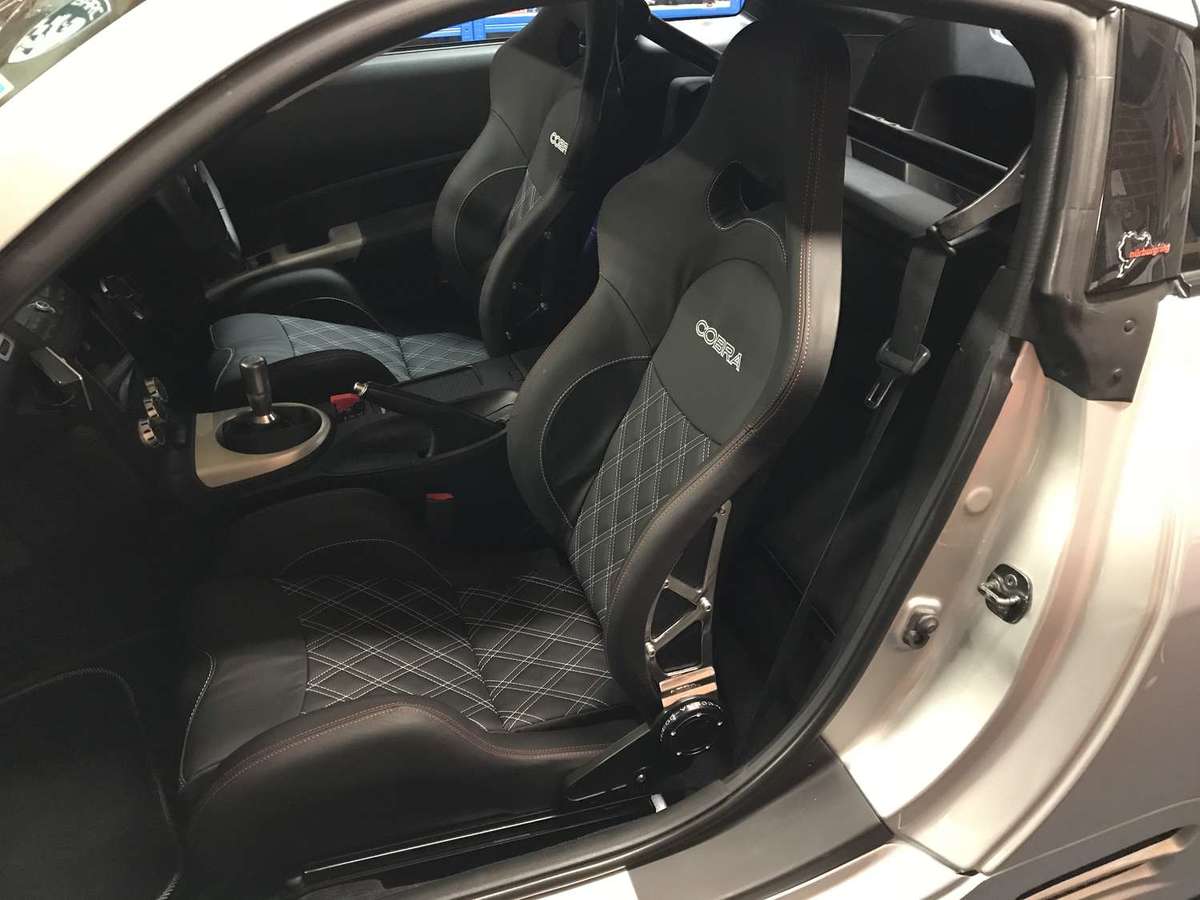

andy james Posted November 12, 2017 Author Posted November 12, 2017 (edited) Worked on the suspension over the weekend. New rear shock replaced the leaking unit. Wondered why the car was shimmying/porpoising under hard exeleration! Nearside front upright lower ball joint swapped out and replaced. Thanks to Bob the Sledge for help with removal and Chris the press with refitting! Lol The Cobra seats were always going to be a challenge as I'd only seen these Chairs fitted in the US on left hand drive cars.I was told initially by GSM that they were too wide at the shoulders to fit into a 350z but after a meeting with the car,Gareth and a tape measure we decided that they could just fit. Passenger seat fully installed, drivers seat in but sits too high at the moment due to the hump in the floor pan but width is not a problem. Buster and me have a cunning plan to modify the seat base. Work in progress pics! Edited November 12, 2017 by andy james 1 Quote
Beb Posted November 14, 2017 Posted November 14, 2017 Those seats look awesome! Keen to see how the drivers side fits after the Bob-mod 1 Quote
Keyser Posted November 14, 2017 Posted November 14, 2017 They look stunning mate - hope the mod goes well on the drivers seat 1 Quote
andy james Posted November 14, 2017 Author Posted November 14, 2017 30 minutes ago, Keyser said: They look stunning mate - hope the mod goes well on the drivers seat Cheers mate. Looked on google at a stripped out Z and think I may be cutting the hump out of the floor pan!! Quote
Keyser Posted November 14, 2017 Posted November 14, 2017 1 hour ago, andy james said: Cheers mate. Looked on google at a stripped out Z and think I may be cutting the hump out of the floor pan!! Cool - can I come and watch that - the destruction of a perfectly good car just for new seats If you need the hole welded up bring her over I can do it or we can let Buster have a go - he loves to weld stuff 1 Quote
andy james Posted November 14, 2017 Author Posted November 14, 2017 52 minutes ago, Keyser said: Cool - can I come and watch that - the destruction of a perfectly good car just for new seats If you need the hole welded up bring her over I can do it or we can let Buster have a go - he loves to weld stuff Thanks Chris. Seen Busters welding. All the weight I’d save with the new seats he’d weld back on! Lol 1 1 Quote

andy james Posted November 25, 2017 Author Posted November 25, 2017 10 hours ago, 350Butcher said: You mention replacing the gearbox mount but I cant see that you listed the one you're getting. Thought I'd recommend this: http://www.vibra-technics.co.uk/nissan/350z/724/NIS234M/transmission_mount_ Developed on my car when I approached them to sort a mount that had all the up sides with none or the downs! I've done quite a bit of driving on it now and it supports the 'box well allowing better shifts on track with no NVH transmitted in to cabin. I went for the Hardrace mount but not driven the car since fitting. Bob and I finally got the Cobra drivers seat sorted today and am very pleased with the results. Road test and photos tomorrow. Quote
