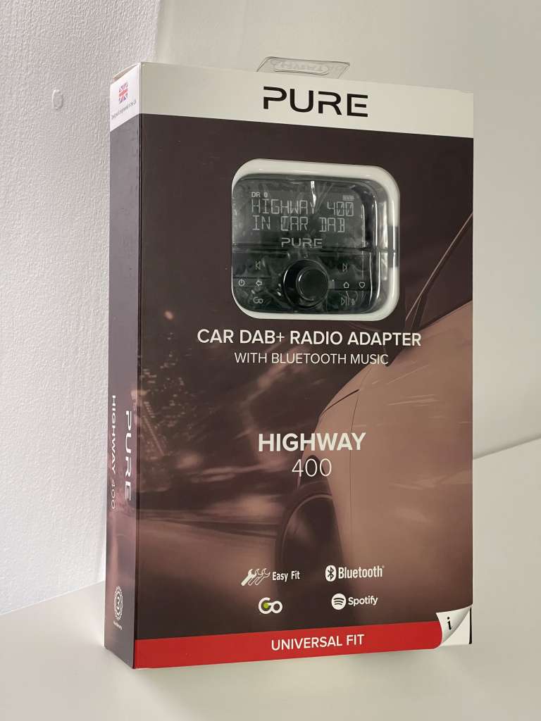

1) Final Infotainment upgrade with a DAB+ Radio adapter, since the 370Z FM radio reception sucks balls 😅
This will be the Pure Highway 400 V2 EU/UK [#151603]
