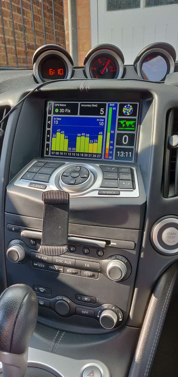

It's easy to install, integrates well with existing Nissan system. All plug and play and hidden away behind the centre console, keeping the OEM look. I had the centre console stripped, the kit fitted and everything put back together again in just over an hour or so.

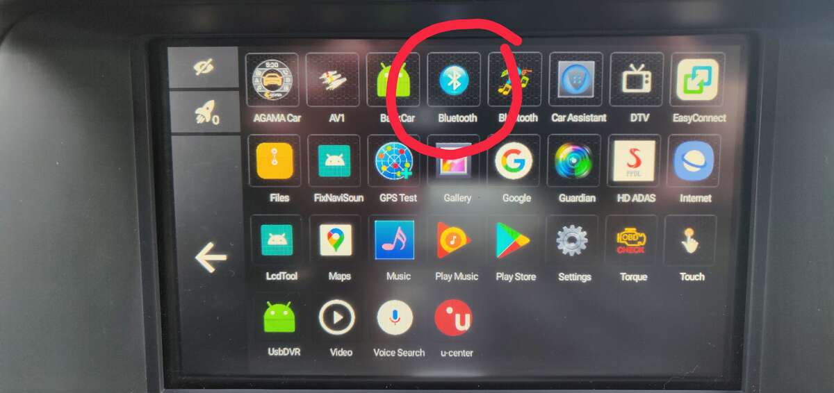

It displays any android app on the premium connect touchscreen - I've got Google Maps, Waze, Play store, Music, Voice Search, Samsung browser and Torque installed on mine. It also accepts audio/video playback via sdcard and usb. As well as the ability to set a password or code to lock it all down.
It's a dual boot system. You can switch between the premium connect and Android systems easily by cycling through the aux button or holding down on a back button for 2 secs.
Steering wheel controls still work. Up & down cycles through music, and vol controls change the volume.
Info button is the home button on android.
Day/night display dimming button works as normal.
Reversing camera works as normal.

The stock launcher is a bit basic for my liking, so I've installed a 3rd party car dash app and set it to be the default home launcher, and I think you might agree it looks much better! (Video below)

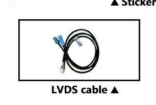

As requested. Pictures of the ports on the unit. Checked with the supplier, all good for more orders.
Edited by StormtrooperZ
Added pics of harnesses/cables.
