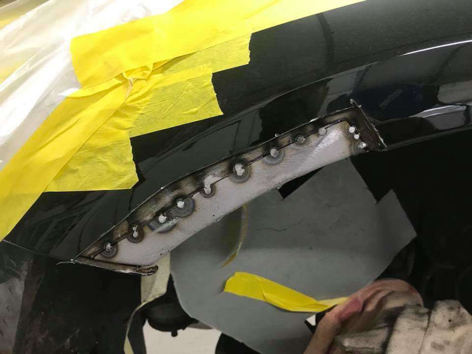

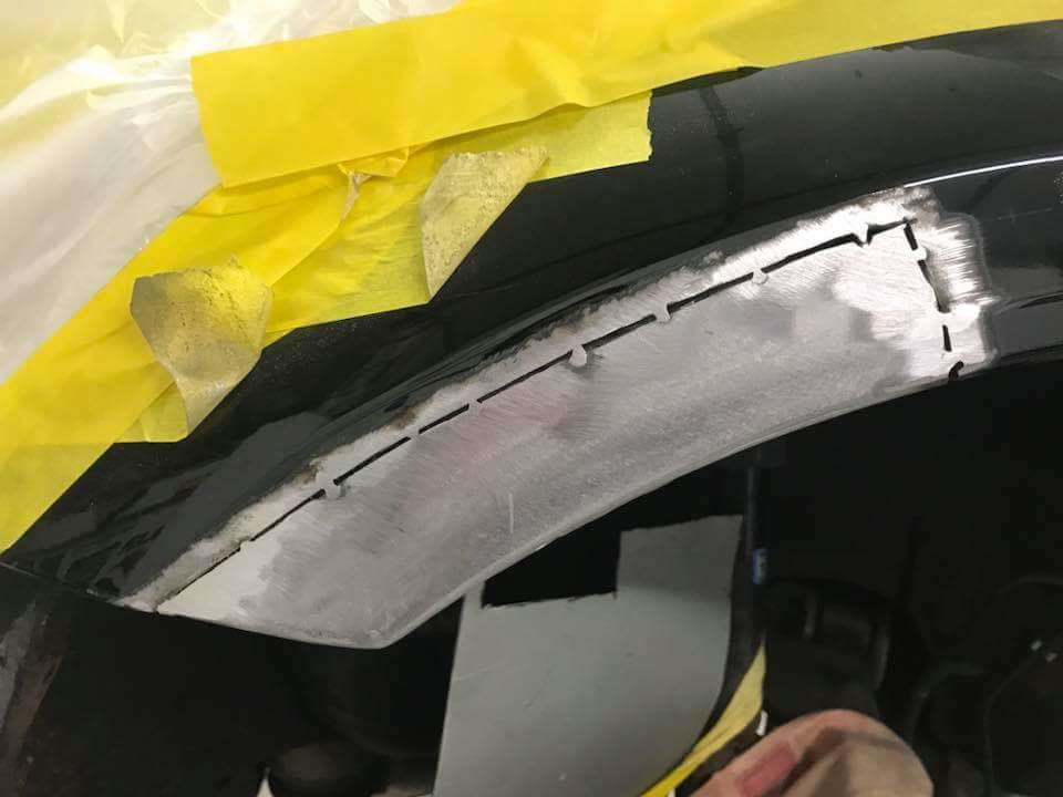

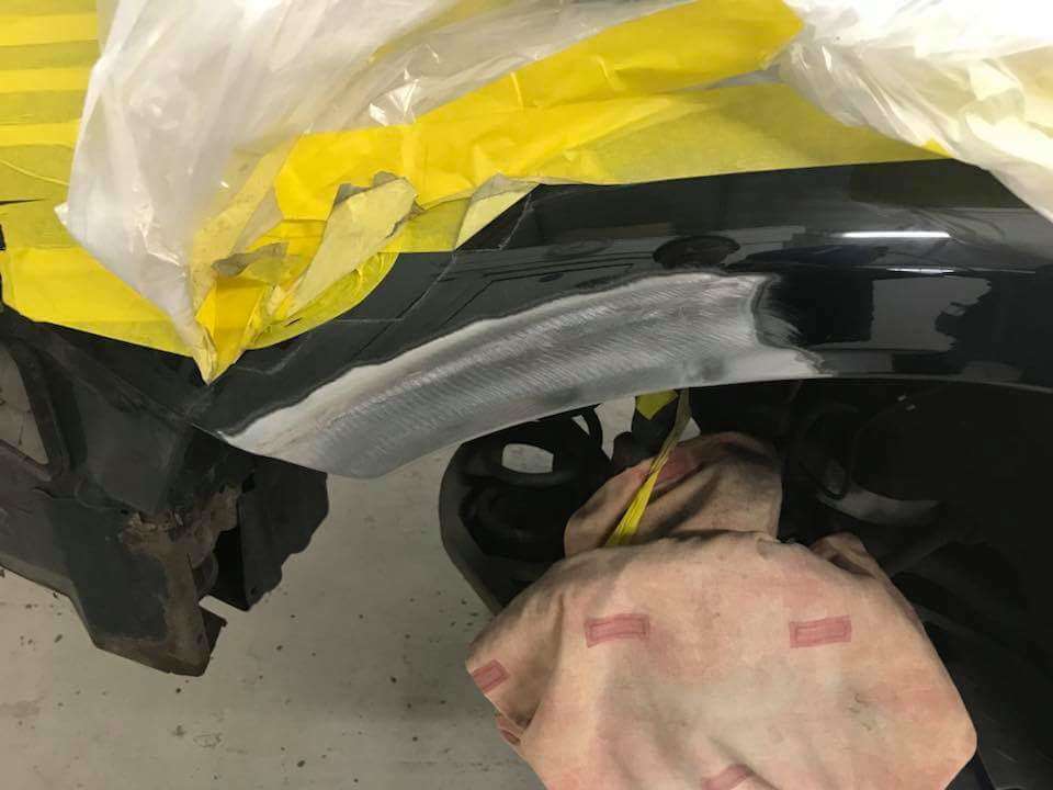

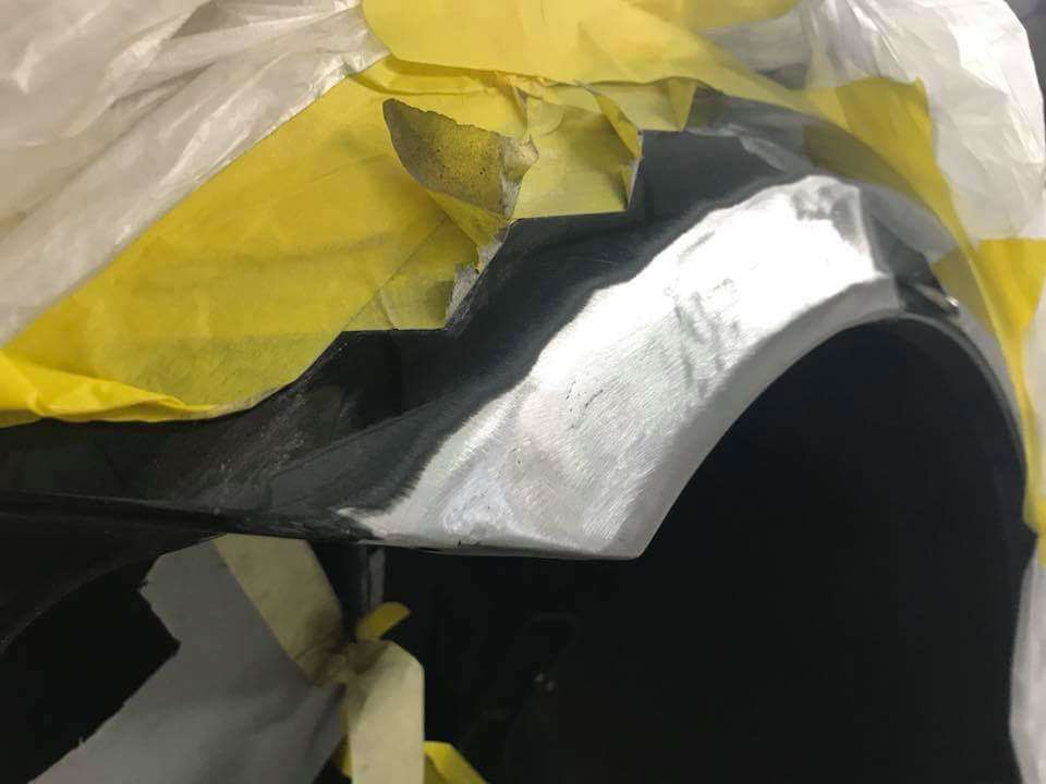

As show season was fast approaching it was time to tackle a few jobs. First up was the issue of rust ! even my zed had developed the dreaded rear arch rash, a problem which is coming more common on the older zeds now. Though only on the drivers side on mine.
Id got myself a body shop lined up and had been on the waiting list for about a year When I got the call that it was all systems go !
The body shop being only a stones throw away from my house I stripped out the boot, took the rear lights out. Then removed the drivers side rear wheel fitting the space saver and drove the short distance to the body shop, where they got the zed up on the ramp.
I then left it there for Drew and his dad to do there magic, keeping me updated along the way.
033C34A8-9760-4530-8310-13EA12B7B20B.jpeg.cf9e00fa02a7b032c2c01b5135eff982.jpegBA4104C4-362C-42A0-BA83-816E5108A757.jpeg.6ce9b95ad50c7dbde115f82a04498b88.jpeg3BF731C3-6EEB-4D19-8C66-72DB4F88B753.jpeg.50022aab223f111be3407f0d9d0ba035.jpeg156F2CD3-0ECF-45C2-B5DE-9AAB927018A3.jpeg.5e8303892fcdd80dc93e4132fd58976a.jpeg69BC722D-713A-4073-B748-BAF4C627F7CD.jpeg.a43b352a6e44260f238de1c2b967a6c4.jpeg822B5285-EB00-49FC-B503-1E122B88781C.jpeg.f40ade3d4a63158f58a08ddfc2839396.jpeg0C58C28F-A051-49F2-9FFD-F84A9AF55ED0.jpeg.e56276110061722196baf0822aa3a27f.jpeg44E8F455-1B15-4069-B127-E7AFAEE6C30E.jpeg.ebe3c74723e2d74f8ccda3bd5fd618da.jpeg6445D2C5-F7EB-4BB4-A709-8B16BBD12009.jpeg.f892f8ee2bbb25fad08d490821f6fd8c.jpeg
I supplied Drew with a rust free arch cut which I’d purchased from an old forum trader the previous year to make it easier due to its position.
Also new bumber bracket was purchased to refit the rear bumper as that had corroded.
Then whilst the rear bumper was off I also had drew spray and install some new reversing sensors with new wiring loom fitted ready for myself to connect up once Id got the zed home, as the old ones had stopped working sometime ago and I’d disconnected them to stop the constant beep when in reverse.
When Drew had finished, his dad then very kindly made injection holes and sprayed dinitrol in both rear qauters  to help to stop any further corrosion,free of charge.
