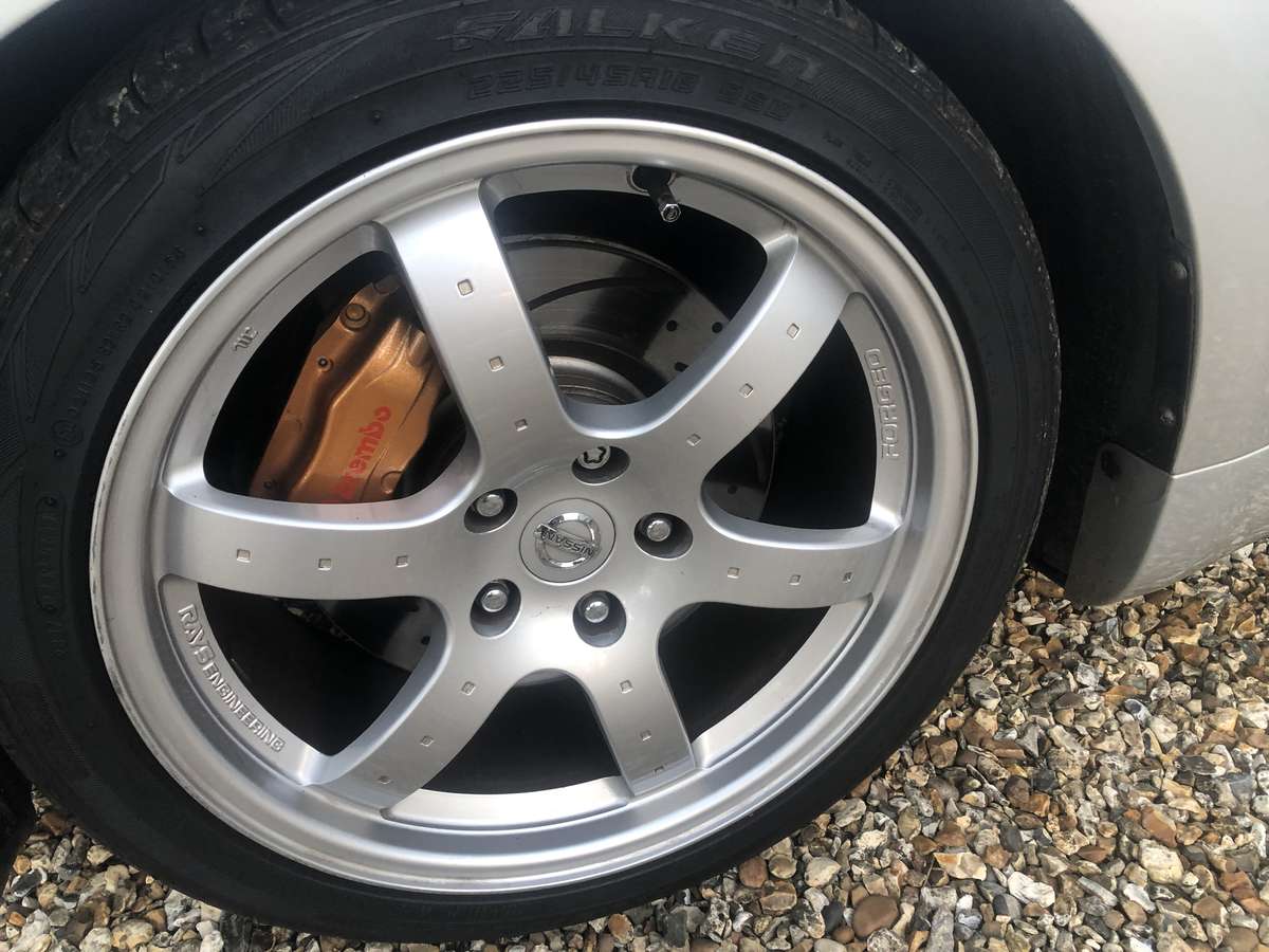

Dan350ZGT Posted April 8, 2020 Posted April 8, 2020 Hi all had my 350z about a year now and love it but the front brake discs are a little warped and are aftermarket (from a former owner) I think it’s time to replace them so wandering what are people’s recommendations? Don’t really want to give up the drilled and groove look though ;) Quote
