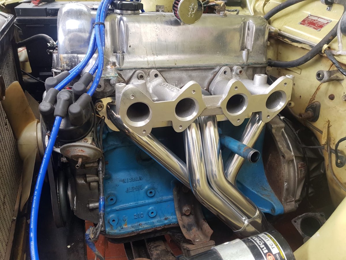

Payco Posted June 11, 2021 Author Posted June 11, 2021 (edited) Progress has been halted for two weeks as the header I was sold and had confirmed would fit a RHD 510 did not fit at all. The steering box is in the same position on a LHD so makes no difference. The header does not clear the steering box idler and after a heated debate the seller - California Datsun gave me £100 towards the £200 custom fabrication welding bill. They will fit a rack and pinion set up but nothing else. Anyway photos of the issue and after a mock up yesterday we are getting the welds finished today so we can start all the work next week. Edited June 11, 2021 by Payco 5 Quote
coldel Posted June 13, 2021 Posted June 13, 2021 Glad you got something it’s not even close to fitting! 1 Quote
Payco Posted June 14, 2021 Author Posted June 14, 2021 Got it lined up today and finally IT FITS… 2 Quote

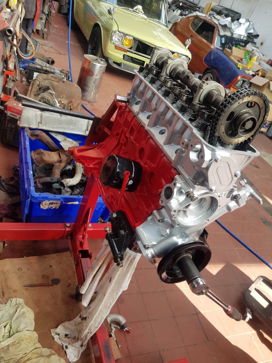

Payco Posted June 30, 2021 Author Posted June 30, 2021 (edited) Some steady progress. Engine out, block painted and prepped.. Edited June 30, 2021 by Payco 4 Quote

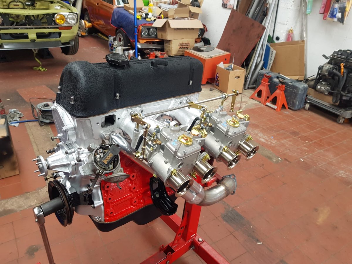

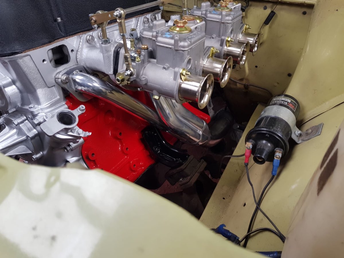

Payco Posted July 6, 2021 Author Posted July 6, 2021 (edited) 40 Weber’s on today Edited July 7, 2021 by Payco 1 Quote

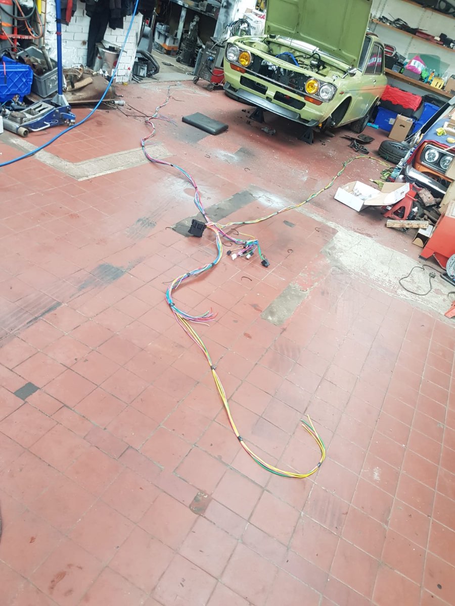

Payco Posted July 10, 2021 Author Posted July 10, 2021 (edited) The rewire started today. Glad I’m not doing it.. Edited July 10, 2021 by Payco 1 Quote

Payco Posted July 14, 2021 Author Posted July 14, 2021 Rewiring a 50 year old car is far from straight forward. Latest below. 2 Quote
