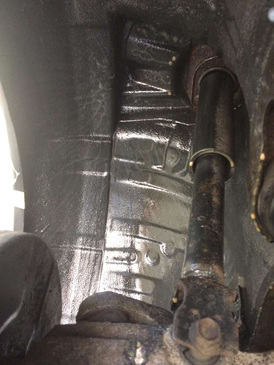

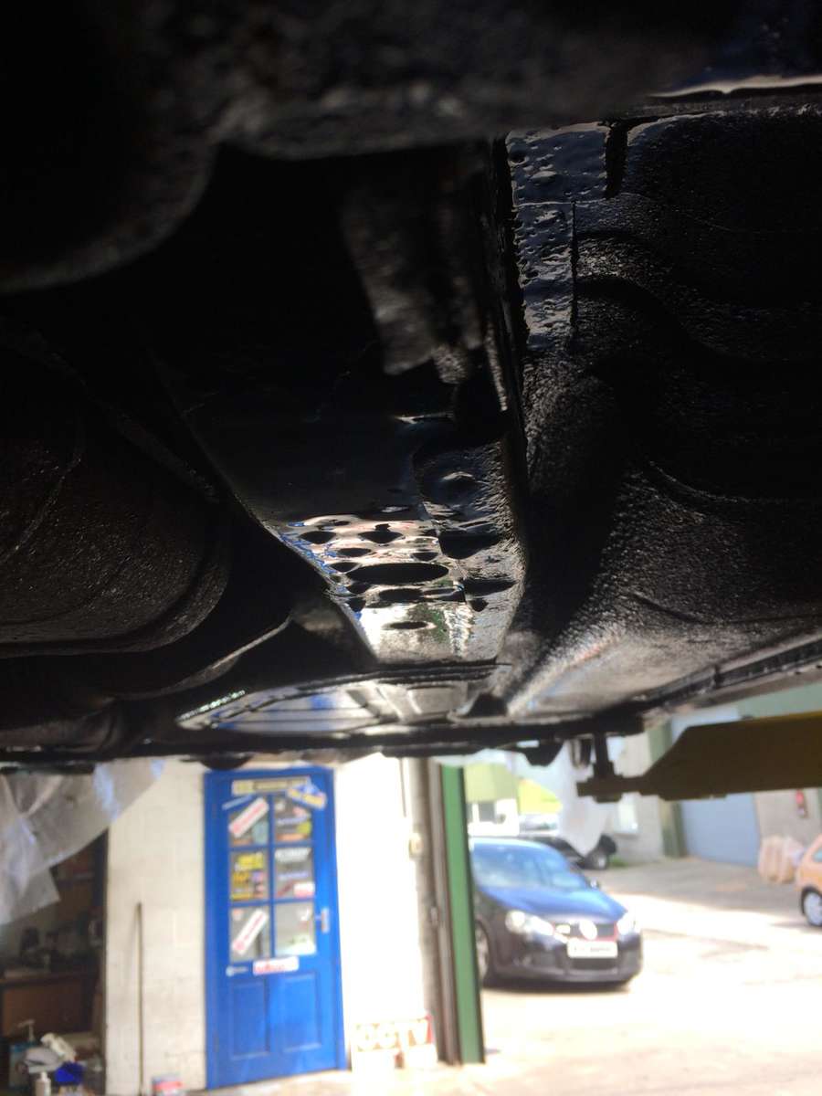

So today I spoke with a guy from Bilt Hamber, my friend who's used several of their products on his MX-5, and the garage who have the ramps and compressor kit and who'll be doing the work, and I've now ordered up 5L of Dynax-UC and 5L of Dynax-UB. I'm planning on doing my lady friend's Hyundai Coupe TSIII at the same time, hence the 10 litres - the general consensus seems to be that it could take about 8L to do both and given that they only come in 5L jerrycans or 750ml aerosols, that was the way to go...
The UC drys clear and supposedly best for the bits you can see like arches and sills, while the UB drys brown is for the main undersides and is even more durable and long-lasting.
Fingers crossed it's a good job, but I do feel confident in the product. It seems to have a good track record of kicking ass in any of the accelerated performance tests people have done against a range of similar products (like Waxoyl etc.).
Now I just need to discuss how thorough a job will be required.
