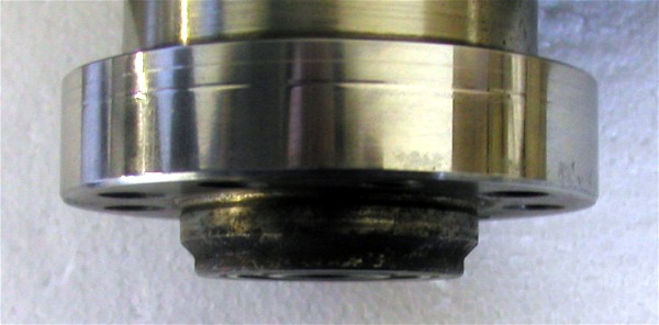

An hour later he rang again, to say the crank was damaged, so down I went again. The end boss of the crank over which the seal fits and against which the seal lip acts had a perfectly concentric groove in the metal all around its diameter right where the rubber (viton) of the seal sits.
Get ready cos his next statement is being entered into the forums "MOST PATHETIC BULLSHIT STATEMENT" competition.
What's caused that I asked ? " the groove's been caused by the rubber lip seal" WHAT! you mean the rubber has cut through hardened steel? " Yes I've seen it before and my mate who works for Vauxhall says it's a common fault"
Is that so I said. So nearly all the Vauxhalls in the world are dropping oil right now because of rubber seals cutting into the steel, is that what your telling me"? Yes he said. F--K off I said, are you for real!
Isn't it more likely that the seals been fitted incorrectly exposing the st st spring located directly behind the lip seal to the crank face. In fact I took the spring off the seal and it matched perfectly the radius of the groove. No he insisted the rubber lip has caused the groove. F--k off I said.
Anyway the the argument carried on into the next day when I told him unless he replaced the crank I would hire a low loader, take it to a main dealer for their report and would get an IAEA engineer as well to produce a report I could use in court.
He rang today still insisting it was the seal that caused the damage but he was going to fit a reconditioned crank but expected a contribution from me. F--k off I told him, this is all down to you otherwise hire yourself a brain dead legal team cos no one with a brain would represent him.

The seals do wear the crank - believe it or not. Most engines will have a groove in the crank where the oil seal goes. Shouldn't leak though.
This was such a precise cut in the crank it could only have been made by the spring and it was the seal he had fitted that he was blaming not the original seal. I would expect the viton to wear considerably faster than hardened steel or cast iron if that's what the cranks made of. If your right and some wear does take place it must be very very marginal and after a couple of hundred thousand miles or so.
In fact I've read how seals are supposed to work. If I understand correctly the viton doesn't even touch the shaft because of capillary action of the oil which causes the lip to lift slightly on a cushion of oil and that's presumably one of the reasons the spring is fitted.
+1on that it's very common you can usually feel it with your finger nail .more of a chance he has scored the seat that the seal fits in to.
You can get a significant grove just from the seal. Heres an example of typical wear. They can often get deeper.
Happens to most cranks - I've got a load like it...

That's a pretty tame groove, I've seen some good ones in my time working on some of the old kit at work. It's amazing how far it can go before it starts passing
Thanks Jez, but I also spoke with an RAC engineer, two main dealer workshop foreman, an IAEA engineer and none thought the lip seal would cut into the crank nor did Vauxhall have any TSB's to suggest there has ever been an issue with oil seals cutting into the crank cause oil leaks.
Anyway he never once suggested the problem was with the original seal only his replacement which had operated for way less miles.
It's difficult to assess the wear in your picture Jez but mine looked like a more precise cut rather than a smooth ridge and several thou deep.
I didn't mention it above but on the second occasion of stripping down to check the leak he didn't replace the leaking oil seal, he just
covered the internal and external faces of the seal with sealant. Why would you do that. He must have noticed the groove and tried to bodge it, otherwise he would have hit me with the problem then. None of it adds up!
Below are two statements taken from an article I read on how seals work.(by the way I meant the groove was around the circumference not the diameter in my rant above).

Just to wrap this one up. After more excuses from him and threats of IAEA reports and court action from me he finally agreed to fit a refurbished crank along with new shells etc. Collected the car this morning and asked to see my original crank and the shells which he showed me. I also asked for a copy of the invoice he received from the replacement crank supplier which he also provided. I rang the company up to confirm what had been supplied and everything appeared to check out ok.
Had a run around and no oil leaks as yet, yipeeeee.
Hope that's the end of it now and feel a bit sorry for the guy as he's a hard worker who I believe had been caught out by his incompetent mechanic. If only he'd been straight with me from the start rather than the bullshit stories he and his son gave to fob me off, things may have been different. Hey ho
