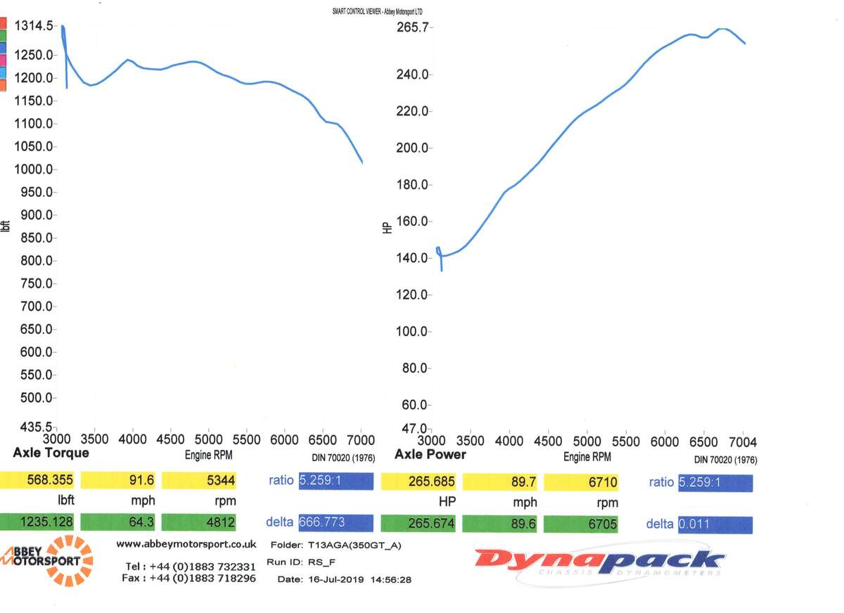

I thought i'd already responded to this on my mobile!? Anyhow, nope no other bottom end replacements apart from the the norm i.e Nippon bearings and pistons oh and Total Seal hi compression rings (i think thats what they were called).
So since July last year I was ademant that I had 305hp at the hubs as that was the figure i remembered Mark saying when I left Abbey and obviously the Dyno was done at the hubs... So when i dug out my Dyno printout earlier I was pretty dissapointed and could only assume that Mark ment 305hp at the flywheel! :bang:  As actual figure at the hubs it seems is 265.6hp And there was me the other day being well chuffed when i stumbbled upon the NA figures on here :lol: I also thought that the grand i spent on the cams was well worth it considering the results... Doh! :lol:  img010.jpg.b0efa9722c38e5b5ddfc4d59d47cc7fc.jpg
Like you mentioned above, probably an extra 5/10hp can be added now that I have installed HFC's and improved air intake (still have the genuine air box installed but with K&N filer and a Mishimoto direct pipe to the thottle body) so at best its around 275hp at the hubs so not too bad for an Auto I guess but still, this means that i have lost 30hp! I have just slapped myself, feel better already :)
C8 Cams: Yes I did review these but several people mentioned that the idle is pretty rough and lumpy and seeing as it's my daily driver I wanted something that behaved well at all rev ranges as a rough idle would have just annoyed me so hence going for the BC's 264's which are basically a little less agressive than the C8's but better than the JW S7's I think.

Ahh - doh!
I reckon you'd see 285hp at the hubs with stainless equal length headers added to the HFCs. If you were manual then 290-295 (based on Sasha Anis' cam shootout and similar breathing mods on a Dynapack)
Considering you are automatic box then your 265 hubs figure is more likely 310-315 at the fly as the auto box loses more through the transmission.

Thanks for that. I won't be installing new headers as it's loud enough for me especially being my daily driver.
Good to know a bit more gain to the fly as it's an Auto.
