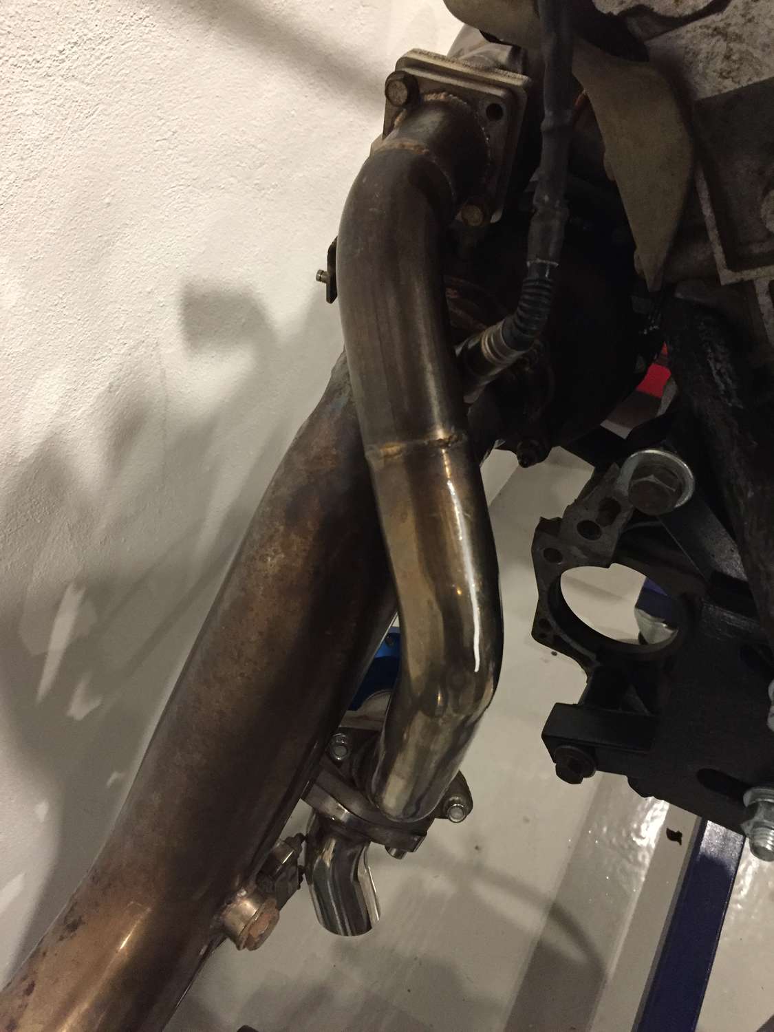

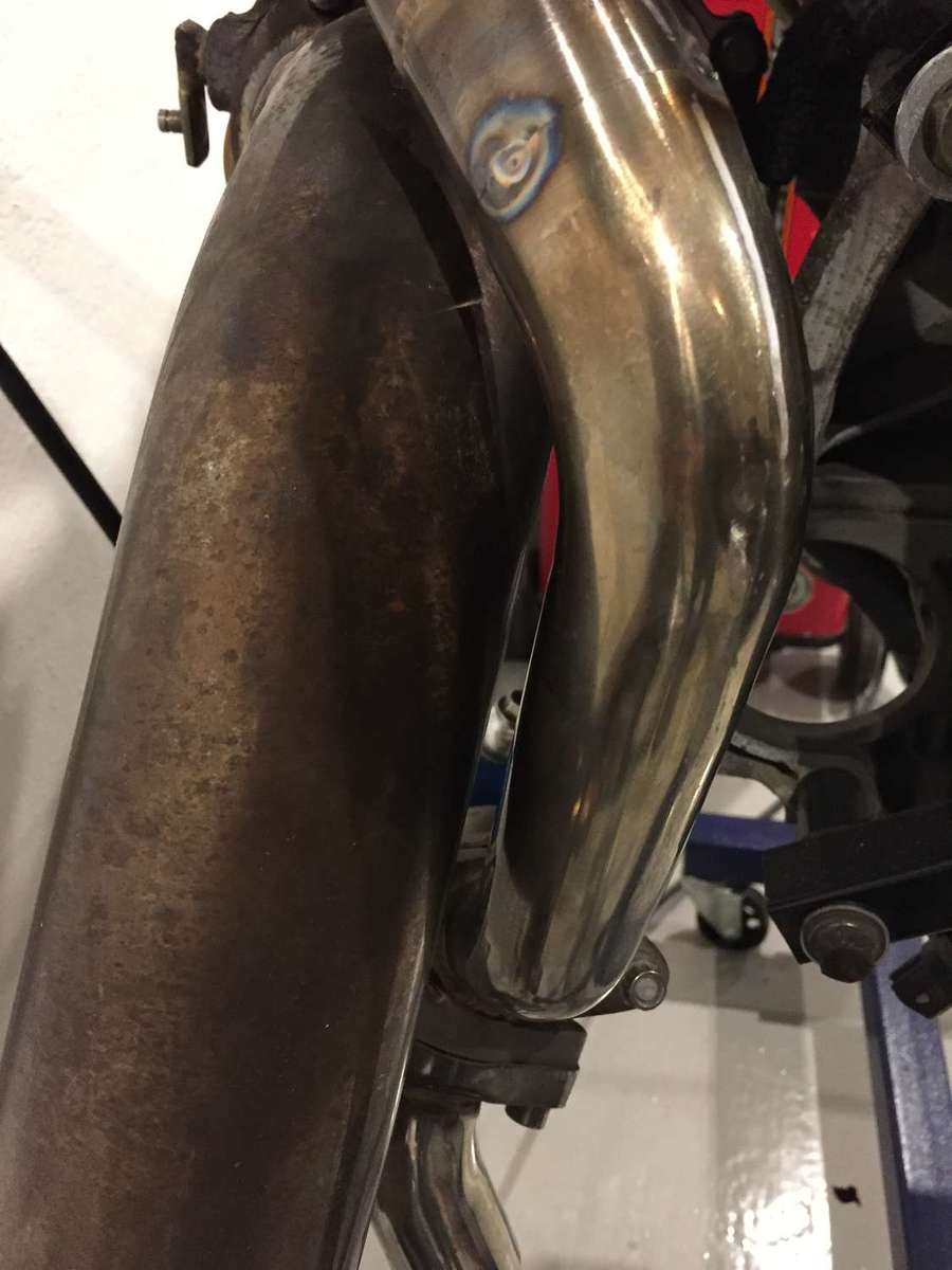

And all stitched up again.
Now i need to patch a few holes in the downpipes and in a intercooler pipe, and then i think i'm ready to start taking the car apart.

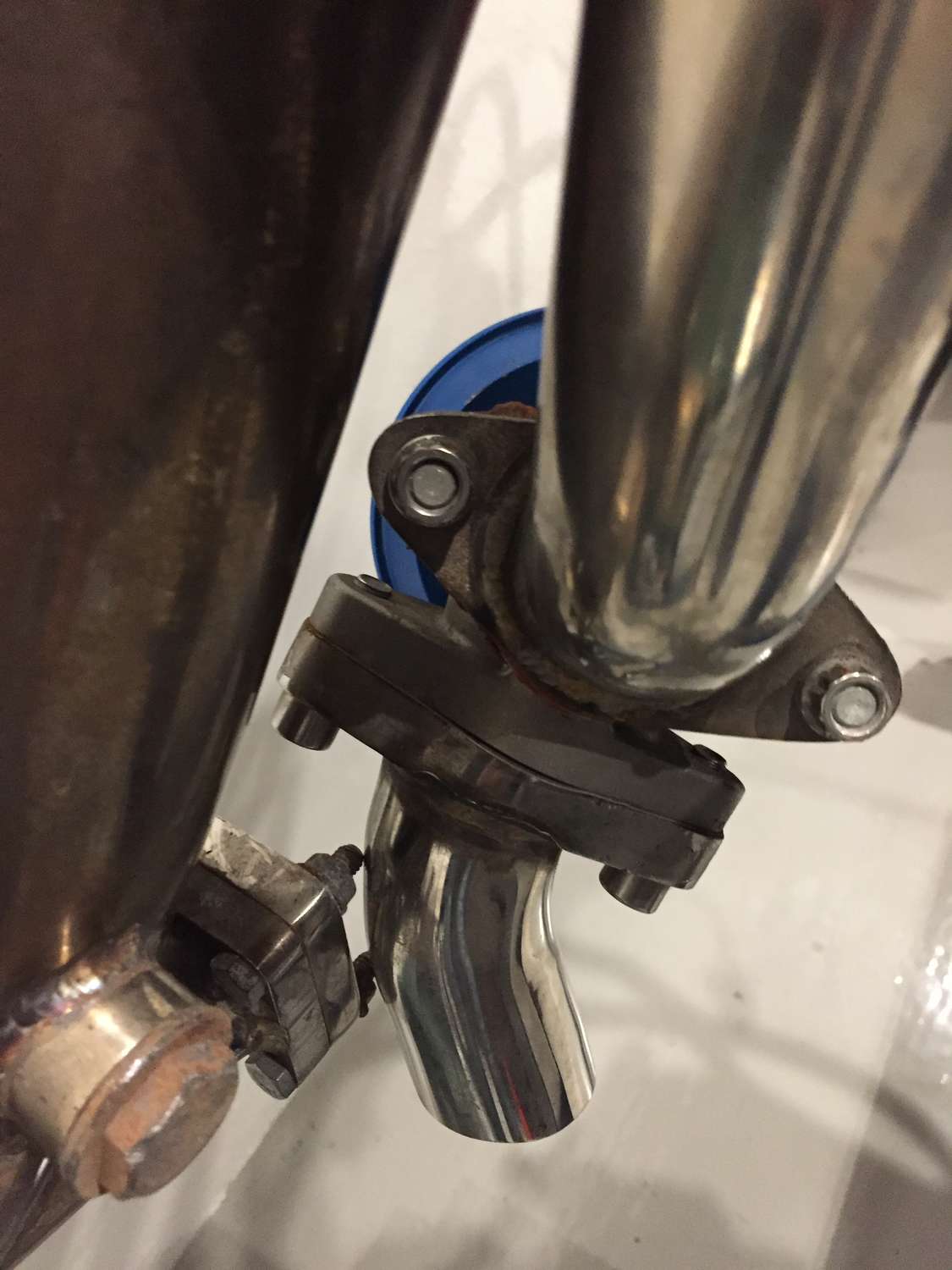

The Gtm steering knucle/coupler comes with an 9/32" thread and no nut to Secure the stud. So redrilled and tapped to a bigger 10mm thread and now fitted with a lock nut. I Think i will have to shave the nut  down to about 3-4mm to clear the downpipe. But better having a little Security than none.

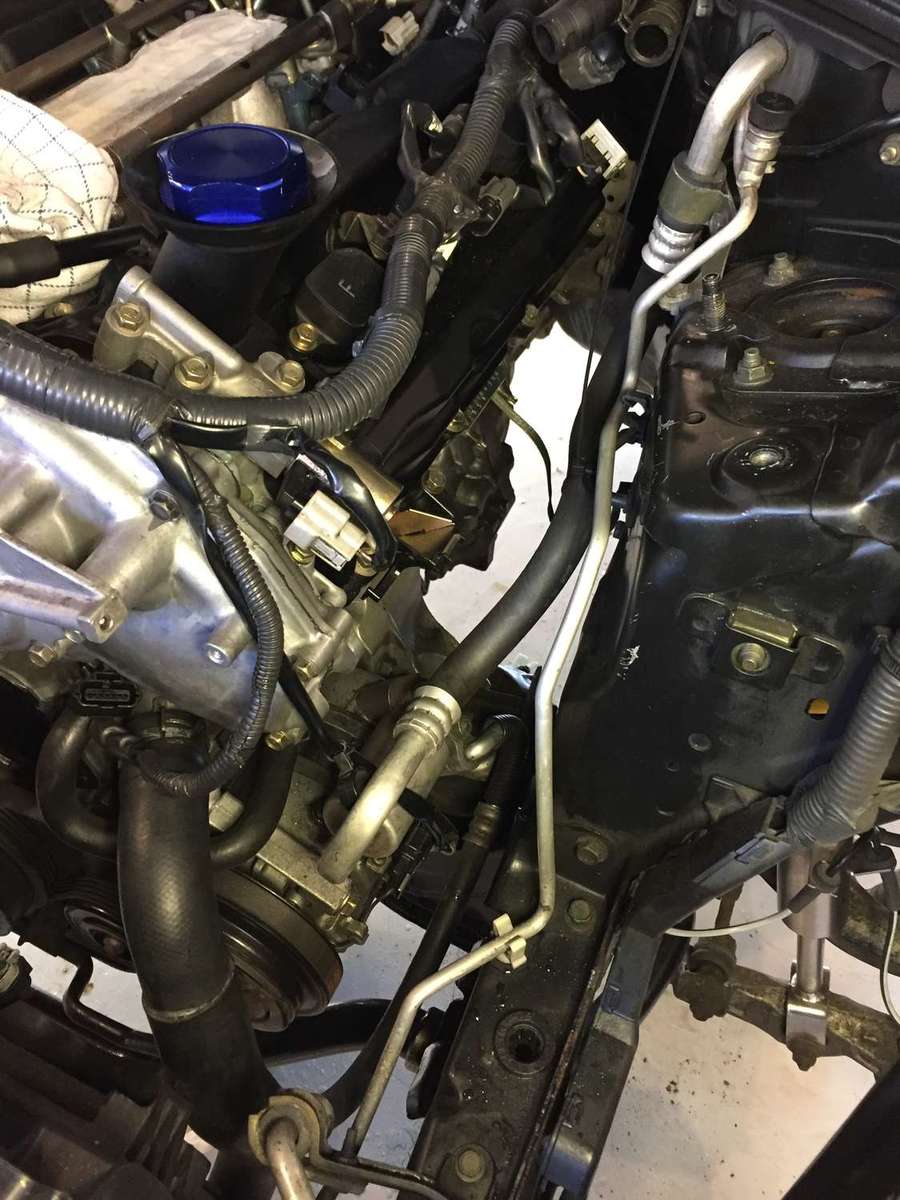

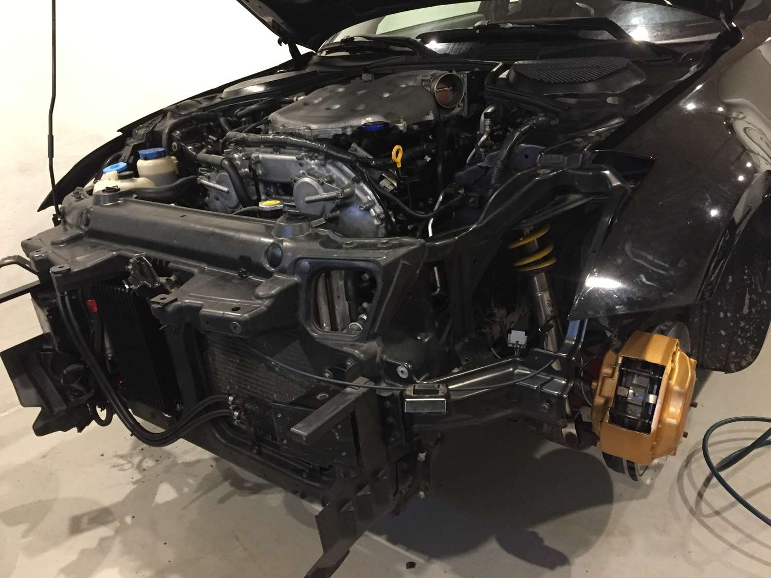

And so it begins.....
everything have to go to make room for piping and so on.
i'll have to make up new washerbottle setup, new coolant bottle and powersteering aswell....
allready done with the Oil cooler and powersteering cooler relocation.
a wise move I think :)
Share this post
Link to post
I Can see that the kits for the 370z almost all come with this revised setup, so i guess it has been an issue. I read about a german doing 100+ mph with his steering going loose on his 350z Gtm tt... so not taking the risk

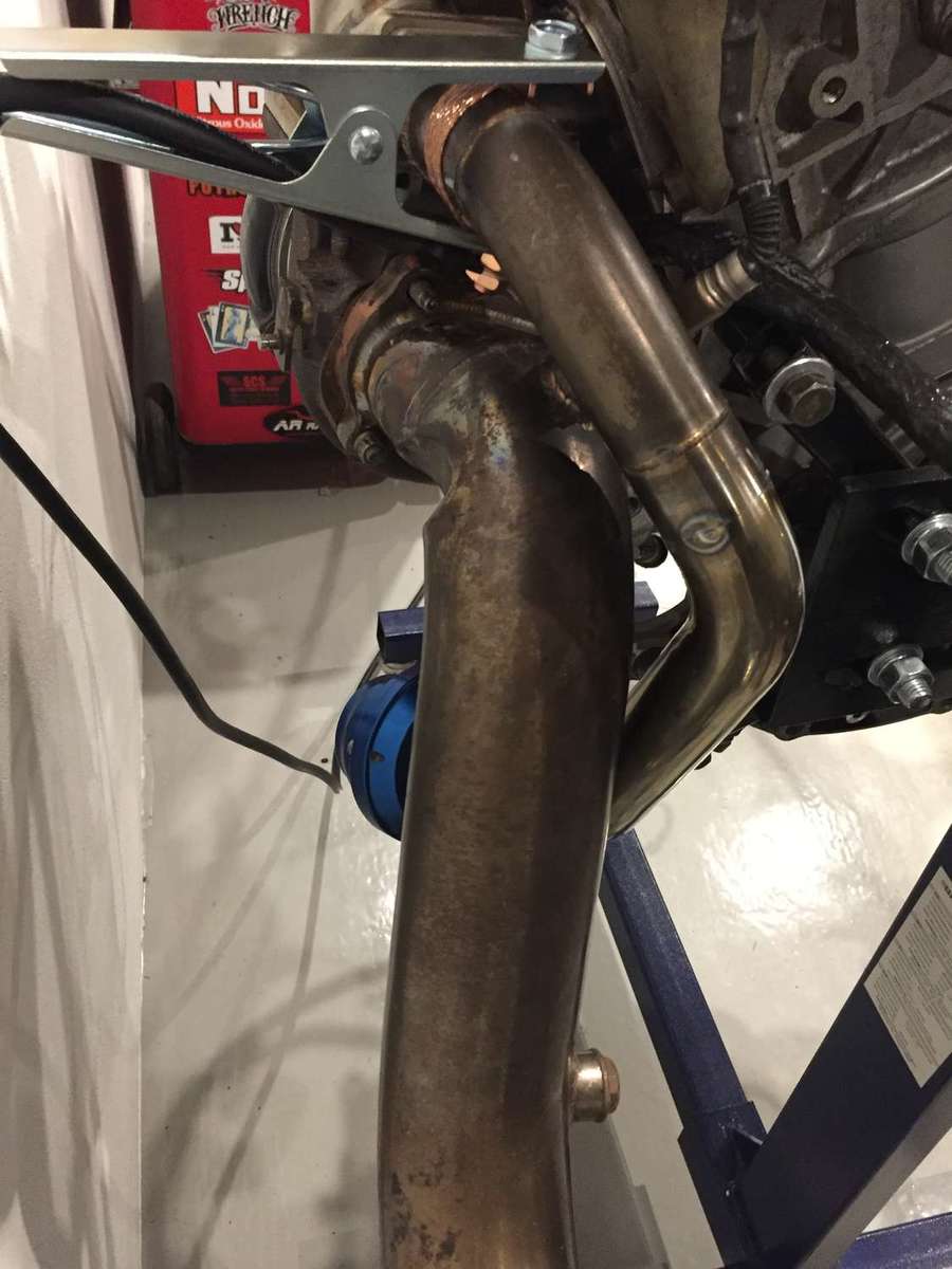

After a few nights of frustration i Would like a moment of silence please....
all you with skin on your knuckles, take a few seconds to cherish it.... Think about the ones who dosen't have any.
and with that beeing Said. The "easy" side of the two exhaust manifolds are off...

Just had another few hours today in the garage... and pulled the left side manifold off. Not to bad when you drop the steering rack...
anyways. Now i have to come up with a Way of fitting the new manifolds, the gt3076's, wastegates and everything else in the space about the size of a small dog...

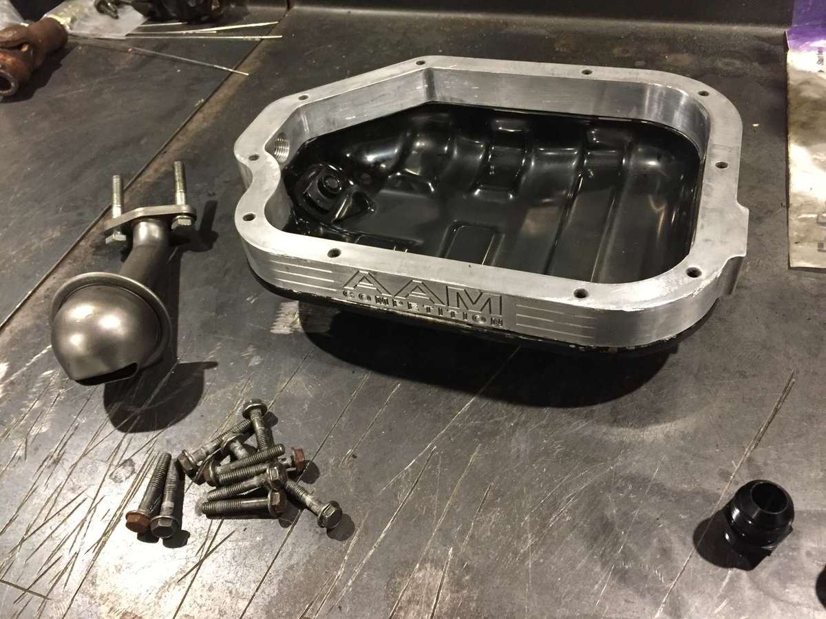

Tonight i'm pulling the Oil pan and getting ready to install the AAM competition oil pan spacer with proline AN fittings for the Oil return.
This way i don't have to punch holes in the block for oil return. And i get an ekstra liter of oil capasity.

And pan off and cleaned....
you gotta love to clean and reseal with fipg when having a vq!
now i need to fit the longer Oil Pick up and the "new" Oil pan.
Share this post
Link to post
And i Can see that my "longer" Oil Pick up, is just as long as the Stock one...
So i'll have to machine a spacer.
and just refreshed the Oil pan with a little tlc from the rattlecan...
thats it for tonight...

I'm at real risk of asking a stupid question here, but I'll go with it. Isn't the pickup the same length because there's going to be more oil in there, so the surface will remain at the same height?
That's a good question...
i have no idea really.
but i can see that the bolts provided with the "longer" pickup are 25mm longer than the the Stock ones, so they would need a 25mm spacer to work.
and maybe the oil can slush more with the added spacer when going sideways, braking etc.
I'll look into it today, but i don't think there is any harm done in getting the pickup lower, but i do see your point...
