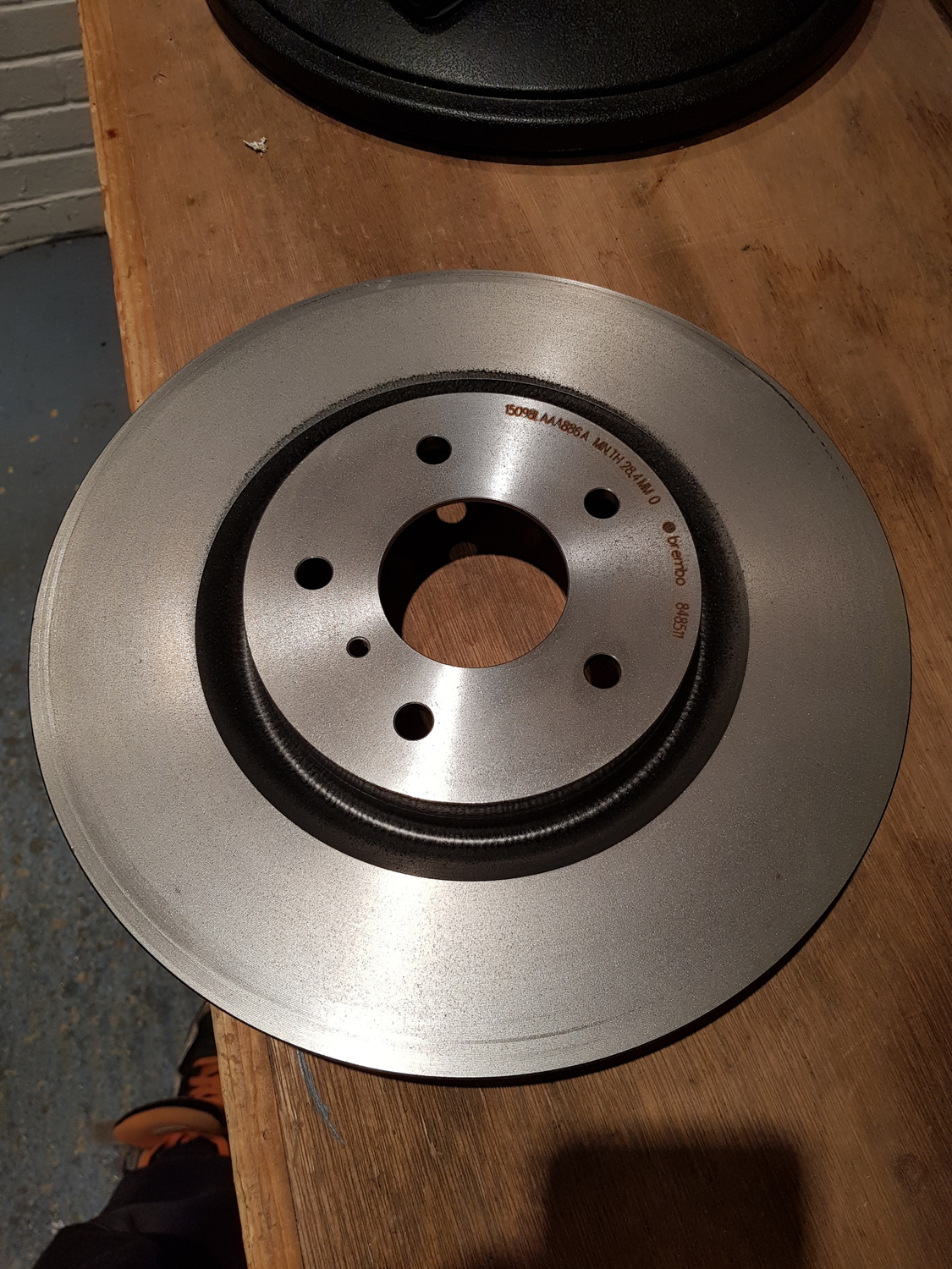

So I decided to go with standard brembos in the end which I ordered off eBay and received today. Not sure if I'm just being paranoid but they seem a little off to me.. The disc faces aren't particularly smooth, have marks on, and it's almost like the whole disc has been sprayed with a silver rattle can or something because there's what looks like overspray on the non contact bits that are supposed to be black.
Ive only had a few years working as a mechanic but I can safely say I've never seen any new discs look like that, anyone else got any thoughts??
Again im not a mechanic but they look really off. Seen new discs go onto a fair few cars while ive been waiting for my parents when i was younger and ive never seen them with that sort of dusty silver look to them. Unless maybe its a protective coating for transport?
I've fitted loads of discs and they've always have a clean, smooth finish on the contact surface. Like I said I'm pretty sure they've been sprayed silver  (God knows why) that's what's given them that finish and that's why there's silver flakes in the black bits. Seems very dodgy to me and hopefully eBay will agree and make the seller pay postage so I can return them!
Serves me right I guess, should've gone with euro car parts that were only slightly more expensive rather than a seller I'd never heard of.
Do you think they've been refaced then sprayed to look new? We sometimes get them in with that sparkly finish, but its more uniform. Only other thing to suggest is to get a micrometer and measure the thickness, new discs should be 30mm thick
