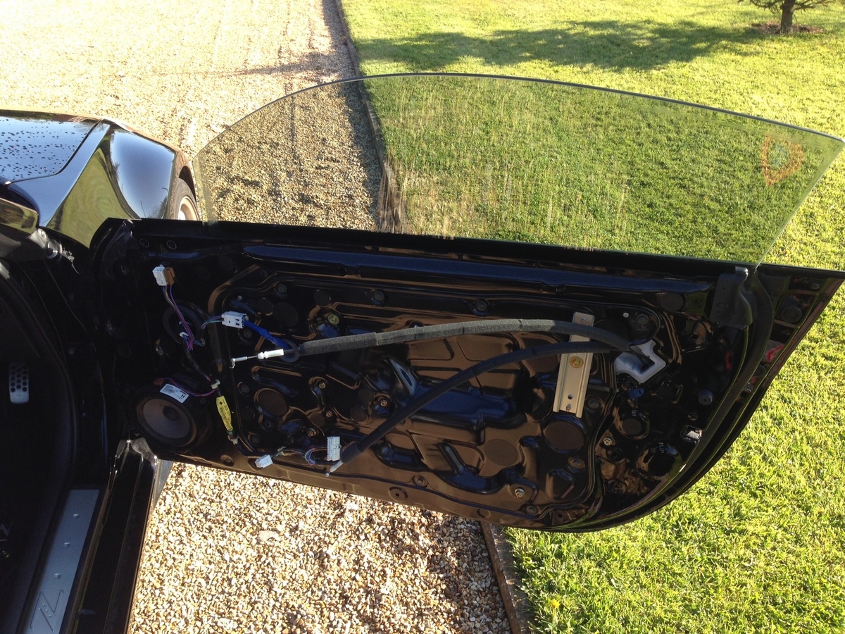

SHEZZA Posted May 4, 2015 Author Posted May 4, 2015 (edited) Been meaning to do this for awhile and since it was such nice morning thought I'd have a crack at. For awhile now my drivers side window has been closing too high and eventually split the rubber seal on the wing mirror bracket triangle causing an annoying whistling noise whilst driving and since Wales is coming up I wanted to fix this as I do a bit of in car fliming and it interfears with the sound. Replacement bought last year ! Door card stripped off as per guides found on here, tweeter triangle removed, wing mirror removed only held on with three nuts and wiring plugged in. Then triangle removed held in with two bolts and a nut, I found when removing this being carful twisting it around it pulled straight up and out more easy. Old split wing mirror bracket triangle All put back together and window reset carried out and jobs a good un. Not so much of a guide just a little wright up on my time with the zed as we grow old together and cracks start to appear ! Haha Edited August 12, 2017 by SHEZZA Quote
