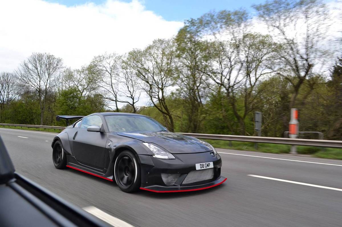

evilscorp Posted September 7, 2017 Author Posted September 7, 2017 I think I used to post here.... might need to start keeping this up to date. After many moons and conversations with Torqen, my lovely wheels turned up today They look so much better in the flesh than the photo's. Just have to wait a few more weeks to use them..... I might have forgotten I had made the front's to fit Ksport BBK but I never got round to buying them and they dont fit over the oem brembo's lol. Waiting to hear back from some ksport dealers as I have tried the 356mm template and it fits but I want to see if 380mm disc's fit before I order a set. The brembo's won't go to waste as they are an easy swap on the 200sx. Half the car has been stripped for my second attempt at painting and I intend to do a red lip all the way round the bottom of the car to add some colour. More bodywork so the engine build is still on hold until the dusty stuff is done... and the floor pan on the 200sx has been cut and re-welded (fun times burning through stuff). 1 Quote
evilscorp Posted September 7, 2017 Author Posted September 7, 2017 Any idea's on where to get some decent front mesh would be good as the stuff on it looks a bit cheap and nasty for my liking, if not it will need painted darker gunmetal or something. Quote
LRF4N Posted September 7, 2017 Posted September 7, 2017 Red accents on black can work well With mesh I'd go black personally, especially on a black car 1 Quote
valy Posted September 8, 2017 Posted September 8, 2017 22 hours ago, evilscorp said: Any idea's on where to get some decent front mesh would be good as the stuff on it looks a bit cheap and nasty for my liking, if not it will need painted darker gunmetal or something. good to see you back here keeping your thread alive man like the wheels,good choice as for the mesh I would definitely change the one you have now as it does look cheap on the car I got have used this type : http://www.eurocarparts.com/ecp/p/car-accessories/car-accessories-products/car-interior-accessories/car-comfort-accessories/?550773460&&cc5_726 Quote
evilscorp Posted September 9, 2017 Author Posted September 9, 2017 8 hours ago, scobie140 said: Those wheels look mint Thanks, can't wait to get tyres and have the car sitting properly on them. Ace Valy, Just need to check the gap as I have a feeling it's larger than 25mm, but that is exactly the style I want! 1 Quote

Jay Posted October 10, 2017 Posted October 10, 2017 You're car is looking great buddy. Especially that front end.. I don't know why its not more popular! Quote
evilscorp Posted October 11, 2017 Author Posted October 11, 2017 On 10/10/2017 at 19:03, Jay said: You're car is looking great buddy. Especially that front end.. I don't know why its not more popular! Because it's a pain in the ass to get, nowhere in europe does it. Your was sweet and it was always unique at shows, don't know any other car that runs it now? 1 Quote
