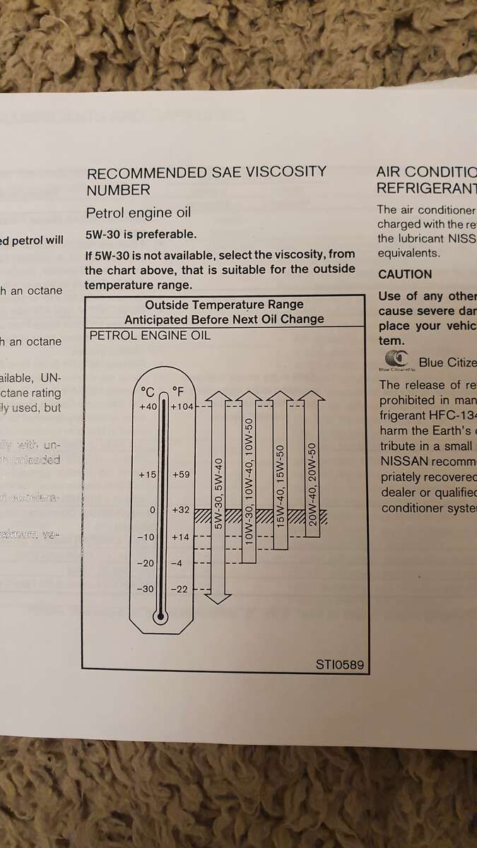

5w-30 fully synthetic oil as recommended directly from the owners manual (16 plate Nismo)
HOWEVER, I have switched to a slightly thicker oil, 5w-40 millers CFS as I wanted a slightly higher protection when warm. My Nismo just ticked over 35K on the clock. Do not cheap out on the oil, as mentioned above Opie oils are seriously good guys

Just to clarify, the spec required for your car is API SN 5w-30. When you put your reg into our look up guide it looks for all 5w-30 oils that meet API SN as they are suitable. If they meet other manufactures specs as well it does not matter :thumbs:
