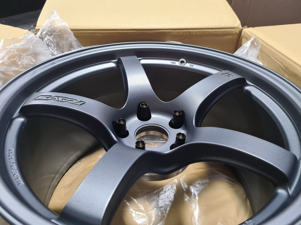

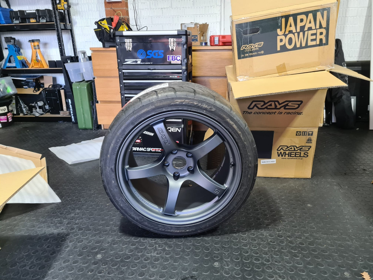

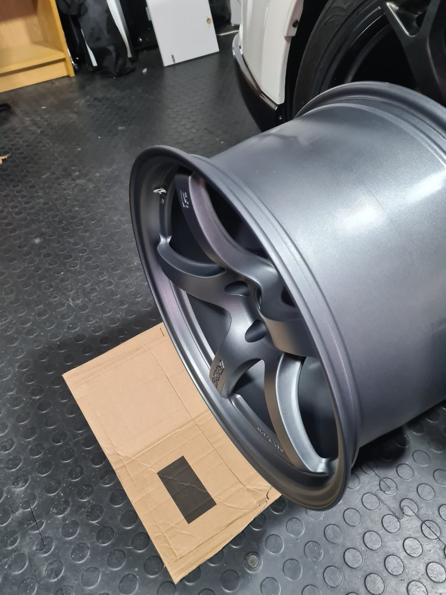

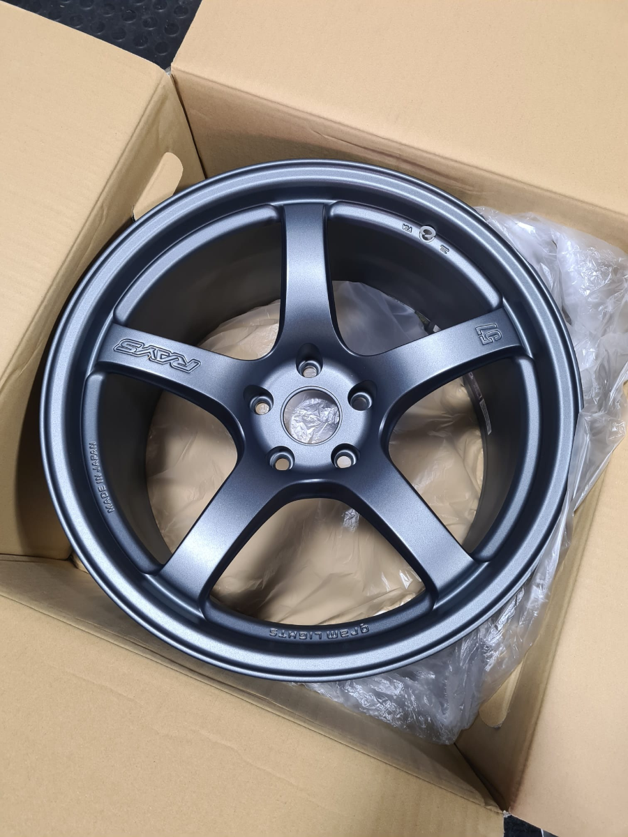

Very tasty indeed and gains to be felt in the drive of the car for sure. What size tyres will accompany the new wheels? I've always thought the Z34 has too much body for 18's, so very interested to see how this turns out visually.
285/35R18

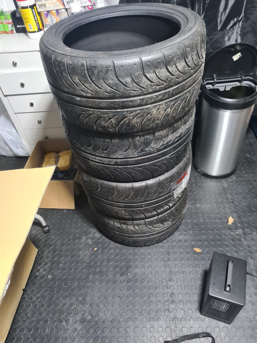

the reason I've chosen to go to an 18" setup is firstly to I can have a true square setup and secondly the range, availability and price of semi slicks in 18" vs 19" is on another level! These wheels will eventually pay for themselves in about 4 sets of tyres time.
The square setup gives me much more tyre up front for front end grip & turn in as well as reduced shoulder wear (which is an issue due to the weight of the car) as well as me being able to rotate wheels to maximise tyre life across the whole tyre.
So its more of a function over form thing for me but a wheel with a big beefy track tyre looks far meaner! Some people before 20s will rubber bands for tyres, its more about what you cars purpose is.

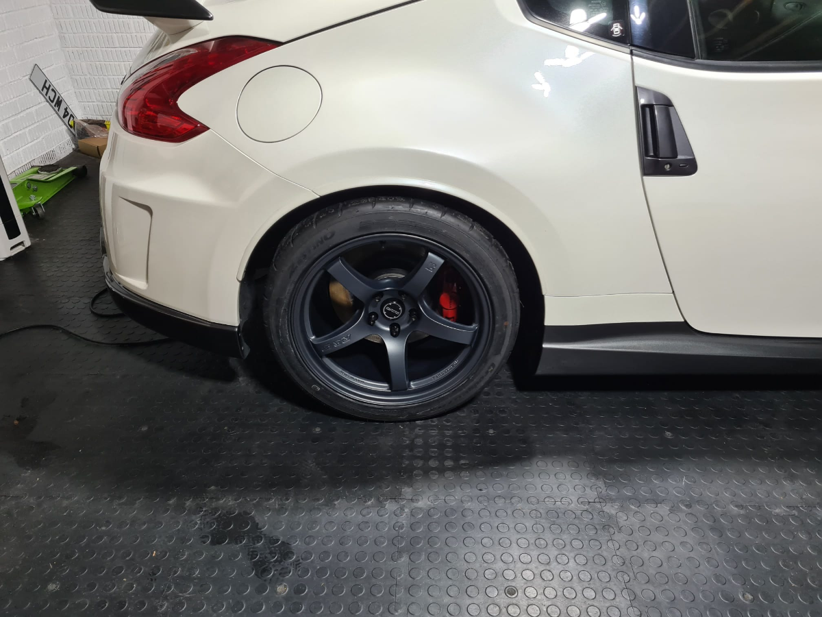

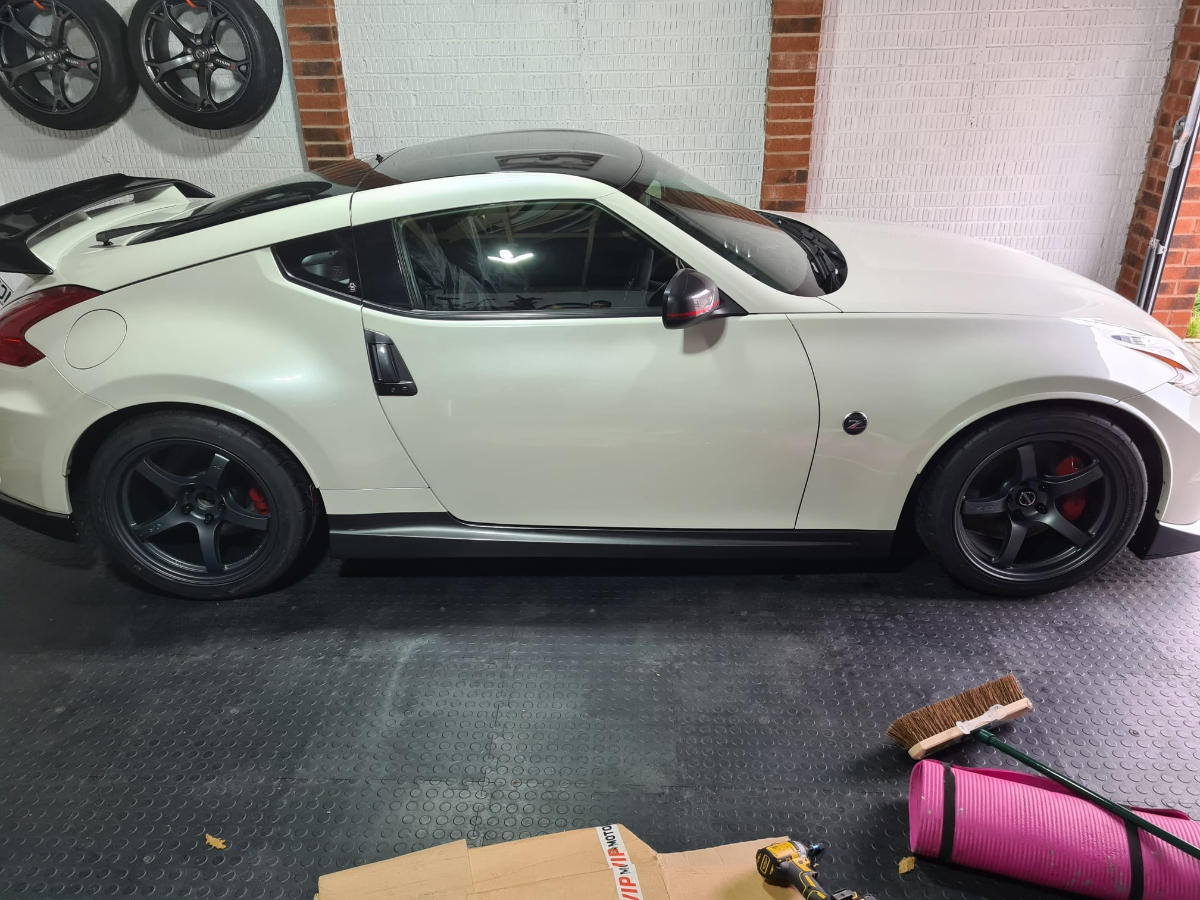

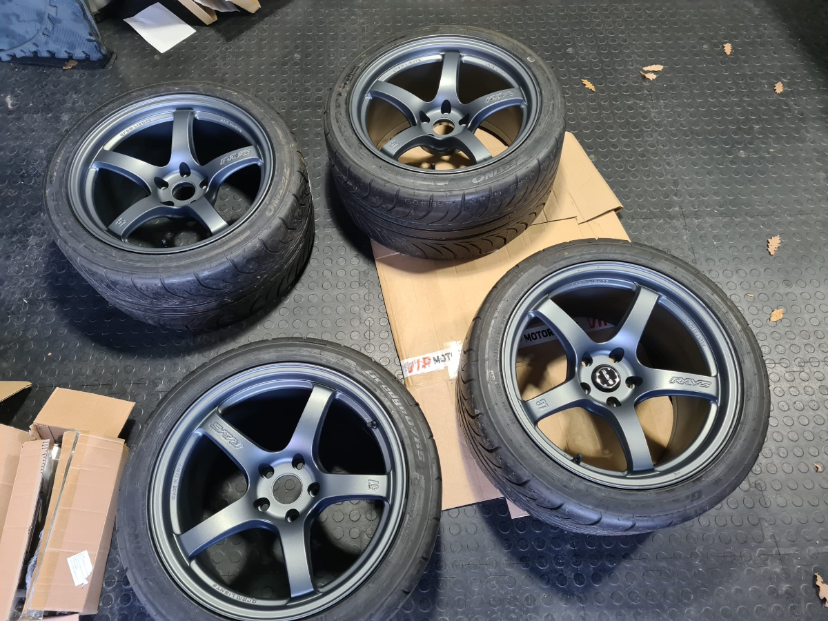

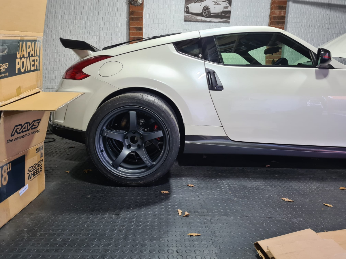

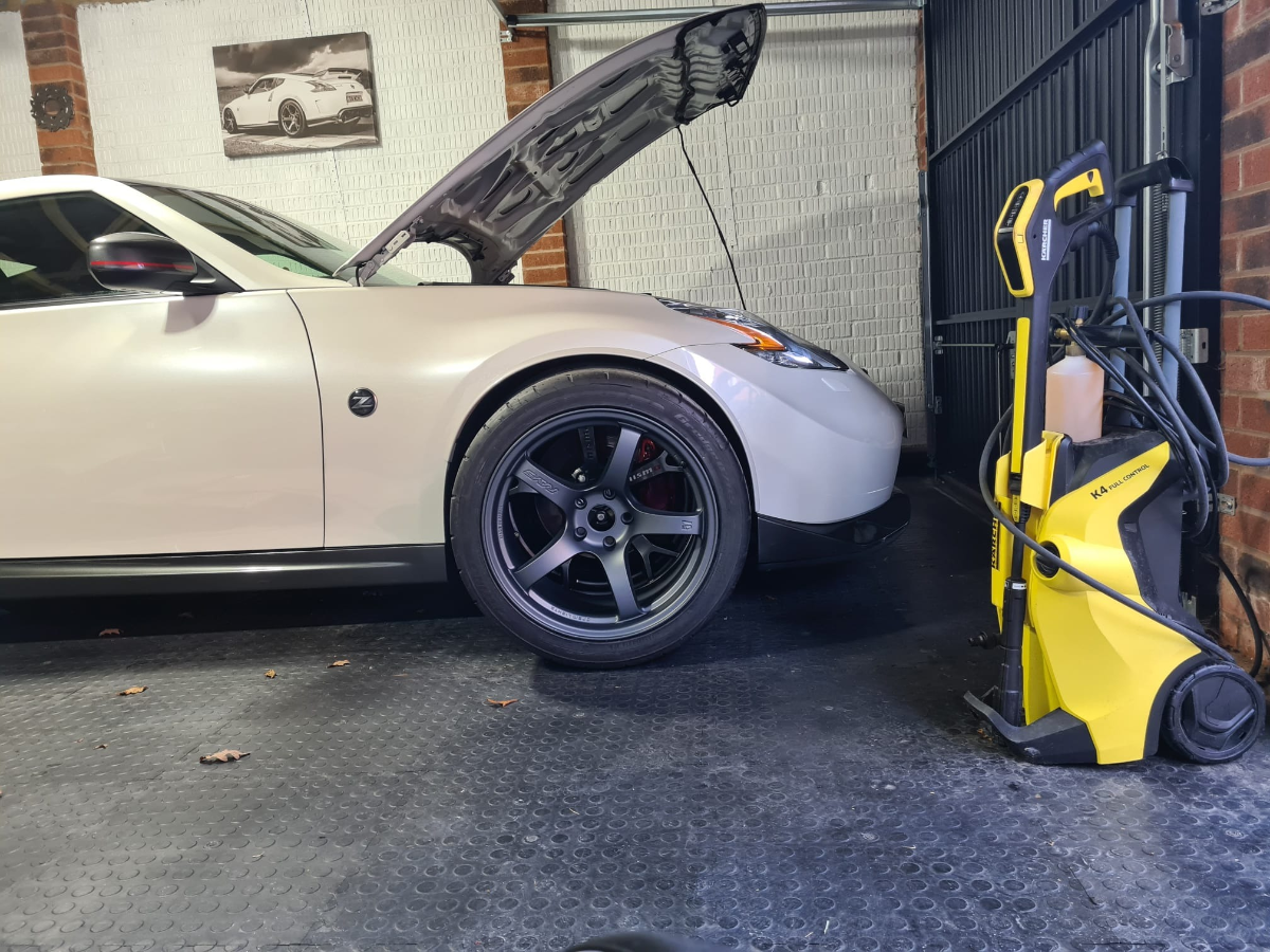

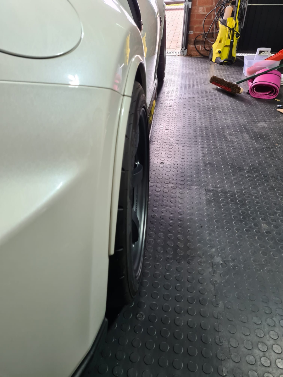

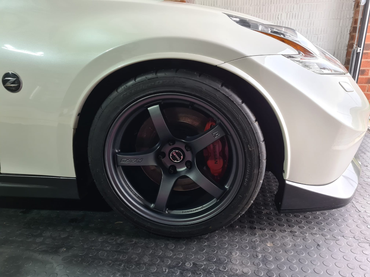

After a quick coat of C5 to try and keep molten brake dust at bay the wheels are on!
Really happy with how its turned out... proper beefy track orientated setup.
One thing I have decided is that the 2.4 deg of camber I'm running at the front isn't enough - never has been really (still get outside shoulder wear on track) but the kinetix camber arms I'm running now are maxed out so I have ordered some replacement in the form of some hardrace ones - should give me more adjustment than I'll ever need. The kinetix arms have been spot on and will be up for grabs soon once I've swapped them out and cleaned them up.
Another thing I'm pondering is a further drop in ride height (it will actually sit a little lower, especially the rear, than the pictures show once the suspension settles - I'd only just dropped it back on the floor at this point). But if I was to do this I'd likely need to swap out my ark grip V2 for something with a little more ground clearance. I absolutely love the Ark so really don't want to but I've got a decision to make and somethings got to give. Any input on this would be helpful as I'm on the fence at the minute.
