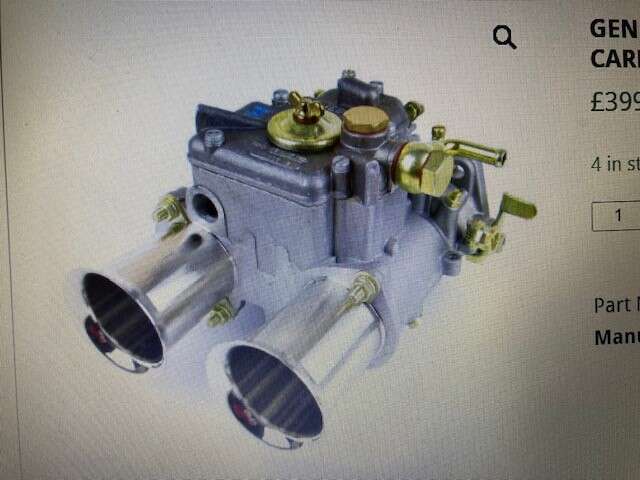

twins as per the current set up... Pair of these

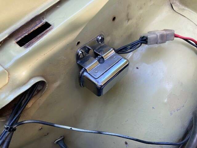

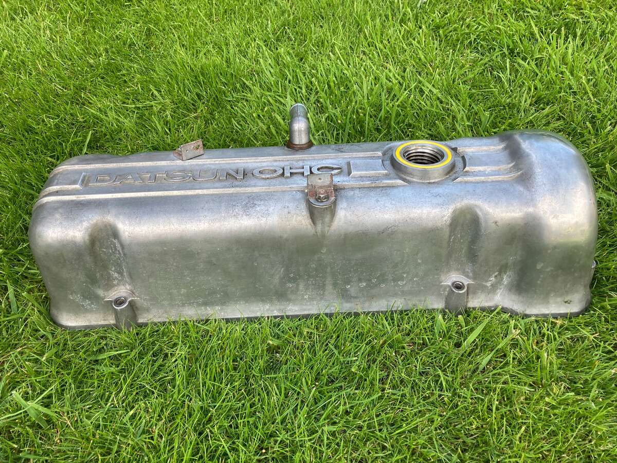

One of the advantages of still working from home is that during your lunch hour you can knock a couple of small car restoration bits out Todays lunch hour was spent polishing my relay on my polishing wheel. She has gone from tainted 1971 relay to a shiny chrome one in 30 mins. Rocker cover is next at the weekend.

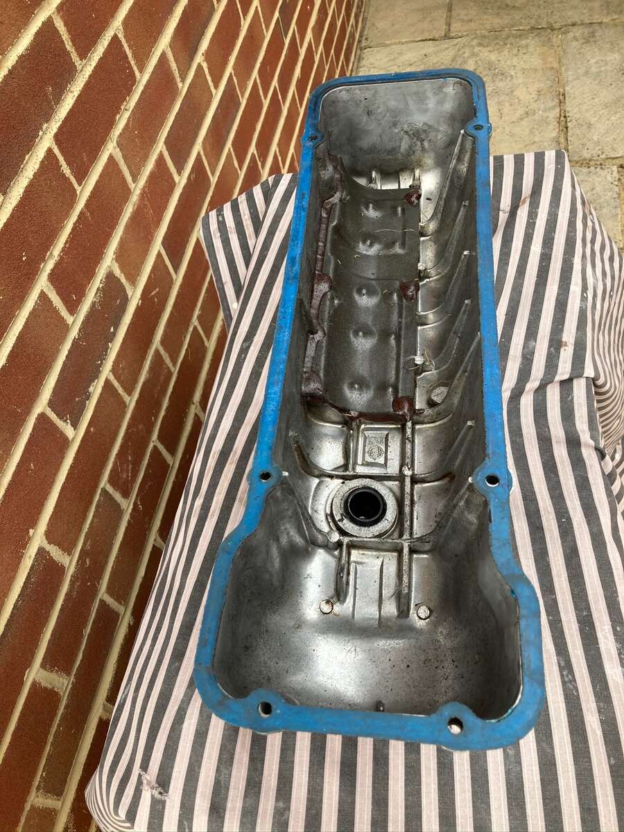

oh lord, started the rocker cover today, what a job that is. I reckon 6 hours work in that. Hoping to refit Sat if I have any fingers left.:angry:
Posted (edited)

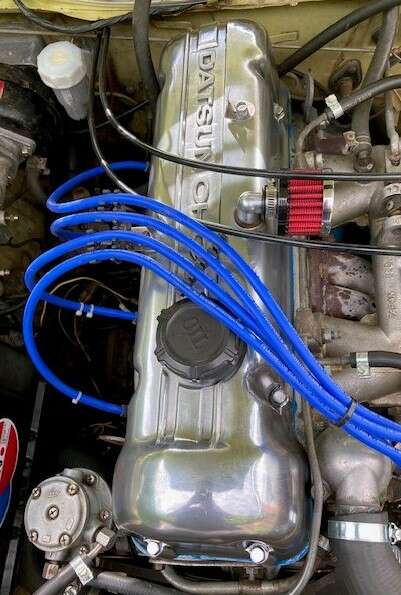

Well, it’s not perfect but I guess it is 50 years old and it should show some age. It’s finished and going back on tomorrow. Before and after photos of the rocker cover after it had a lesson on my bench polisher.

Refitted and I am pleased with the overall result. Polished her retaining bolts too. Onto the next project.

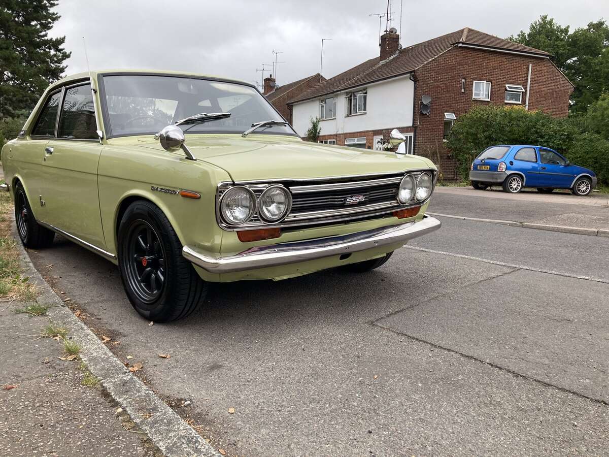

Ok, so little update on the project. Just refitted the re chromed bumpers and have had a rethink on the finished look I want on the car. Decided to keep the rear bumper but remove the front, mesh the openings a run with a front chin. Photo of the rear bumper back on and the planned new front look. All thoughts and opinions welcome.
