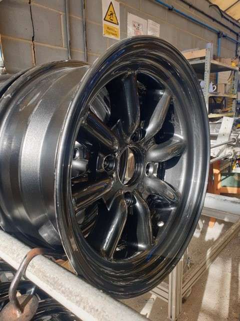

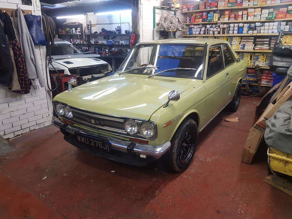

Payco Posted February 27, 2020 Author Posted February 27, 2020 (edited) Found myself some original watnabes in the very hard to find right size, 114.3 pcd and in 14's with right offset. Had them refurbed this week and collecting them Sunday for fitting next week before she heads off for a week to have her coilovers and suspension set up all fitted. Edited February 27, 2020 by Payco 7 Quote

Payco Posted March 8, 2020 Author Posted March 8, 2020 Small update. Delivered her to Herne Bay yesterday on her new rims for the coilovers to be fitted. Have to say the 2.5 hour drive was so much fun. Surprised I didn’t cause an accident as so many people glanced over at her. Photo of her on the new rims in the workshop. 5 Quote

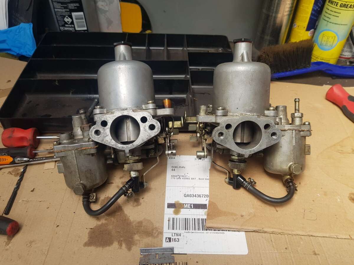

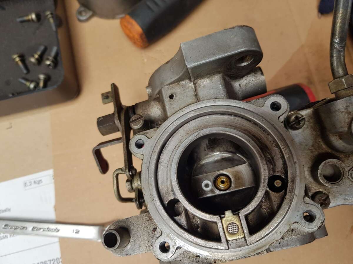

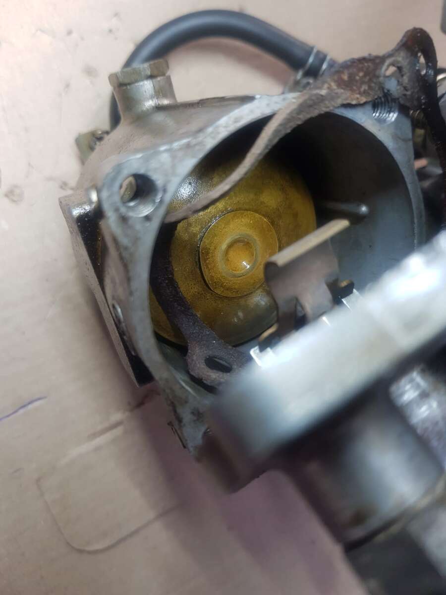

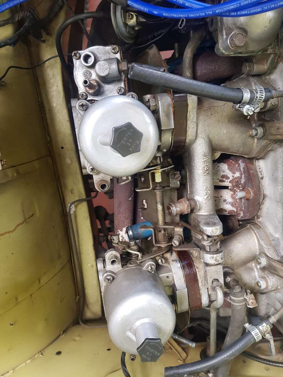

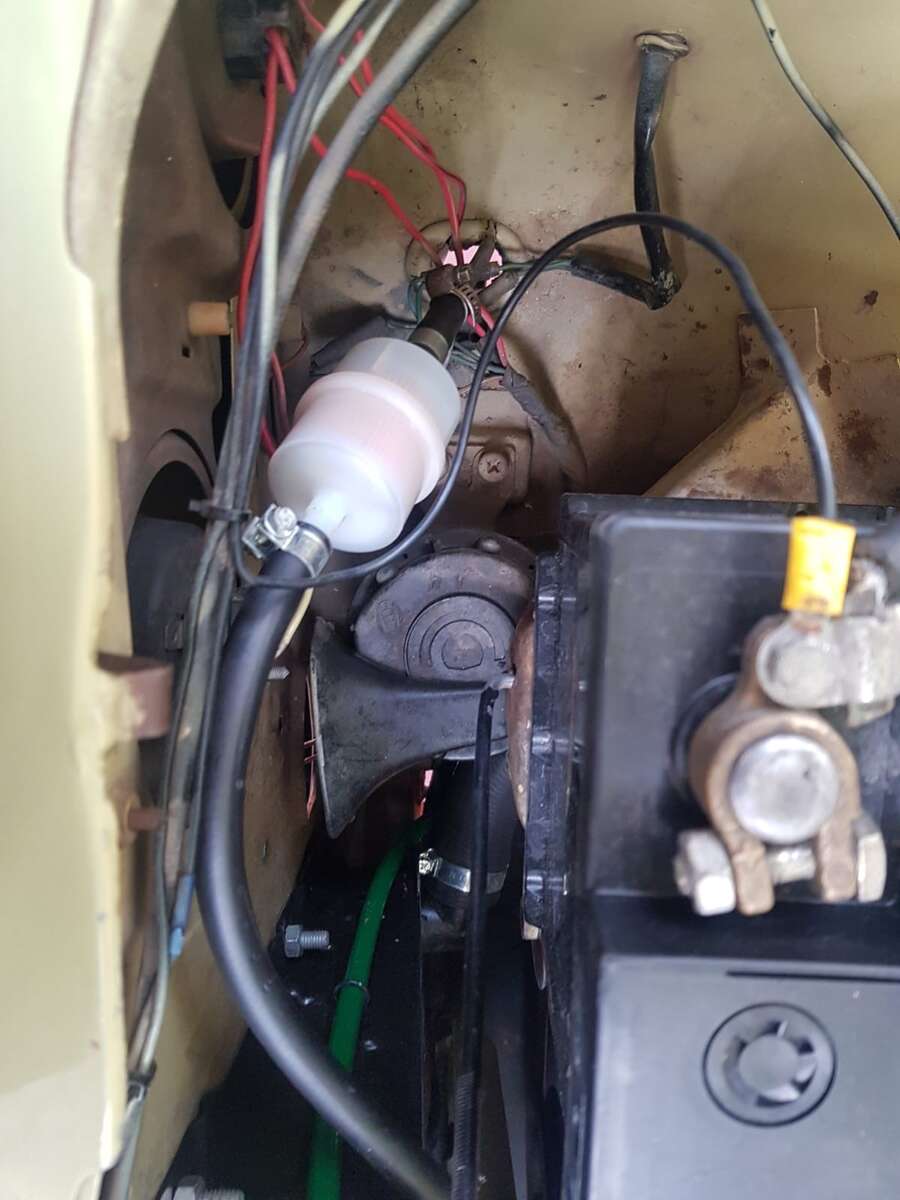

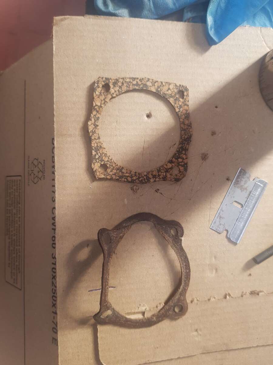

Payco Posted May 14, 2020 Author Posted May 14, 2020 (edited) the restoration project is now resumed. Currently the carbs and associated hardware is being rebuilt as on inspection there are a few signs of wear in her 49 years of being in this world. Gaskets were shot so new ones have been made from gasket corking as originals are near impossible to source. Also had to put a new copper float in the rear carb as she had become porous. They are all refreshed and going back on with new fuel pipes and clips. Lastly, added a new fuel filter. Edited May 14, 2020 by Payco 6 Quote

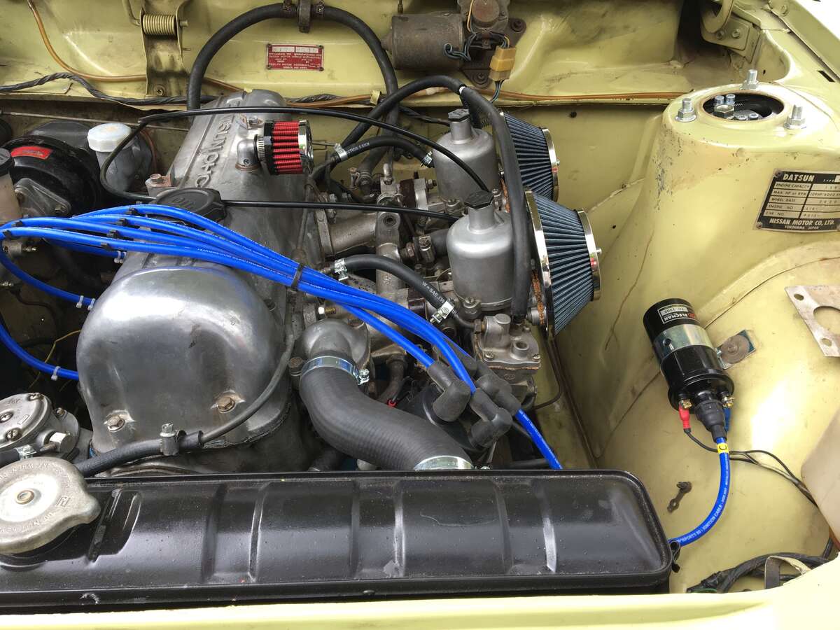

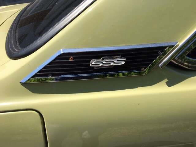

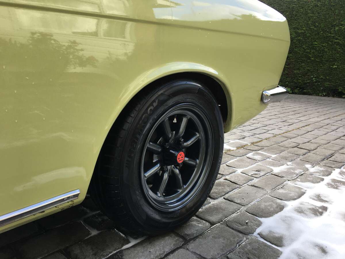

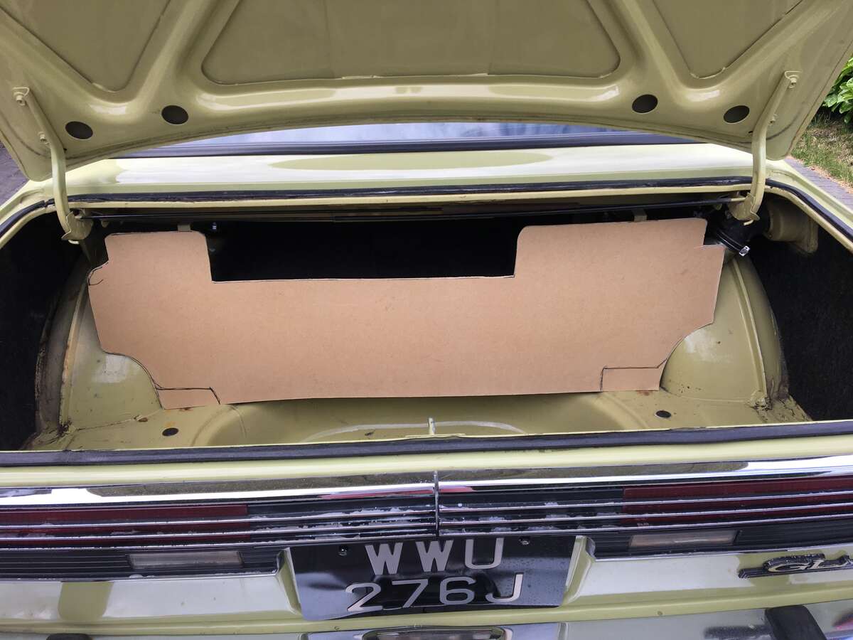

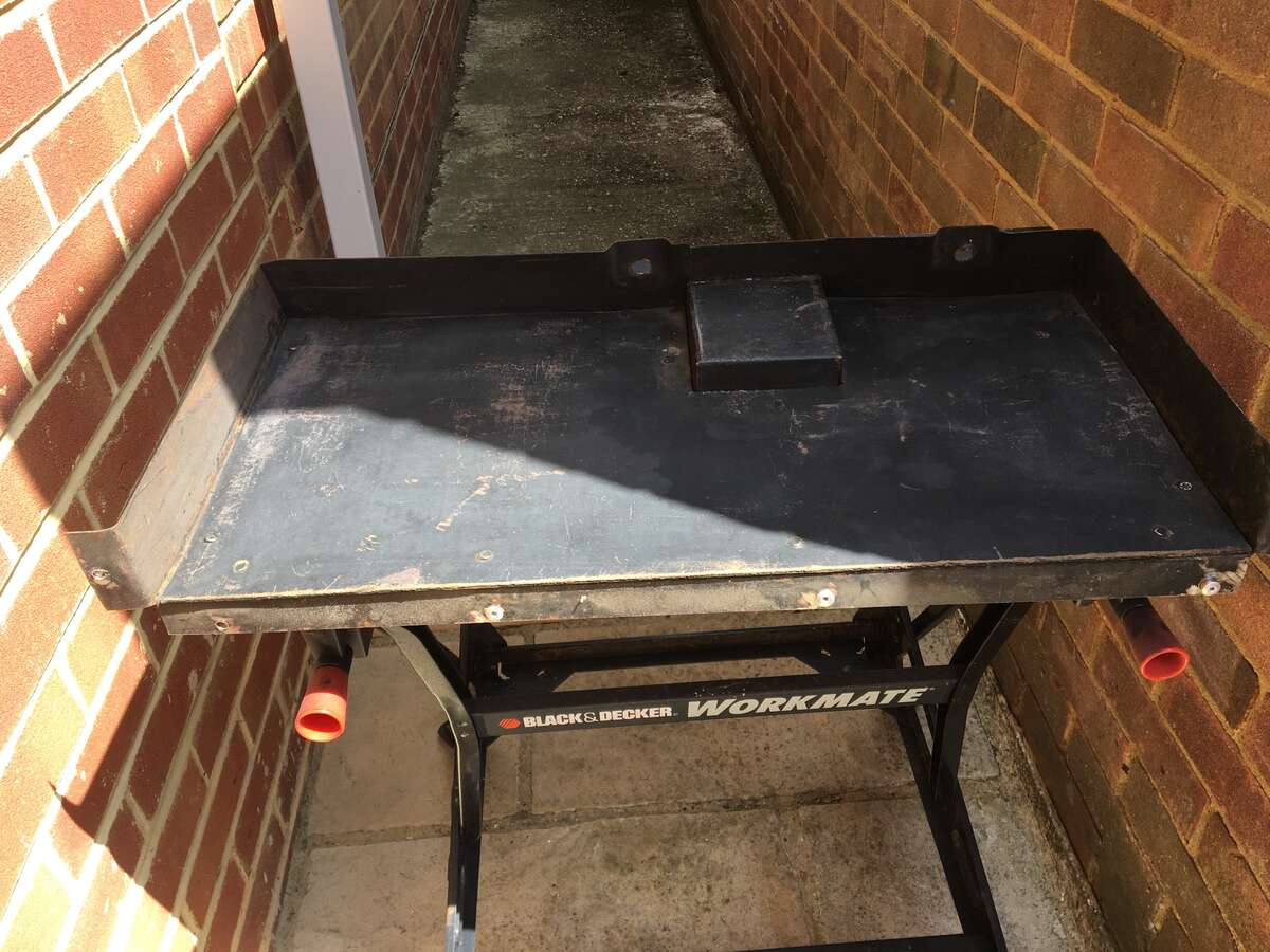

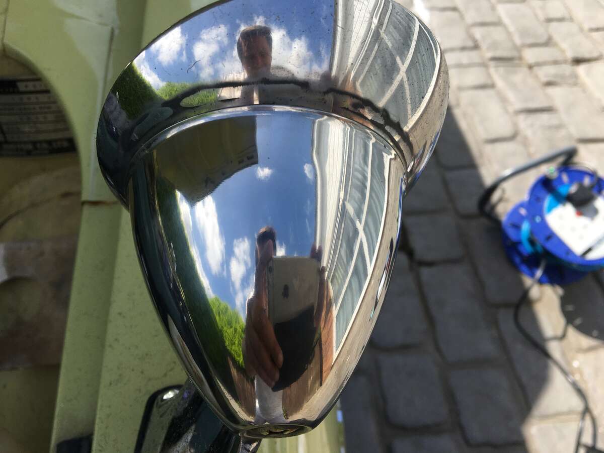

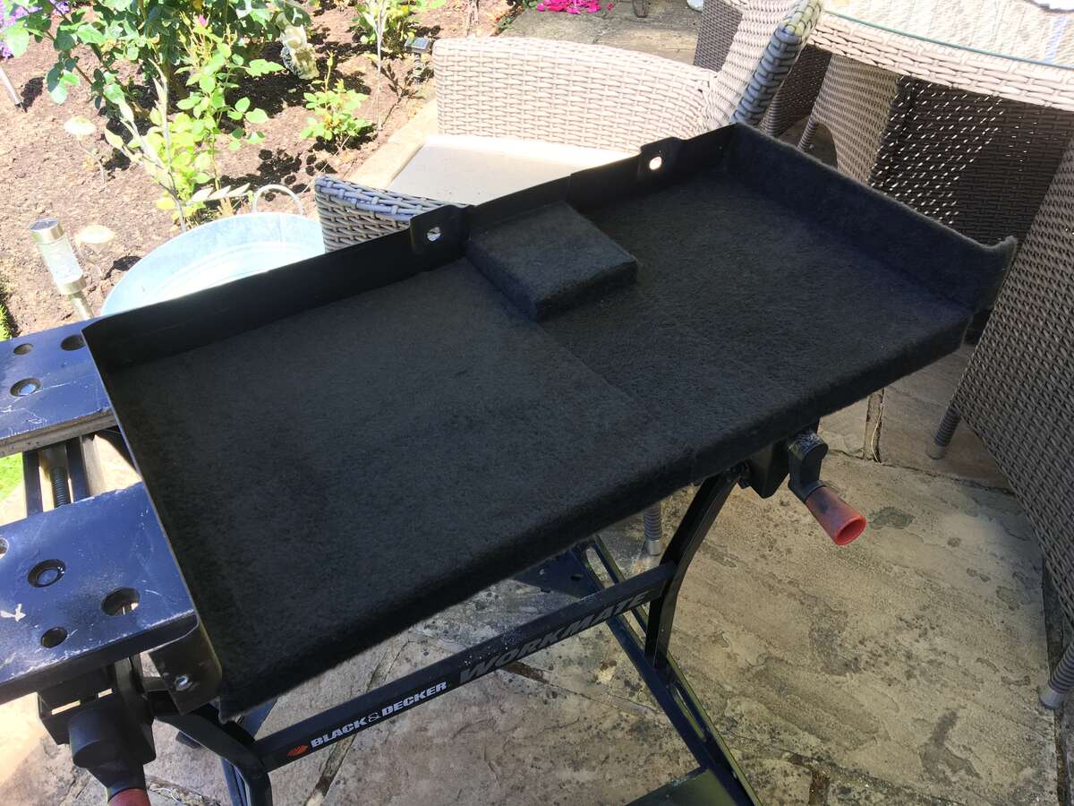

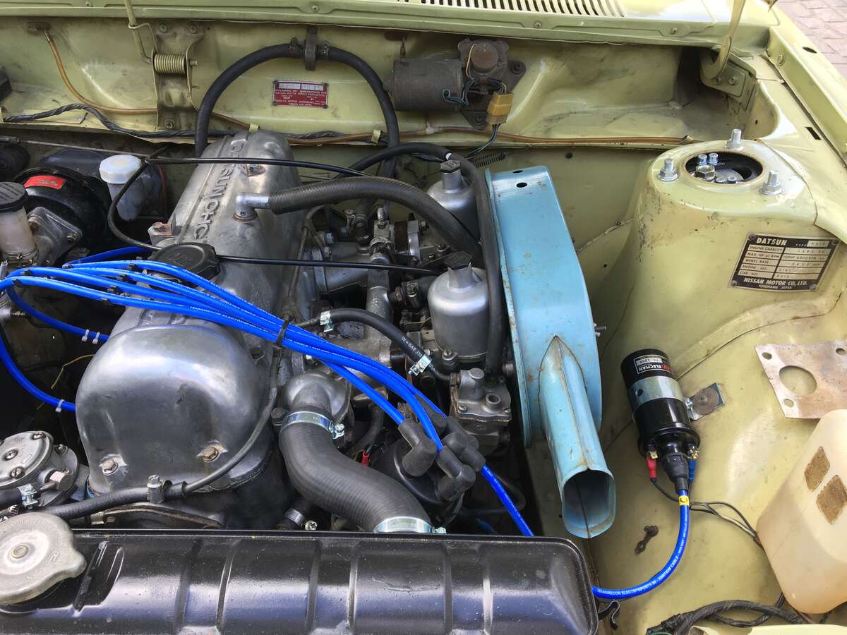

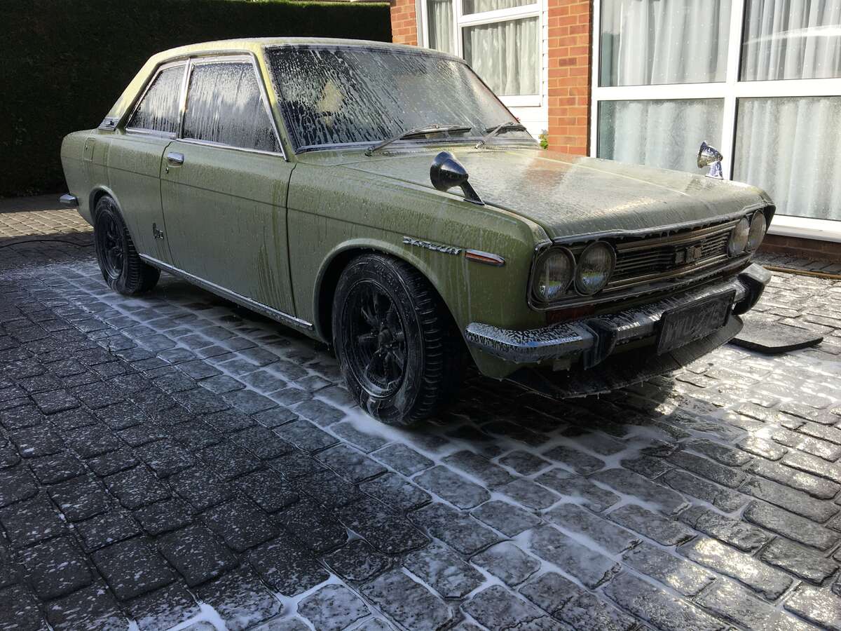

Payco Posted May 27, 2020 Author Posted May 27, 2020 (edited) Hi all. A lot has happened in the short time she has been back with me having been locked down having her suspension fitted since 18th March. She now sits much better on her coilovers. First up was to give her a good clean, polish the original and rare watanabe rims and dress the tyres. Next was to polish the wing mirrors mounted on her bonnet. Followed this little job with a refurb of the grill and then fitted my SSS badge. Swapped out the standard airbox for some conical filters and added the required breather filter. Removed the tatty petrol tank cover in the trunk and carpeted it. Next job was to template a new back plate to the trunk which I will also cover along with making a new boot floor plan and carpeting that too. Will let you follow the photos in order of the above. More to follow over the coming days and weeks. Hope everyone remains safe and well. Edited May 28, 2020 by Payco 6 Quote

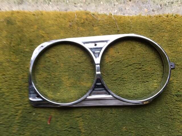

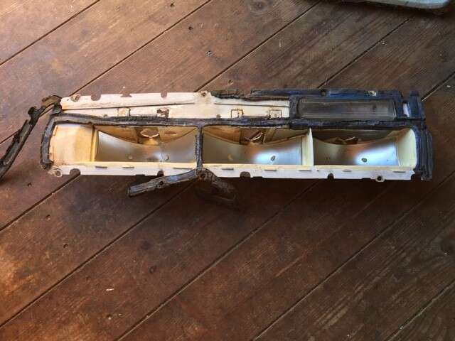

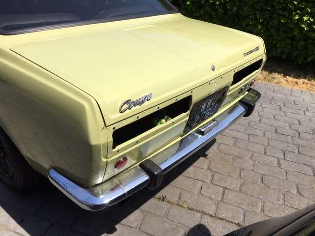

Payco Posted June 2, 2020 Author Posted June 2, 2020 (edited) So next up is refurbishing the rear light clusters. They will be repainted and re chromed but as always with older cars it isn't that simple. Removed the units and opened them up to clean but 50 years of being on this planet has meant the rubber internal gaskets are all dried out and rotten. Have ordered some self adhesive 2mm/5mm draft excluder rubber to make my own replacements. Lights are now out ready to drop off Saturday along with my rear quarter badges and front light surrounds. Replacing current rear bulbs with plug and play LEDs. Edited June 2, 2020 by Payco 3 Quote
