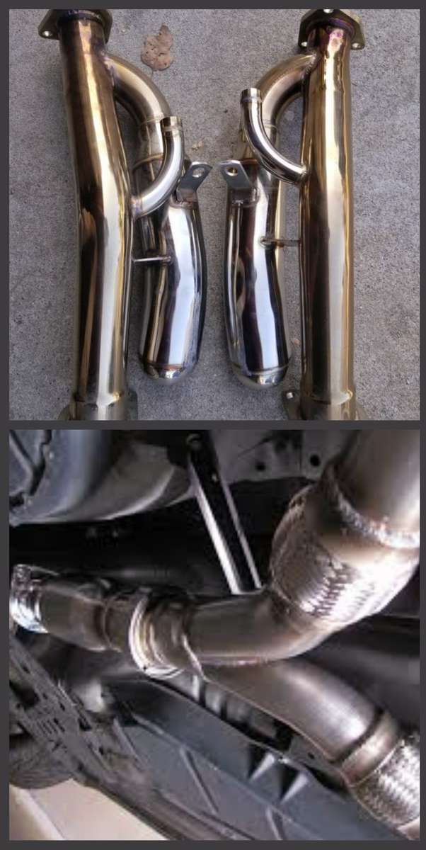

davey_83 Posted August 6, 2019 Share Posted August 6, 2019 (edited) Recently fitted the Motordyne ART and XYZ pipes and im chuffed with the new set up and noise. Engine revs out easier with noticeably stronger pick up, no rasp or drone at motorways speeds either thankfully. Hopefully the eml stays away Edited August 7, 2019 by davey_83 1 Quote Link to comment Share on other sites More sharing options...

msitpro Posted August 7, 2019 Share Posted August 7, 2019 (edited) On 06/08/2019 at 11:48, davey_83 said: Recently fitted the ART and XYZ pipes and im chuffed with the new set up and noise. Engine revs out easier with noticeably stronger pick up, no rasp or drone at motorways speeds either thankfully. Hopefully the eml stays away Was it you bought them off me? Lovely job on the heat wrap... and painted helmholtz resonators? Don't suppose you've had a HC count check on a emissions tester? I think that single cat is only 200CPSI? I've got new custom made sports cats which are 200CPSI, same as BERKs I believe. EML comes on currently but I have some 45 degree spacers to add. The rest of my custom 3" post-Y system with 2 resonators then makes it insanely loud at low throttle loads in traffic... Might take it back to get another large res. added straight after the Y section. (it's single all the way to tip) Edited August 7, 2019 by msitpro Quote Link to comment Share on other sites More sharing options...
msitpro Posted August 7, 2019 Share Posted August 7, 2019 6 hours ago, ILUVUNICORNS said: I’m now worried my new system will be too loud? i have just got a Cobra Cat Back Exhaust Decats, Stillen Gen 3 CAI with an UpRev. What diameter is the Cobra system and what sort of mufflers/resonators has it got? Dual exit with muffler on both branches? Quote Link to comment Share on other sites More sharing options...
davey_83 Posted August 7, 2019 Share Posted August 7, 2019 Not had the emissions checked, but I'm hoping the ceramic coating & heat wrap will help the HFC to do it's thing. Yeah it's the one from you David. Pictures of your new set up please fella 1 Quote Link to comment Share on other sites More sharing options...
msitpro Posted August 8, 2019 Share Posted August 8, 2019 15 hours ago, davey_83 said: Not had the emissions checked, but I'm hoping the ceramic coating & heat wrap will help the HFC to do it's thing. Yeah it's the one from you David. Pictures of your new set up please fella Don't catalysts operate better the more heat they have? Although then typing that I'm thinking, actually, the heat will stay in the exhaust components rather than dissipating out... So yeah, that's a great idea in theory - acts as a heat shield to other components and keeps the heat in the exhaust for better emissions. I've not got many good shot of it yet tbh, life been a bit mental recently - any spare time I did have on the car around a month to month and a half ago was making sure it was in tip top shape for trip to Spa to watch the 24hr. Here's a couple anyway, viewing rear and the Y-pipe. I had DC Sports stainless headers (extra smoothed/de-burred inside by me also) installed along with the custom cats and rest of system. 1 Quote Link to comment Share on other sites More sharing options...
davey_83 Posted August 8, 2019 Share Posted August 8, 2019 (edited) That set up looks real nice fella, question is what's next? Do you have a build thread? Yeah the wrap is to keep the heat in helping the cat and hotter gases travel faster. Hopefully should lower the transmission tunnel warm also as after sprinted drive it's rather toasty. Plus it's looks sick as f**k!!! Edited August 8, 2019 by davey_83 Quote Link to comment Share on other sites More sharing options...
