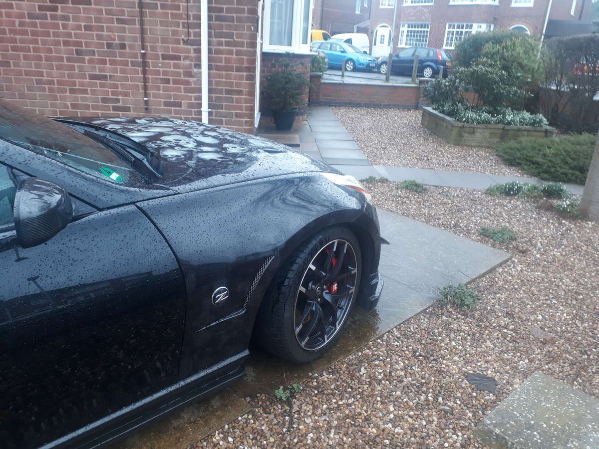

Sim Posted November 15, 2018 Posted November 15, 2018 Just thought I'd post this up following a discussion on FB and see what other peoples views are on the subject. I have had lots of different bits of carbon and non-carbon bodywork over the years. The quality of all the carbon has been good on first inspection and it has generally fitted well. My biggest bugbear is with Seibon and the speed at which it suffers UV damage. There is even a warning in their paperwork saying to keep it out of sunlight? Seriously, when you are paying out for exterior car parts (and not cheap parts either), and lets be honest for most regular people, their car lives outside for most of it's life, why sell parts with substandard lacquer? It's not like my car doesn't get washed and waxed regularly. Quote

Umster Posted November 15, 2018 Posted November 15, 2018 I've been fortunate enough to get some of the marking away from the top layer with polish. Risky but worked on the top coat. I've got some discolouration deeper down on my spoiler and it's just the nature of the beast? Some people recommend wet sanding it down and even redoing the clear coat. Not sure how much sense that makes. Quote
AW11mike Posted November 15, 2018 Posted November 15, 2018 You can brush on some AY103 epoxy resin then polish to rejuvenate the finish and colour .wet sand then cutting compound. 1 Quote

Sim Posted November 17, 2018 Author Posted November 17, 2018 On 15/11/2018 at 22:05, AW11mike said: You can brush on some AY103 epoxy resin then polish to rejuvenate the finish and colour .wet sand then cutting compound. I've got some paint protector conserver that works ok for short periods, will the method you suggest work long term? Whats the best grade wet sand to use, 2000? Quote

AW11mike Posted November 17, 2018 Posted November 17, 2018 1 hour ago, Sim said: I've got some paint protector conserver that works ok for short periods, will the method you suggest work long term? Whats the best grade wet sand to use, 2000? Yes, you will be putting a fresh coat of epoxy to seal the carbon, but the paint clear coat would have to be removed first. Epoxy is very stable and very strong, you can start with 800 wet then go up to 2000. I have used the same technique on jet engine acoustic panels, and found it works really well. 1 Quote

Sim Posted November 19, 2018 Author Posted November 19, 2018 On 17/11/2018 at 17:18, AW11mike said: Yes, you will be putting a fresh coat of epoxy to seal the carbon, but the paint clear coat would have to be removed first. Epoxy is very stable and very strong, you can start with 800 wet then go up to 2000. I have used the same technique on jet engine acoustic panels, and found it works really well. Magic, thank you. I'll probably have a go at some point or just wrap the wings the same as I did the bonnet, I'm slightly concerned about going too deep and damaging the carbon. Quote

Sim Posted February 16, 2020 Author Posted February 16, 2020 (edited) Just thought I'd update, as I finally got round to wrapping the wings to match the bonnet but with a slightly more subtle faded version of the same print. Pulse Signs in Coalville did it again and I'm very happy with it. Edited February 16, 2020 by Sim Quote
