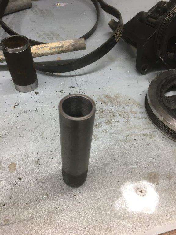

Cut 2 thin lengths from a larger bit of pipe
to make a small pulley

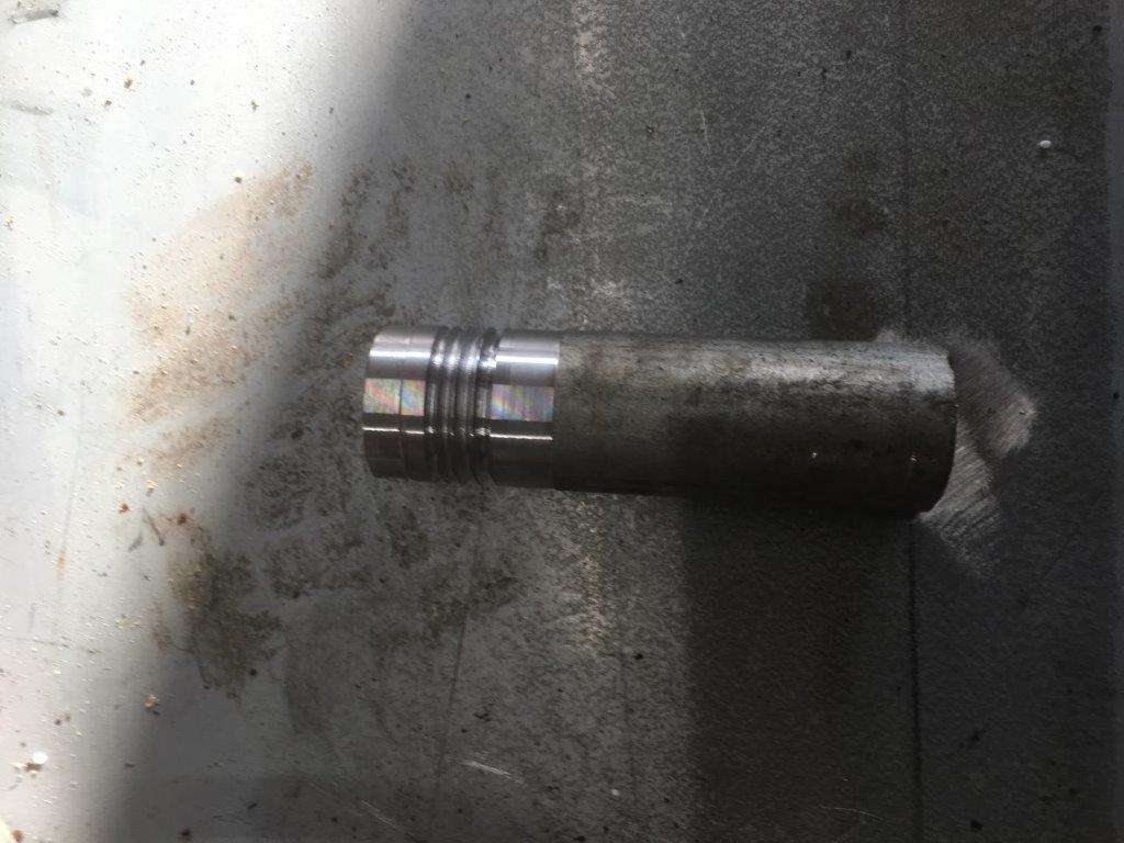

Front pulley from a 350z DE engine
on the lathe
then add an adapter to fit onto the bead roller

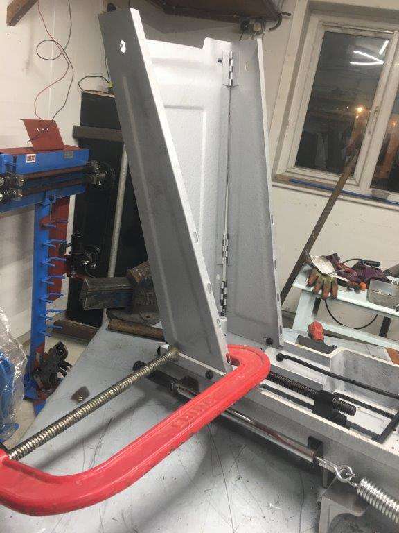

Also when I tightened all the bolts it was hard to turn, This is due to alignment,
Top side
That's a lot of run out!
The bottom is bowed (hard to see)
Few solutions, angle iron or 1" box section welded to the back - I didn't have any 1" box and I do like to overdo things so..................
Cleaned the paint off
Clamped it up
Yup thats 70mmx70mmx5mm walled box - lets see that flex :lol:
All welded on
Quick check shows....
Thats better
This is the lower half befor the box
That shows the "flex"
That came true after I welded the box to it :thumbs:

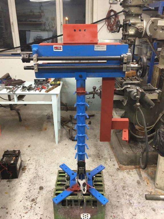

Then I made a frame and put the motor on
The 2 bolts both align it. stop it twisting and allow me to tension the belt (from a 350 of course)
Testing
All went well so I cleaned it up and added a foot pedal
Yeas a brake pedal from ............Ahh you guessed :lol:
