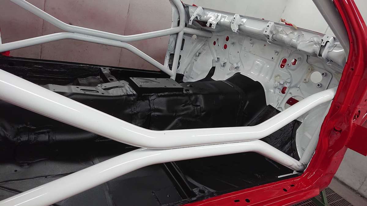

Then came the decision to get someone who knew what they were doing to make it go faster and safer.
So I approached Mark and the team at Abbey for the mechanicals and Terry Loxton for the restoration of the shell and started the strip of the donor 350Z.

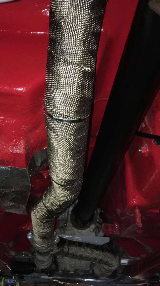

Leadfoot Racing have completed the cage and Abbey ahve completed the engine mounts and mock up, so soon it will be winging its way to Terrys for the shell work.
I'll put some more pics up as it progresses.

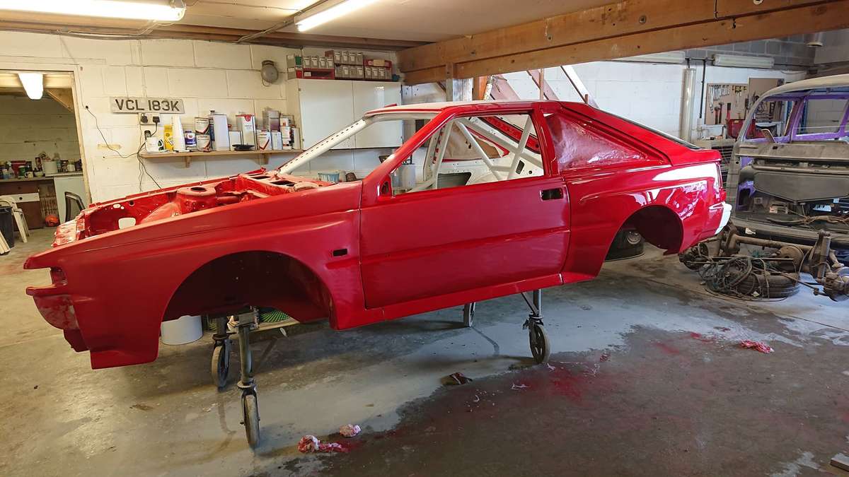

Quick update :)
The beast has reached the bodyshop.
Its with APVM who are doing a great job, check them out of you need something restoring.
http://www.apvmbodyrepair.co.uk/
Hopefully it will be heading back to Abbey in a few week time ready for the rebuild. :)

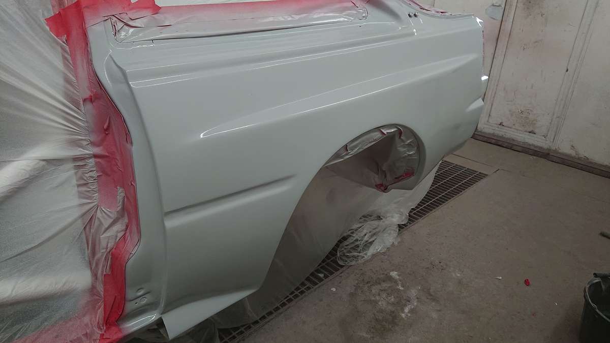

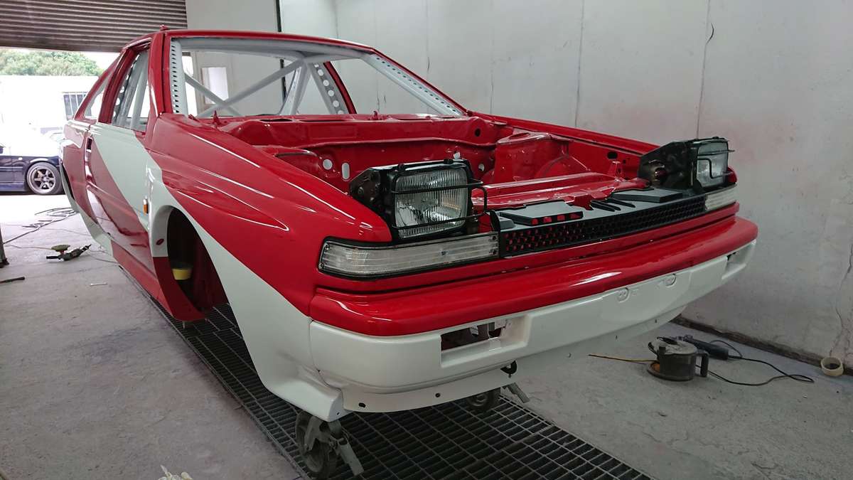

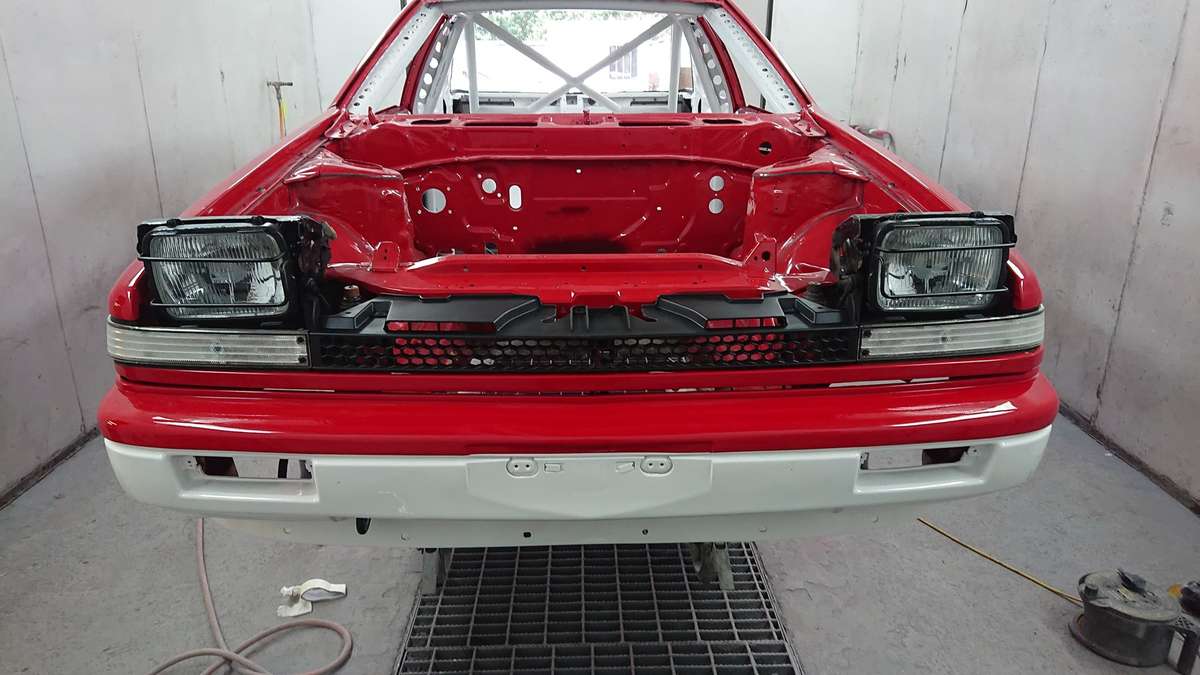

Few more pics from Body shop.
Getting me far too excited again :)

On 02/04/2019 at 13:59, docwra said:
Is that a genuine Grand Prix kit?  If so youre mad putting it on a driftcar :lol:
lol, its an ebay GP kit :)
I'm mad for doing the whole project ;)

The big question is does it stay all red or do we stick with the original plan and put big white stripes on it?

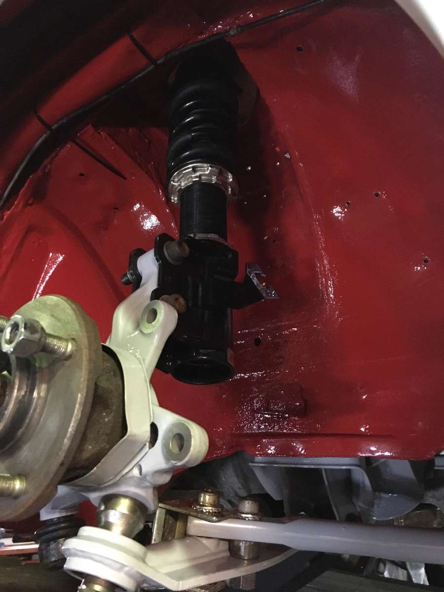

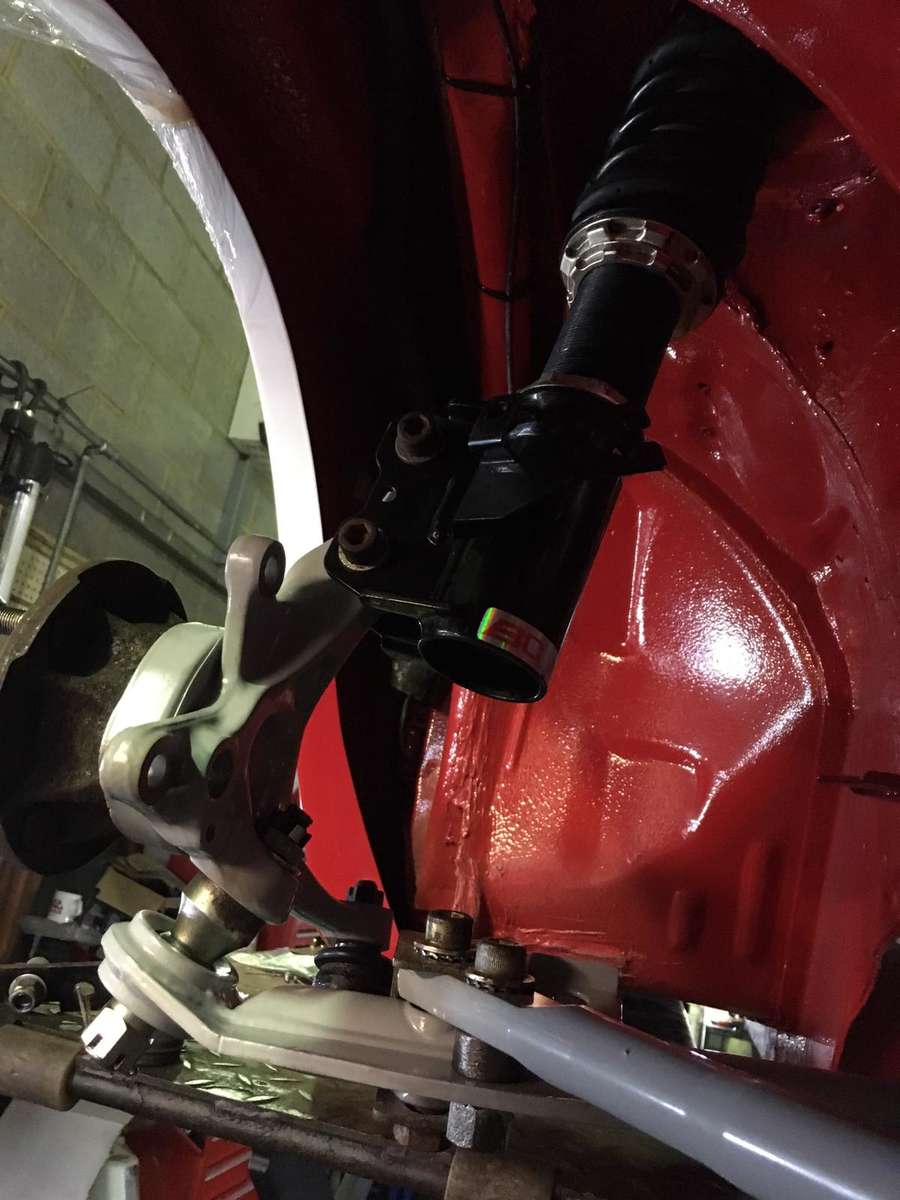

Sorry for the delayed update, but it's well under way being put back together now with Mark and the team at Abbey Motorsport.
Front end, S13/S14/Japspeed adjustable LCA and Tension Rods, stock rack with delrin bushes from one of the S12 specialists in the USA, BC coilovers, S13 brakes which are enough to lock the front.

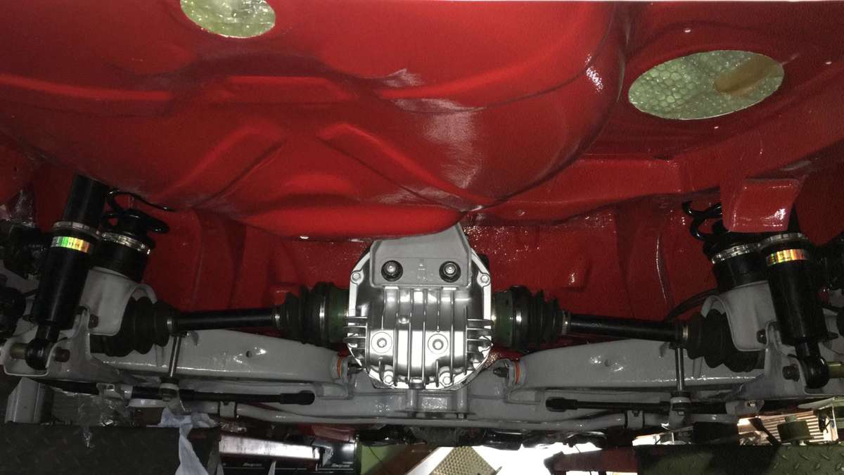

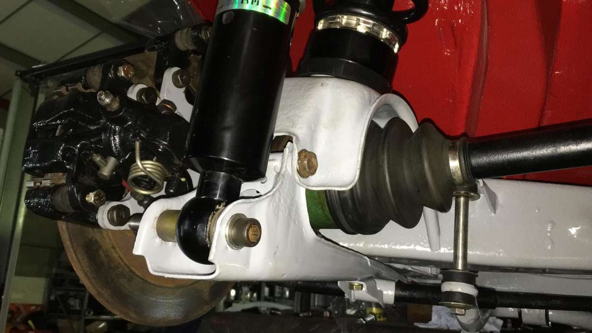

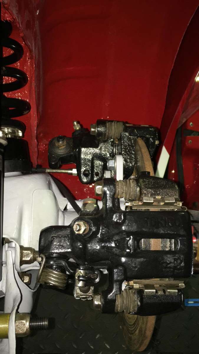

Rear: Z31T shafts, stubs and companion flanges, KaaZ 2 way lsd in stock R200 longnose housing, BC damper and adjustable perch kit.
KMAC adjustable camber bushes in the trailing arms and Z31 poly bushes in subframe
Twin S12 calipers, so hydro is on a separate circuit.

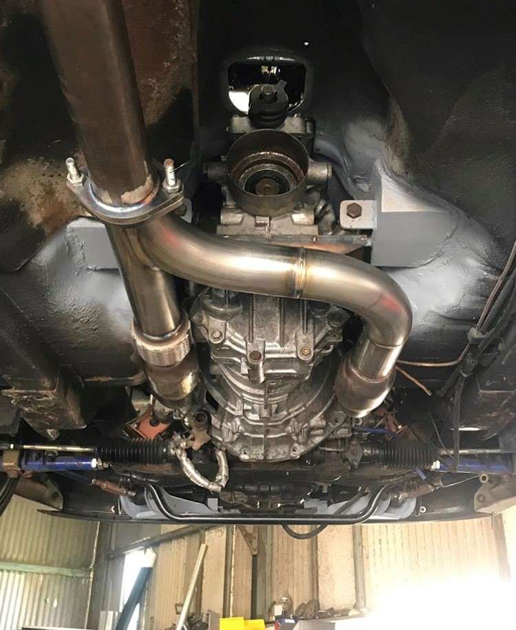

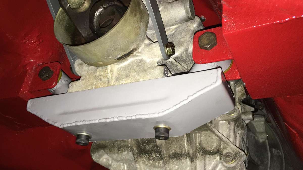

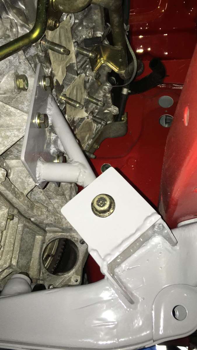

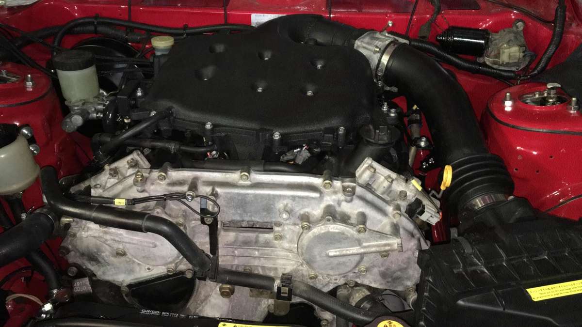

Engine: Custom mounts, custom prop, custom gbox mount/crossmember.
Pipe might be a bit loud but can always put a mid-box in.
