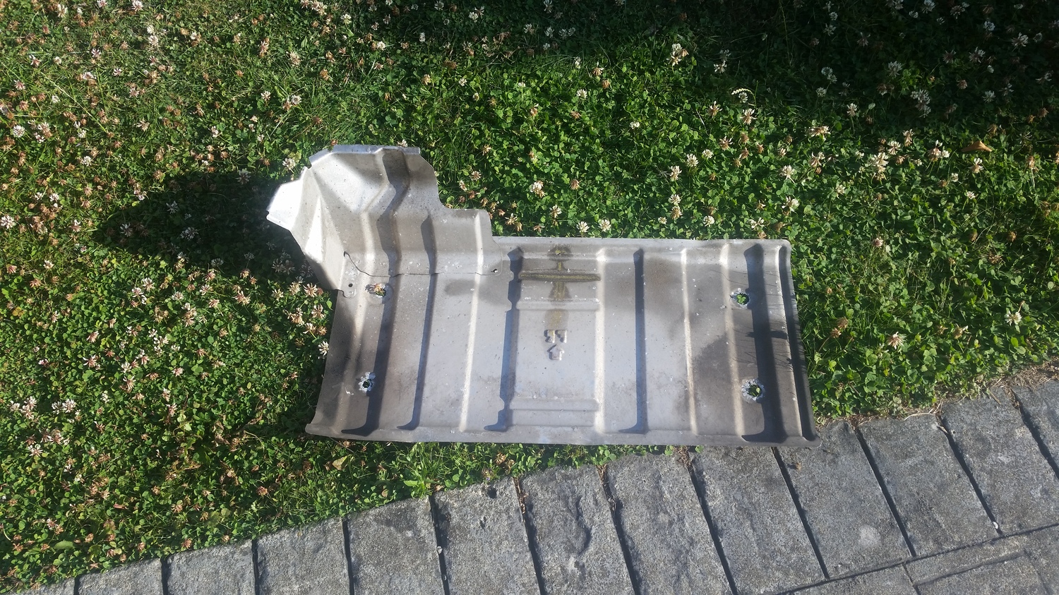

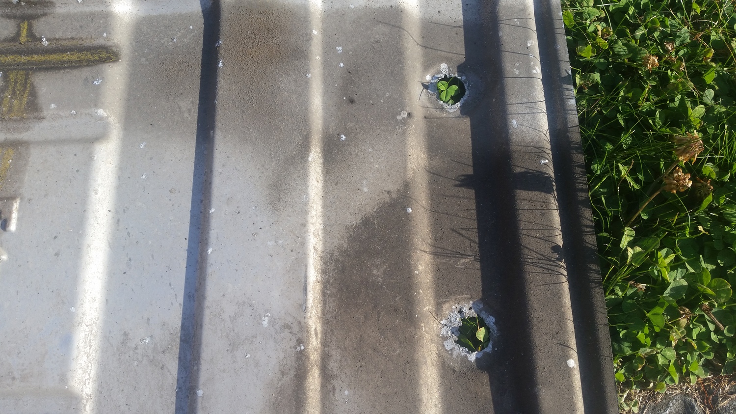

So started hearing a rattling from my back end going over speed bumps. Was worried I had lost part of my exhaust hangars or something similar, turns out to be a piece of aluminium from the back end just above the exhaust back box (maybe a heatshield or a spashguard?) But pretty much it looks like the bolts rusted and then started eating into the metal around the holes so eventually the left hand side gave out and was flapping about. Managed to take it off and now ive got to figure out where to get a new one or if its even worth putting it back on. Pictures to follow for anyone who knows what it is.
Did you replace it or just kept it off? Just curious if its necessary, getting it off was easy but i sheared the end of one of the bolts so i think ive got to go through the boot or somewhere to get to the tops of the bolts to replace them.
You could easily repair that, 2 aluminium strips each side 1 inner 1 outer drill through and rivet on to the heat shield, re-drill the mount holes and refit.
Far cheaper than replacement, but you could take option 3 and just bin it :)
