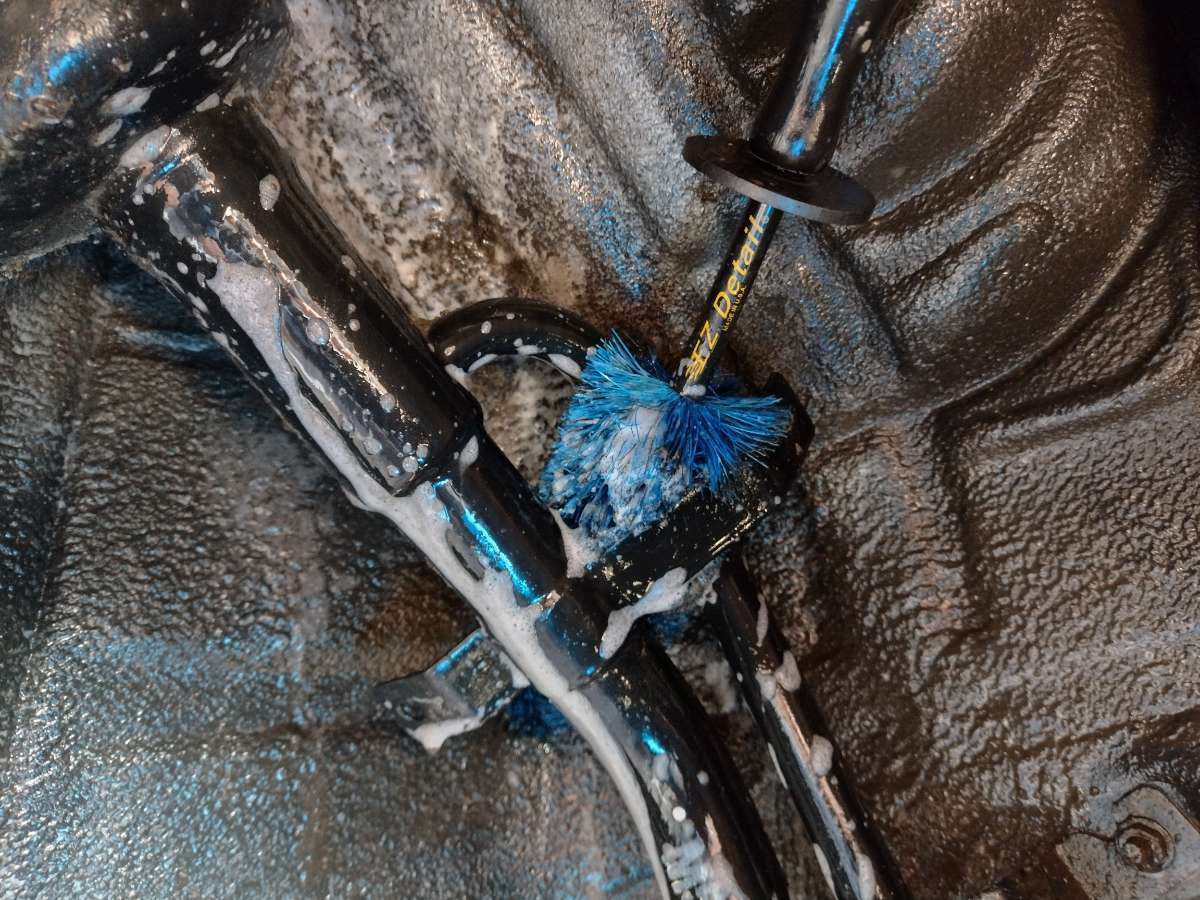

Thorough cleaned up of all the old crud, plus the wheels and spacers haven't been on the car for 2 years so probably added to the corrosion of the grime. Of course cleaned the wheels after removal back in 2020, however neglected to clean the all important boss.
Threads de grim'd also
Reassembled, went out for a spin and clicking gone, completely quiet. Couple of drives to make sure all was well, prior getting a wheel alignment.

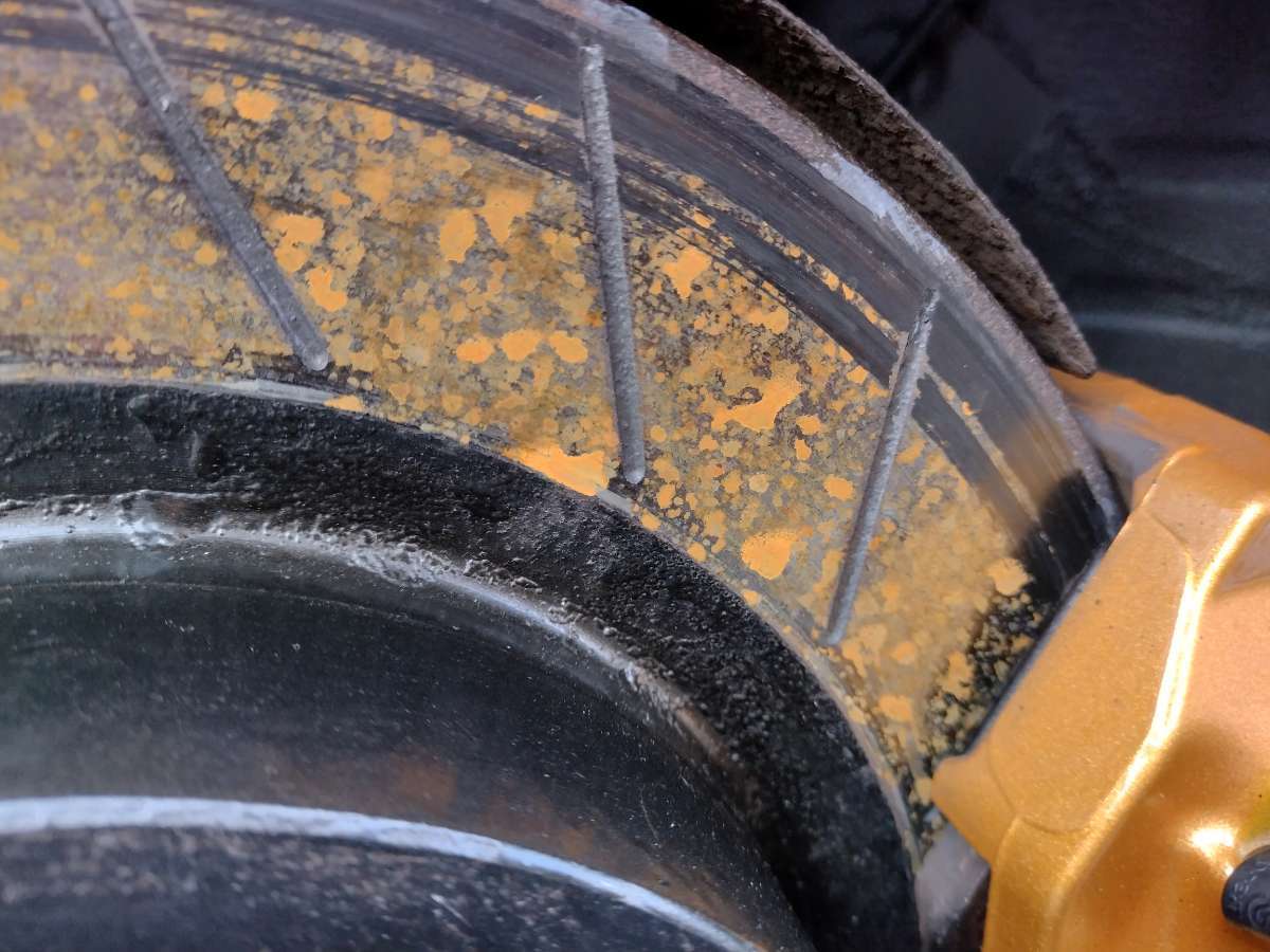

The rusty grooves on the discs needed attention. Bilt Hamber Hydrate 80 turns black after curing, not sure how it'll deal with the heat if at all but only one way to find out. Discs were sanded prior to fitting wheels.

Been a week or so and up she goes to do a final check over of the underseal as you can't really gauge coverage on the day of application. Few small areas needed a go over, however thus far I'm pleased to confirm that after a short drive the idea for the brake discs grooves work.
You can see they are fairly well rusty as per usual after a wash and yet the grooves are still black. A longer drive needed to fully clean up the discs, but so far I'm impressed.
