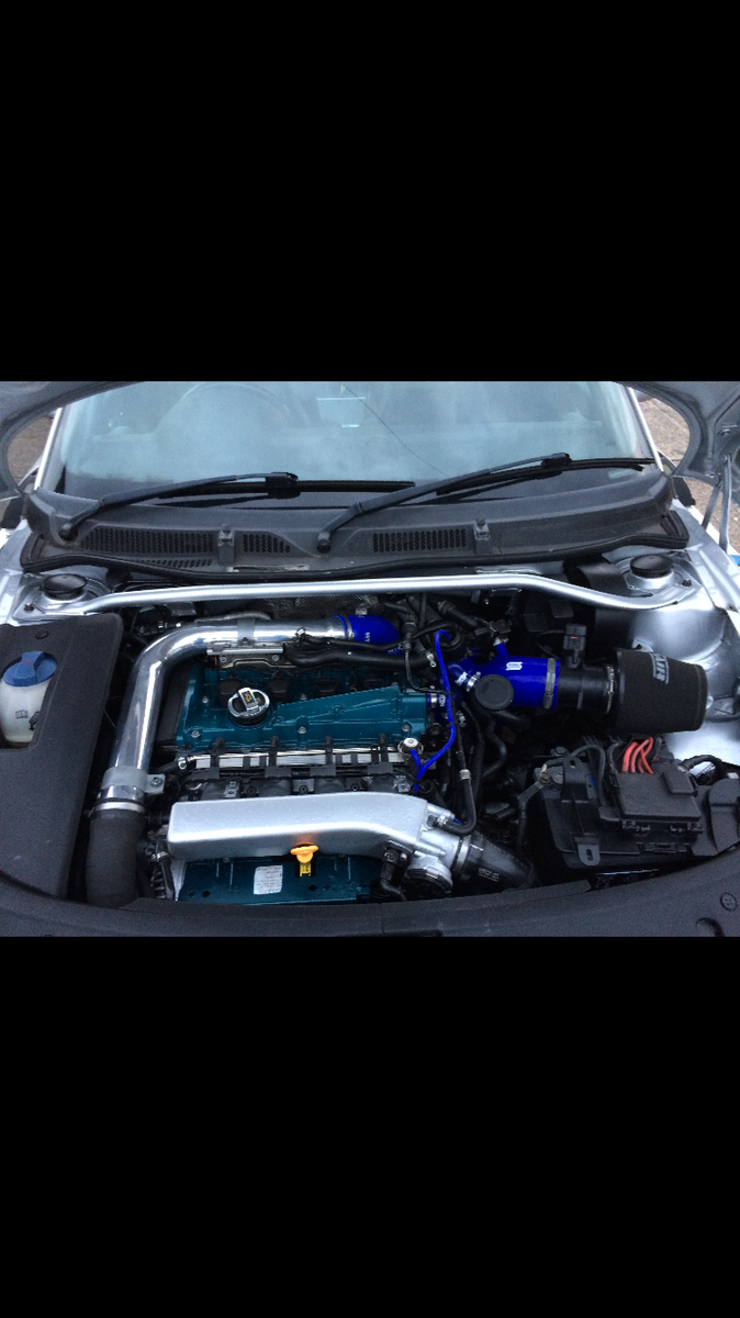

350 bhp Audi TT mmmmm :)
All those mods but no engine internals, I had one of these about 7years ago, done a few power mods & a revo re-map, 282hp & within 1k busted a con-rod & ended up having to re-build, with custom pistons & bored out block.
Do the math, 1.8 - 350bhp
350 bhp from a 1.8 is fine if done right!
My last bike had about 120 bhp from 600cc and it was NA. Road bikes (with sensible service intervals) can have 200bhp per litre now and remain reliable. They are done properly though! :lol::lol:
Those 225/210bhp 1.8 engines will take an absolute max of about 300ft/lb's through the rods before they start to go bendy. I used to have a leon cupra r and quite a few people bent/snapped rods on the standard or hybrid turbos running 300ish+ft/lb.
looks like $hit
nice power output
