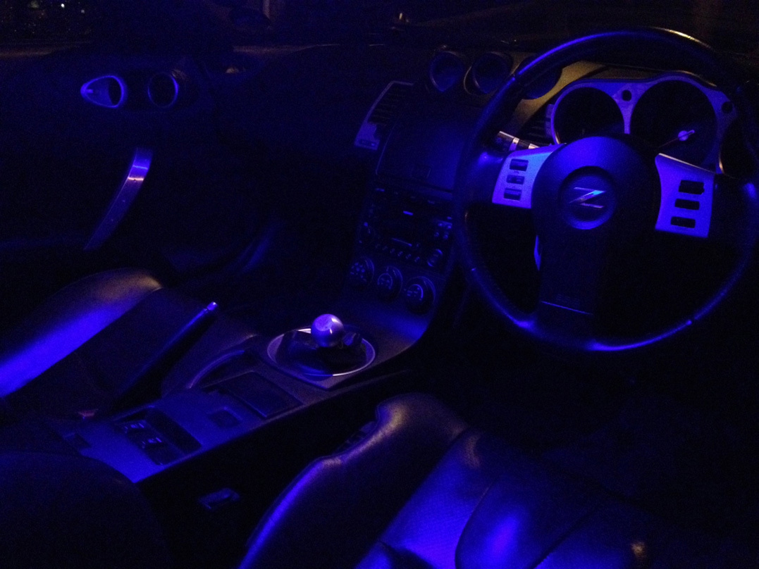

KyleR Posted April 20, 2012 Posted April 20, 2012 That type of festoon bulb won't fuse, it's just the one's that have a metal square in the centre part where the bulb is that MAY fuse. I have 12 led festoon bulbs in the dome light, but the led's are mounted on a circuit so no risk of fusing. The led's act a little different, they appear to dim slightly then switch right off, unlike the standard bulbs that dim right the way down. Quote
FUG Posted April 21, 2012 Posted April 21, 2012 nice.. where did you get your blue LEDs from? are they technically illegal; do you know/show use only? im not too bothered just curious, its easy to just turn off as and when to avoid the old bill if necassary Quote
KyleR Posted April 21, 2012 Posted April 21, 2012 I got them off eBay http://cgi.ebay.co.uk/ws/eBayISAPI.dll? ... 086wt_1112 As far as I'm aware they are legal, as I don't think there is any legal obligation to have dome lights in the car. The only legal issue I'm aware of regarding interior lights is that they must not be switched on when driving. Quote
