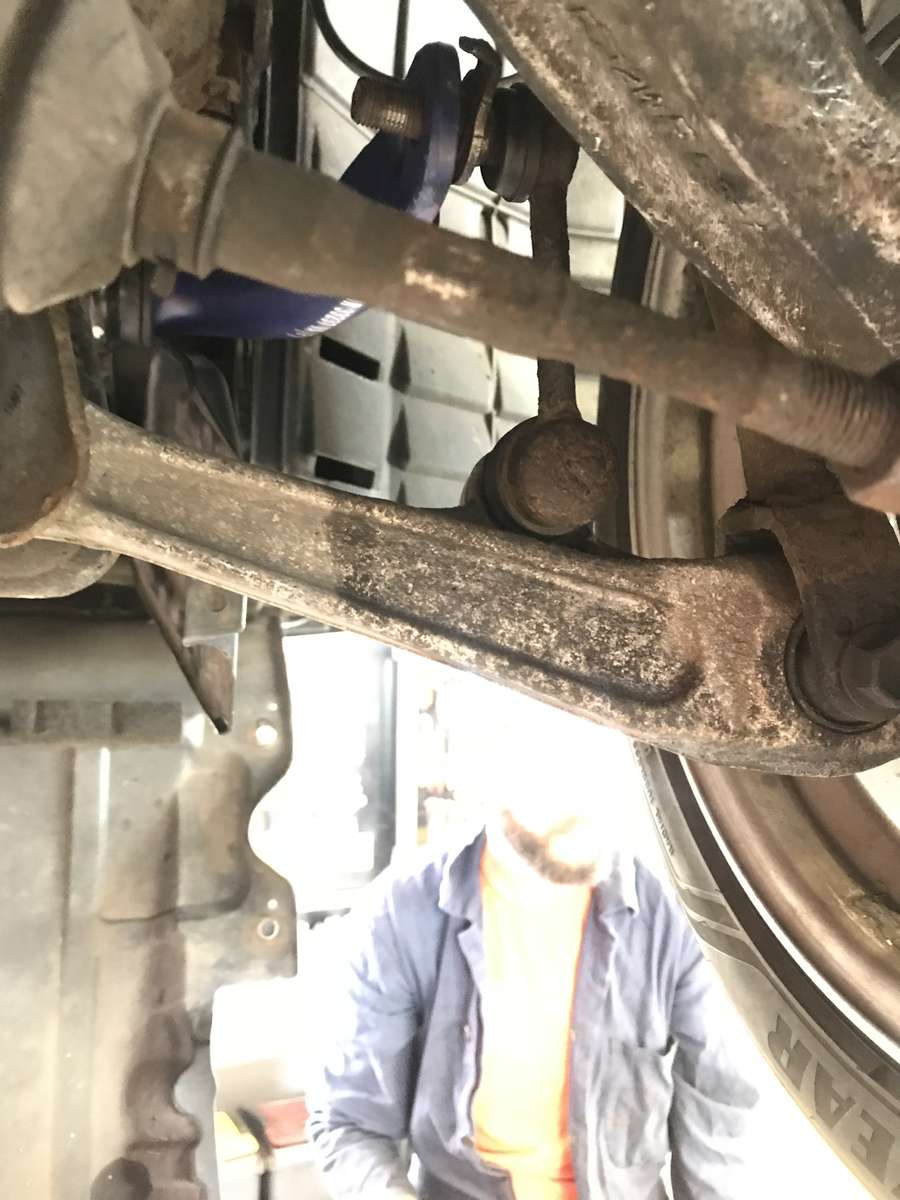

Bosch Posted October 12, 2018 Author Posted October 12, 2018 A little bit of an update... So after a day at "This is your Garage", which I would like to say is a fantastic little business, I didn't really achieve half as much as I expected I would. Richard was a real help and offered advice along the way which was really valued given this was my first time working on a car in any meaningful manner. It'd be great if there was one a little closer to me as it was a painful 2 hour drive in stop start traffic getting there for me. 13 years worth of rust made getting some of the nuts and bolts off a real challenge. Progress was slow and so we revised down our aim for the day and settled for replacing the W Brace and fitting the front and rear sway bars. A quick tip for anyone doing swaybars (it's probably been covered before), but if your droplinks have never been replaced, make sure you do it. Mine were a dog to get off and without replacements, I had to drive for a week with a horribly loose feel and a loud clunking over bumps in the road as my old droplinks went back on. Fast forward to this week and having determined a 4 hour round trip, plus a full day working on the car to get the Meister R's fitted wasn't going to work for me, a trip to Tarmac Sportz saw my Meister R's fitted together with some new Whiteline droplinks. I know they'll settle over the next few days, but already the feeling is night and day! The service from Chris and Bob was exemplary - Bob even followed up with a call this morning to check in on how they felt on the drive home. Car is currently in for a 4 wheel-alignment and then fingers crossed my drive down to Bournemouth tomorrow should be fun, with everything feeling spot-on. Quote
Bosch Posted October 14, 2018 Author Posted October 14, 2018 Some pictures of rusty ass braces and droplinks and some replacement parts Quote
