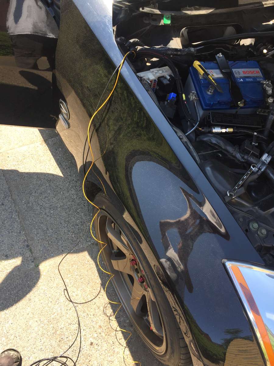

Ortega_9 Posted June 1, 2018 Author Posted June 1, 2018 Getting started on the wireing for the new pump. i drew two wires from the engine Bay. One 4mm2 for power from the relay switch, and one 0.75mm2 for the relay coil. will be using the "old" power suply from the pump as the power for the relay coil. and also Grounding the pump with a 4mm2 cable. having drawn the wires, and cut them to lenght, i put a "sleeve" over the wires and put it through the original wireing brackets under the carpet down the side. taking the fuel pump connector apart and both crimping and soldering the new power and Ground wire to get the Best connection. Quote
Ortega_9 Posted June 1, 2018 Author Posted June 1, 2018 Connector done, and power for pump and relay runs in the cableholders down the side. trying to find the Best place for the Ground lead, needs to be short and in a chassis bolt hole for the Best connection... Quote
Ortega_9 Posted June 1, 2018 Author Posted June 1, 2018 Ground wire hocked up to a threaded hole just behind the strut brace. Relay and fused suply hocked up. and done! all there is left on "the list" now, is redooing the fuel hanger..... 1 Quote

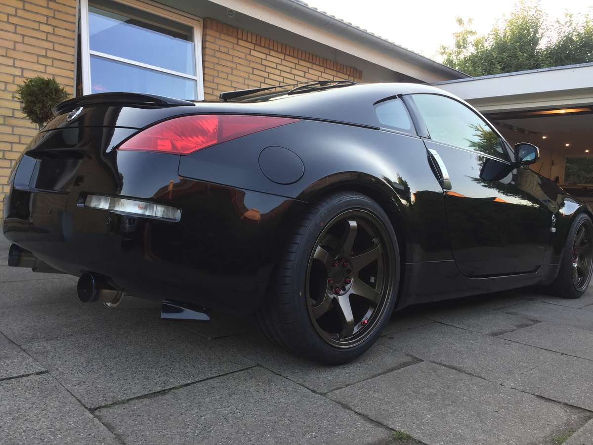

Ortega_9 Posted June 2, 2018 Author Posted June 2, 2018 After over a year of beeing on jackstands, Dusty and disasembled... it's sometime hard to remember why you do what you do... But when it's all back together (apart from the Carbon body parts) and you wash it again, it's pretty clear why. 4 Quote
