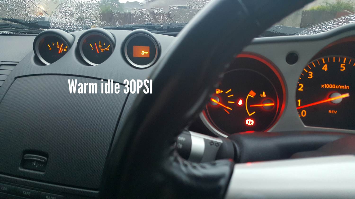

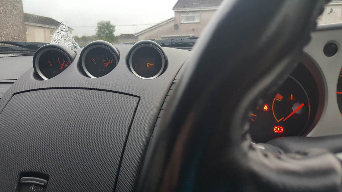

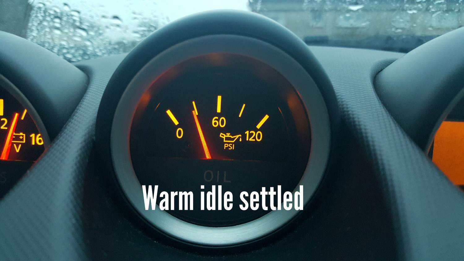

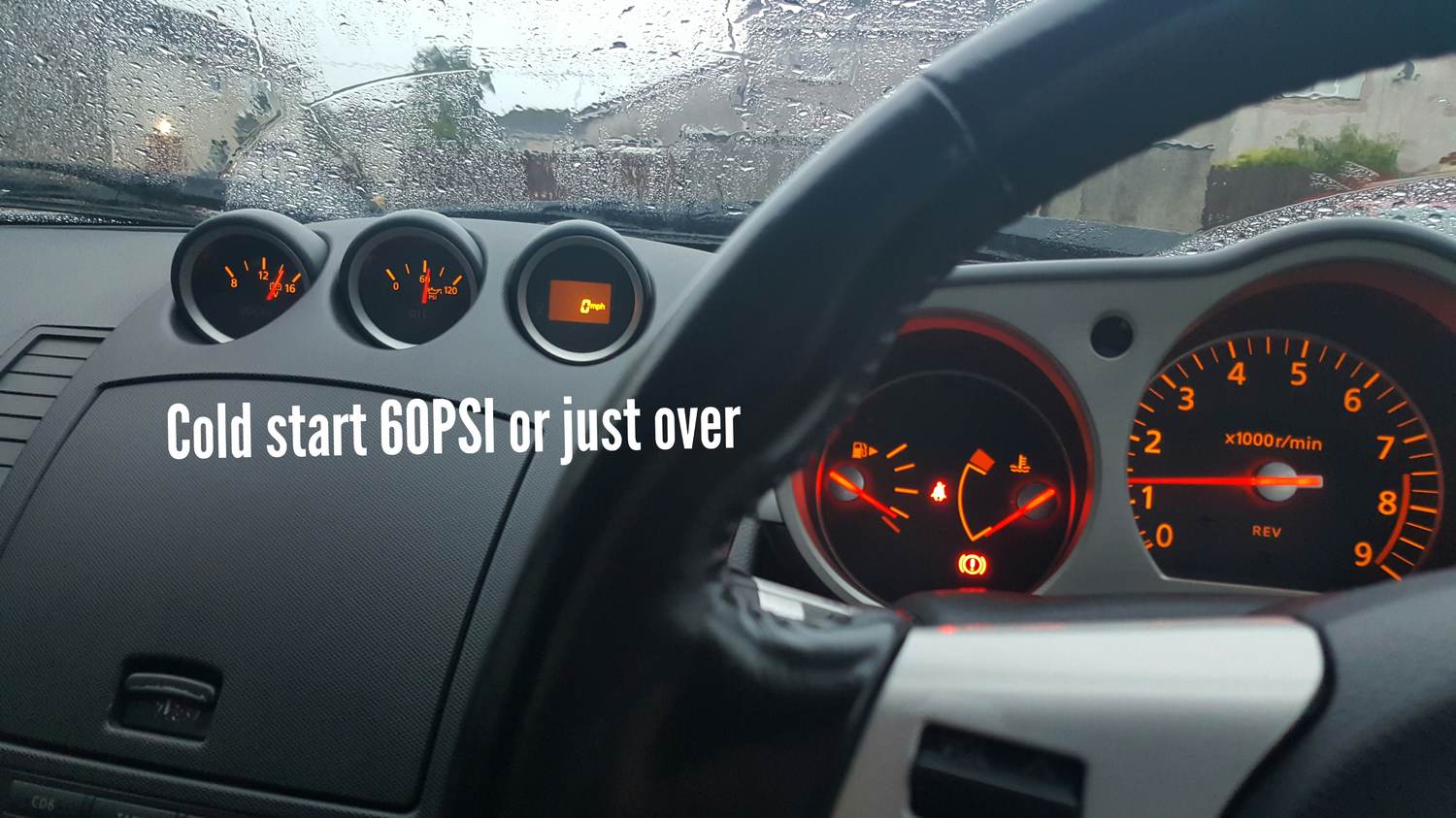

Before the work was undertaken:
After the work was undertaken:

Just went out to try mine... I take it were good at these readings? (worrying look on face) 60psi cold start then settles at warm idle of 30psi? (After leaving it for a bit it goes behind the 30 but I take it from the comments im good up until its at 15 half way?)
A bit confused what it should be for each scenario.. should it be right at the top for a cold start and be over 30 at hot idle?

All things being equal, slightly more warm idle pressure means more resistance ie less power - less pressure means less resistance, means more hp.
Factory warm idle is circa 15psi *correctly working sensor.
A warm/hot idle should be 30psi plus. Below that you almost definitely have a failed gasket of some sorts and should start budgeting for a replacement when you can. Below 15psi you should probably stop spirited driving and take it to a garage asap as you could be starving the cams of oil and your gasket will probably habe deteriorated.
You dont take the engine out as one person mentioned before but you do take the front off so it's not an easy job for a home mechanic (unless you seriously know what you're doing)
You're looking at 6-8 hours labour (mine was 7.5 as it was the first HR they'd done) and around 200-600 in parts depending on what you change. I had everything changed except actual timing chain as it wasn't stretched but it could have been with such low oil pressure so was a nice surprise when my bill was a bit under the quote.

I tell a lie...the rest is correct but the cold start wasnt a proper cold start....started it this morning and took a pic starts off at near 120 then settle further down to 90 and then so on.
