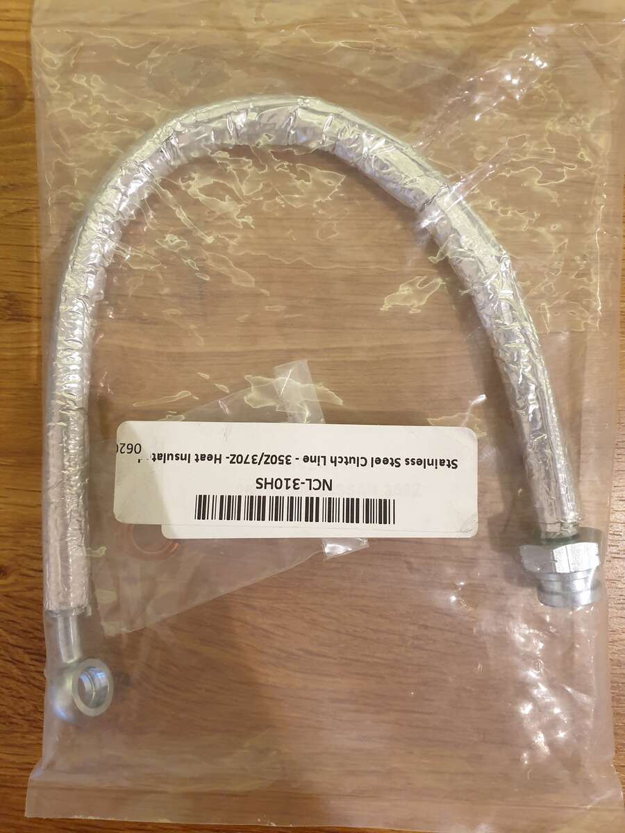

nissanman312 Posted August 10, 2020 Author Posted August 10, 2020 (edited) Changed out the clutch master yesterday with the expert help of @350Butcher as the fluid was looking crap even after the new slave and lots of bleeding in hindsight I should of put it on when I had the clutch fitted as the system bled up perfectly after Either way its done now Z1 sent. Me the wrong cluch line tho so I have one for a de if anyones after one Edited August 10, 2020 by nissanman312 1 Quote

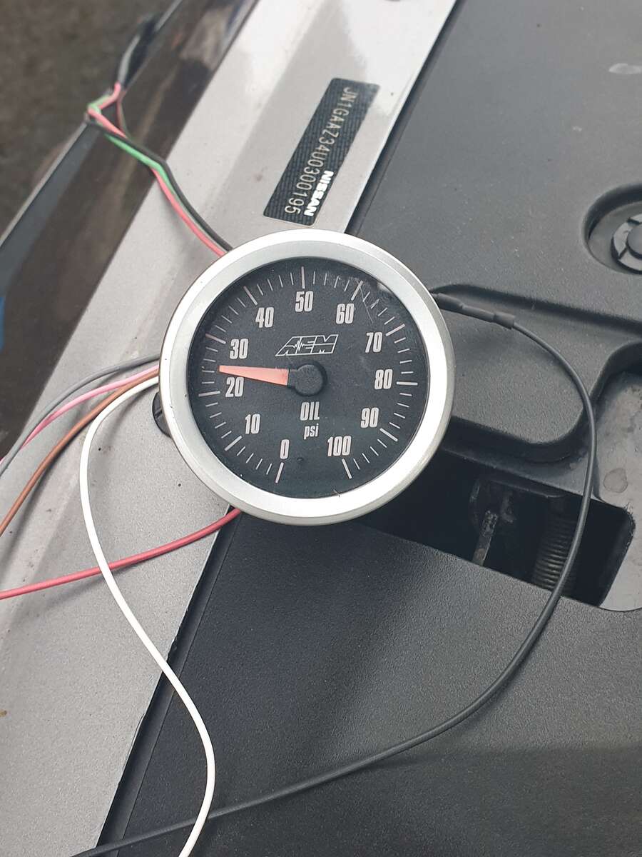

nissanman312 Posted December 22, 2020 Author Posted December 22, 2020 Little bit of maintenance today Changed the oil again only done afew thousand but at least its ready for spring And I wanted to check the oil pressure to see if there's and sign of gallery gaskets I know its not a definitive answer but there's good presure there so im happy for now The engine may get forged at some point to push the new supercharger kit so there's no point me doing gaskets now if the pressure is good I've got 25psi at 80 degrees i think nissan state 14 psi is the minimum so we're good for now hopefully 2 Quote

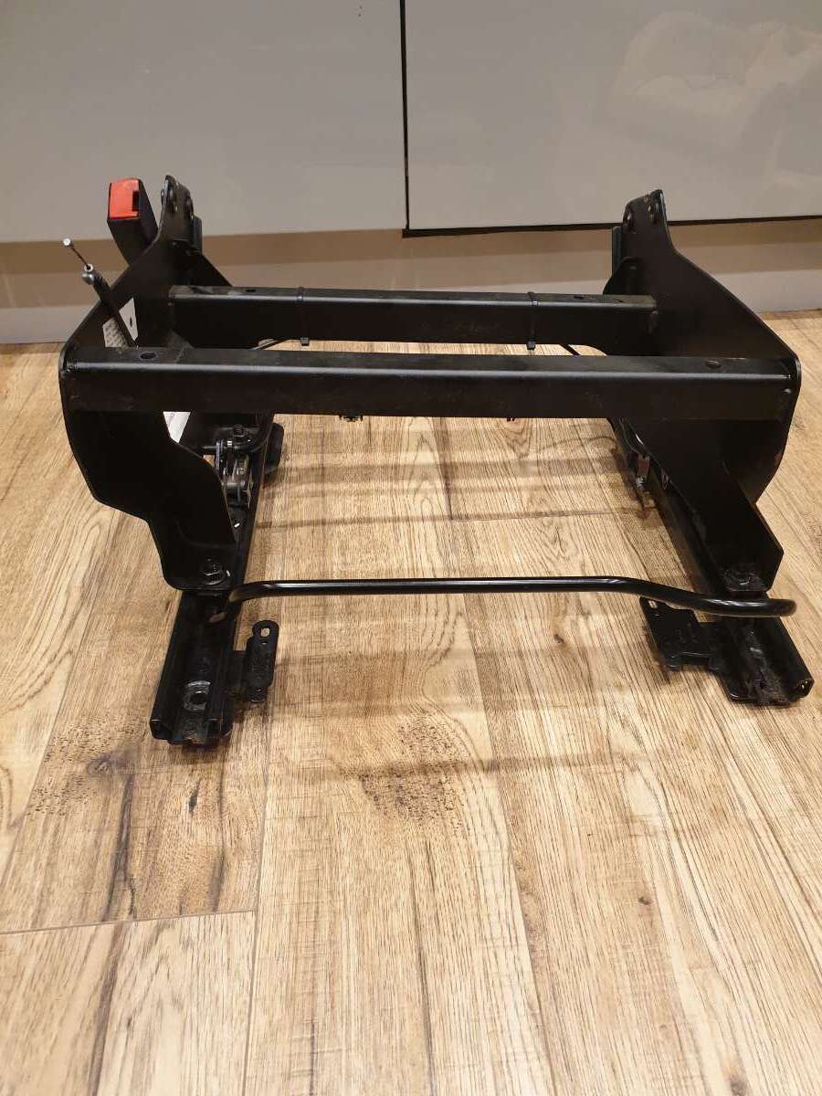

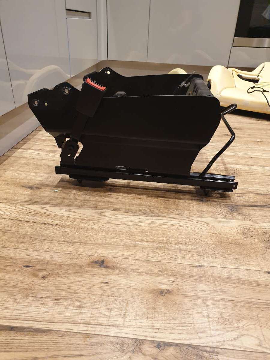

nissanman312 Posted February 20, 2021 Author Posted February 20, 2021 One seat stripped down ready for the new alcantara covers to arrive The large frame pictured is the clio frame removed and the small frame is what you need to make the seat whole again and ready to accept your specific base frame /rails After a little look it seems the air bags are intact so no issus there either 3 Quote
