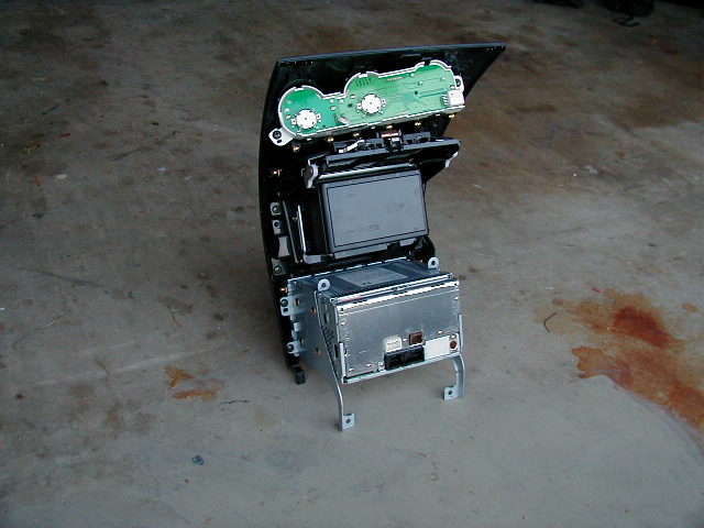

The stereo is held in to the centre console via 4 screws in the side, Its best to get the whole console out then undo the screws, but you can do it by leavering it forward.
The thing I had issue with was getting the the metal feet (shown at the bottom of this picture) out from behind the white plastic thing. I had taken out the screws that go into the holes but it was still hard to get out. I think you've got the same problem. You need to loosen the screws that hold the white box in to give you more wiggle room.
I think you need to play around with these screws. Each picture is from a different model US at the top, UK (non HR) at the bottom. Hopefully yours is similar.

The white box is the worst part of the whole thing, it really is a faff to get it out.
I'll go through and slap some numbers in the steps to make it easier
Yep, took me 5 mins to get it out and 30 mins to get it back in. Such a ridiculous shape/angle of attachment.
