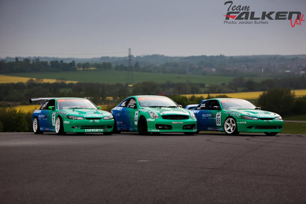

Sorry guys, not had the time to update this!!!
The car has now been finished for a few weeks!! Made 607hp and 615ftlb with a premiture rev cut at 6200rpm and 1.6 bar, once the cut is sorted it will be back on the dyno and clear 650 easy at 1.8bar, maybe 700 at 2 bar ;)
Please look here for the rest of the updates iv missed here
http://www.driftworks.com/forum/drift-car-projects-builds/124180-team-falken-uk-650hp-v35-skyline-g35-37.html
