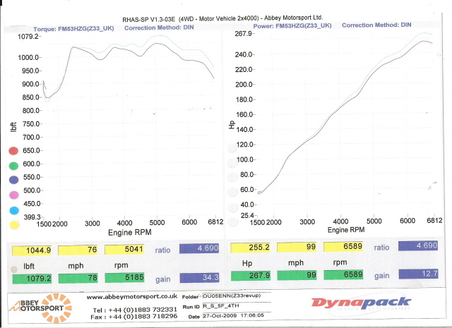

Mark@Abbey m/s Posted November 11, 2009 Author Posted November 11, 2009 UPREV remap on 296bhp car REVUP spec Motor was rebuilt a few thousand miles ago, car has a Nismo exhaust and Y pipe fitted BLUE dyno plot std motor fitted with Nismo exhaust and Y pipe STD air box GREEN dyno plot std motor fitted with Nismo exhaust and Y pipe STD air box + UPREV remap raised the rev limit by 100 rpm, lifted speed limiter to 180mph. Throttle map set up to allow throtle to be opened 100% in all gears. This car can have multi maps. As per information I have gathered it is apparent that the REVUP motor lacks a little in mid range torque agaisnt other 350Z motors even with a remap we cant regain a lot of torque , as normal we can smooth the torque/bhp outputs , also gain a few LB/FT and BHP. any questions feel free to ask. Cost for reflash is £345-00 inc vat , this includes an hour to tweak the map for your car. Quote

Chris`I Posted November 11, 2009 Posted November 11, 2009 Good work Mark, nice to see some of the rumours about how the car performs with various mods and engine specs is acutally quite accurate. Will be interested to see how you get on with the MREV2. I beleive it is meant to drop a few HP top end but gain you more in the way of mid range torque Quote
Mark@Abbey m/s Posted November 11, 2009 Author Posted November 11, 2009 Yes it funny Nissan after developing the extra valve control on the Revup motor have actuualy made a engine that has less torque than the early DE motor but they do rev on far better. Such a shame a cam change is such a huge job , would be good to fit some cams in a Revup motor to the same spec as a early DE motor and then play with the cams maps. Lots to still do, had a play with a DE 276bhp car yesterday with a few more mods on the figures where very very good , should be posted up on here very soon. Quote
