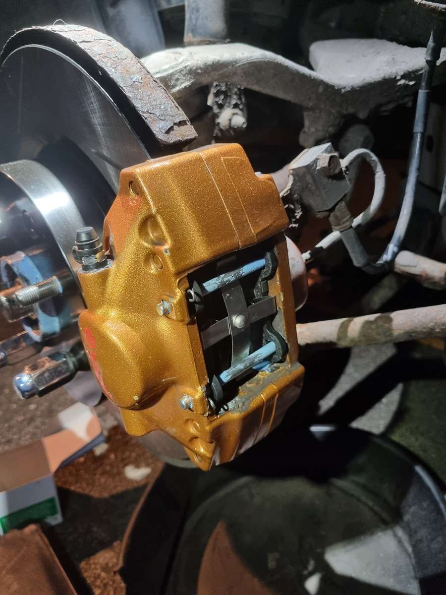

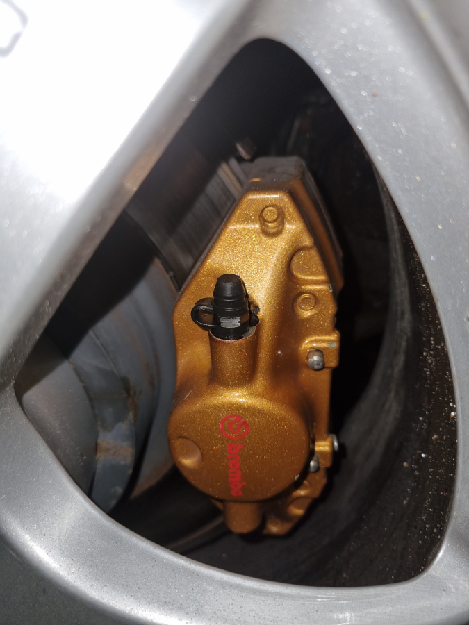

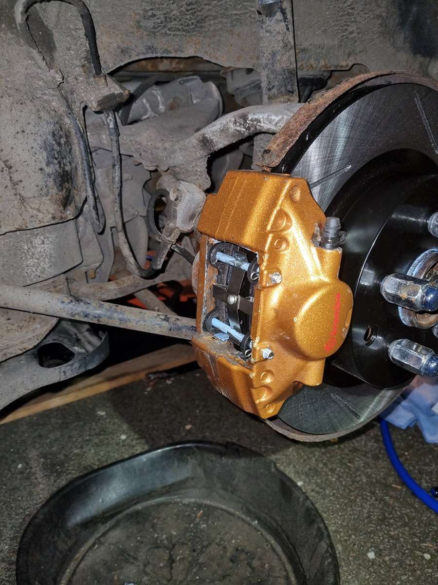

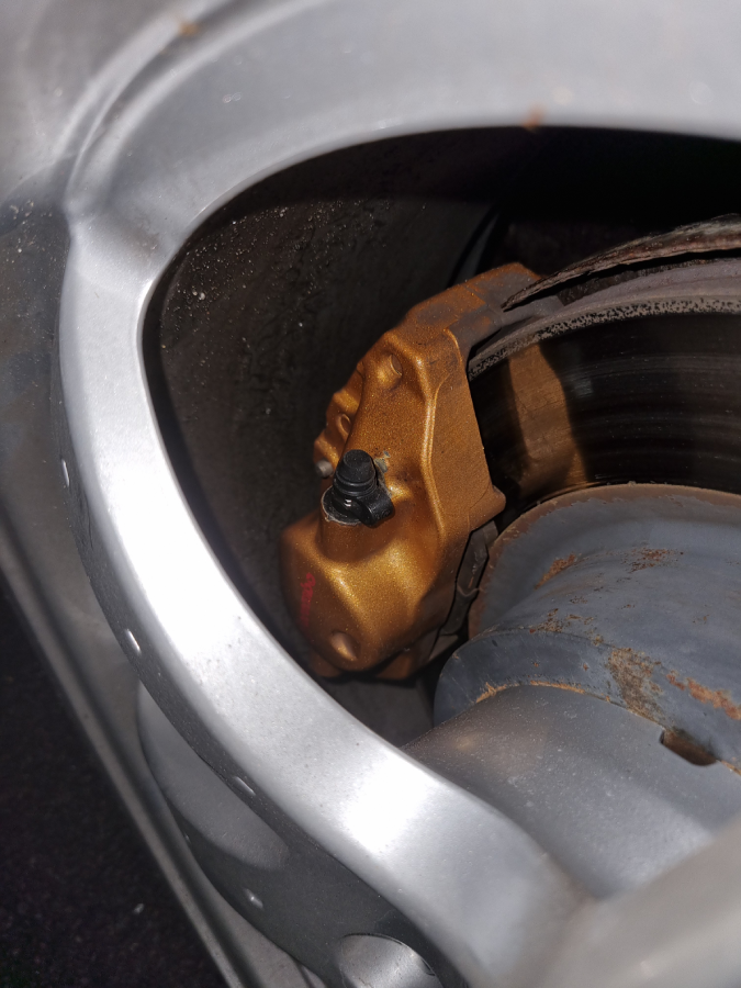

Finally got the calipers sorted so I can actually change the brake fluid now. The four stuck bleed nipples were no match for the power of welding. Also, got the Berk HFC's fitted, sound clips coming soon!
Welding trophies
Fixed calipers
Lovely patina finish
Edited by polaris

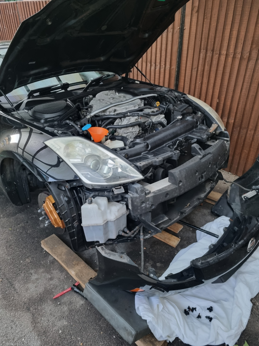

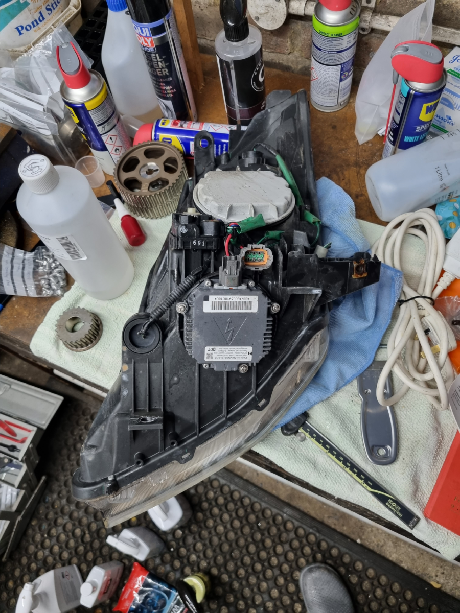

Noticed some condensation inside the P/S headlight so I got to work. Replaced the actuator seal (bottom of headlight) and the main cover (rear of headlight; disc shaped) on both headlights. Off the back of a recommendation from @Olly350z, I put both headlights in the airing cupboard overnight which worked a treat. The moisture had completely evaporated from the P/S headlight when I checked it the next morning. I should've taken an after photo but it just looks like a stock headlight now 😆
It's a bit of a mess in the garage at the moment; I've been wrenching away on my new Cappuccino.
Front bumper off
Headlight
Replacing actuator seal
Replacing main cover

Glad the old airing cupboard trick mate, I'm sure with the new seals that should be the end of your condensation issues. Been such a wet winter we've seen alot of dry cars coming back in with condensation issues.
You could always put a silica pack in the offending unit in the future should it come back

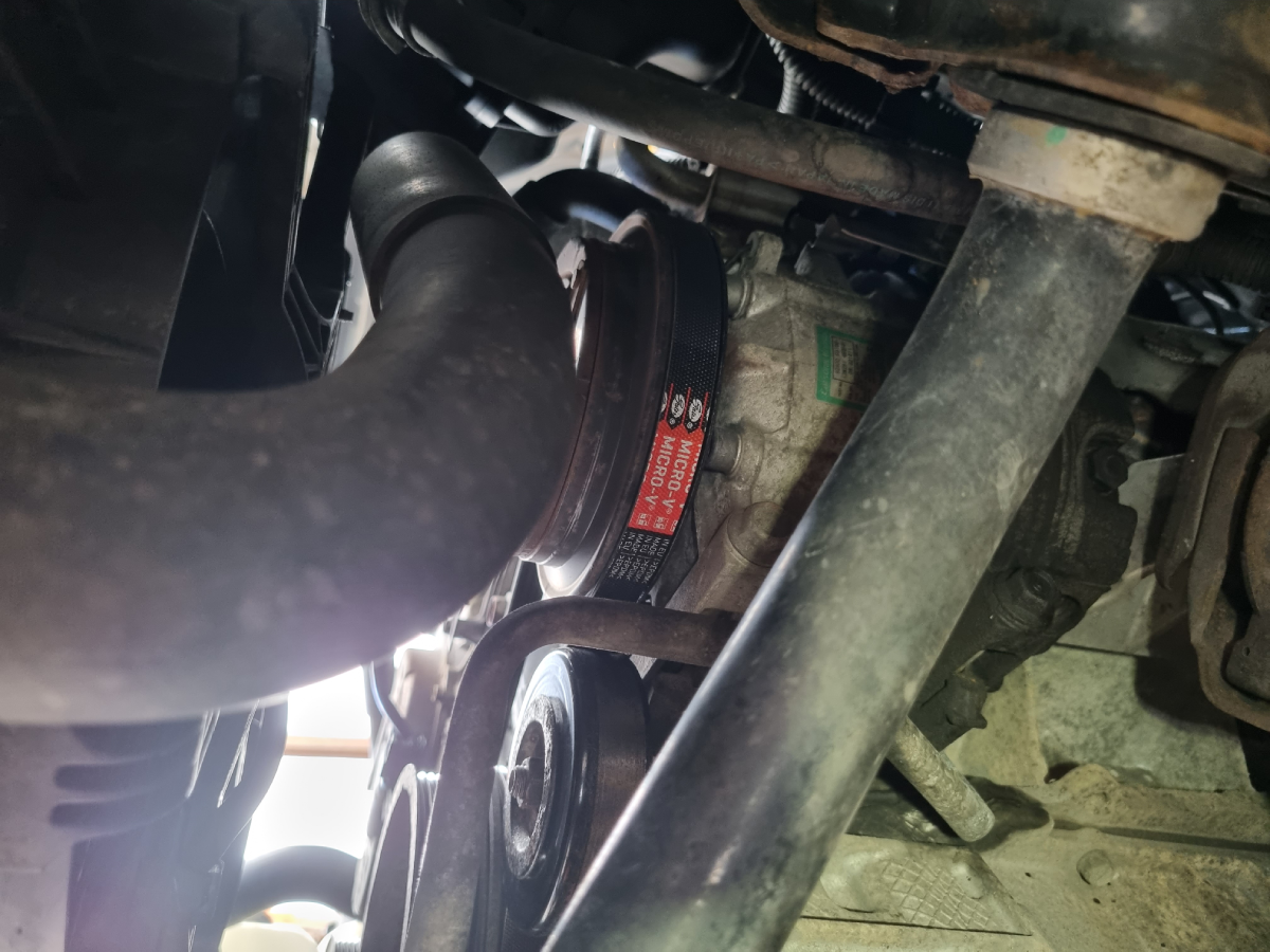

First, the A/C belt split right down the middle. I think the tensioners are worn but I didn't have new parts to hand so I cleaned them up the best I could. Replaced both belts with Gates. I'll also replace both tensioners soon.
Split A/C belt
New dual-channel belt technology
Gates belts
All fitted
Nice and clean tensioner

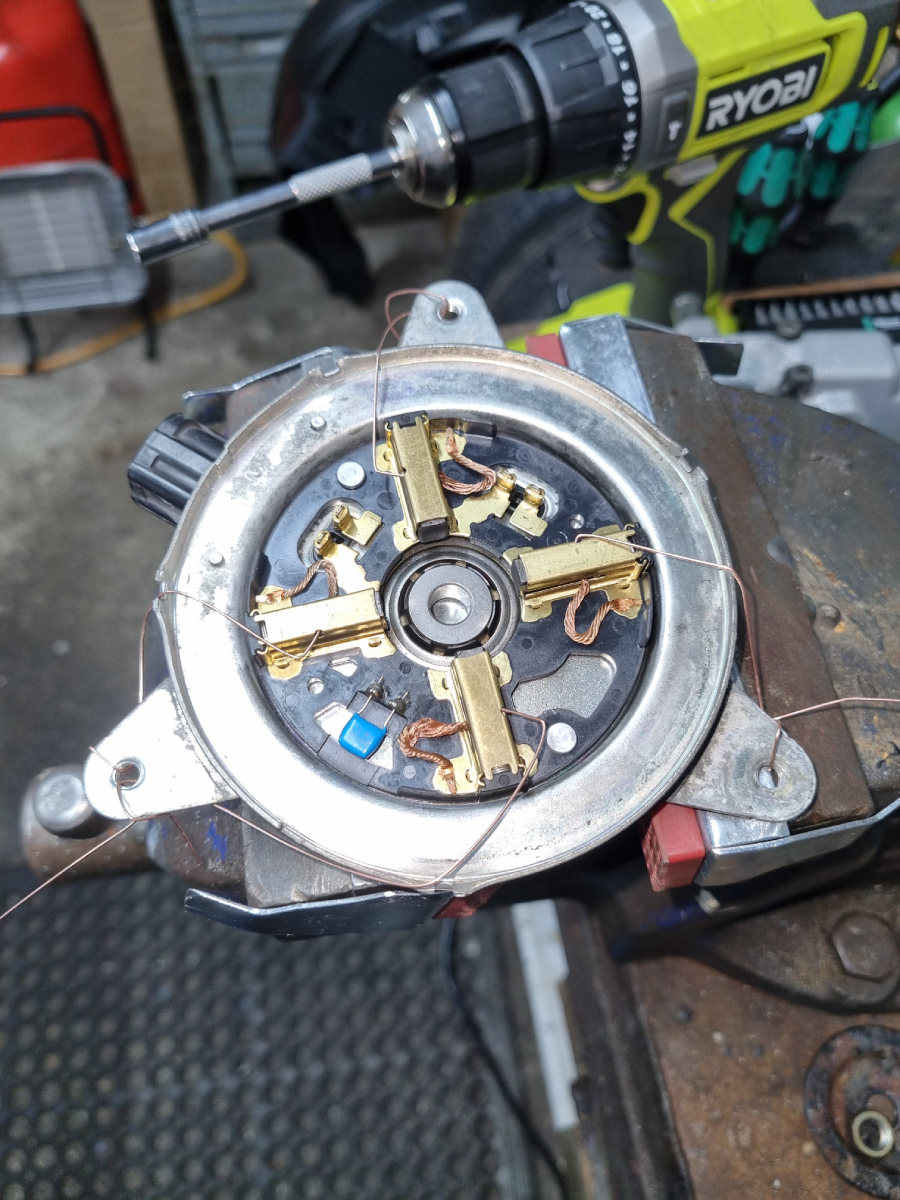

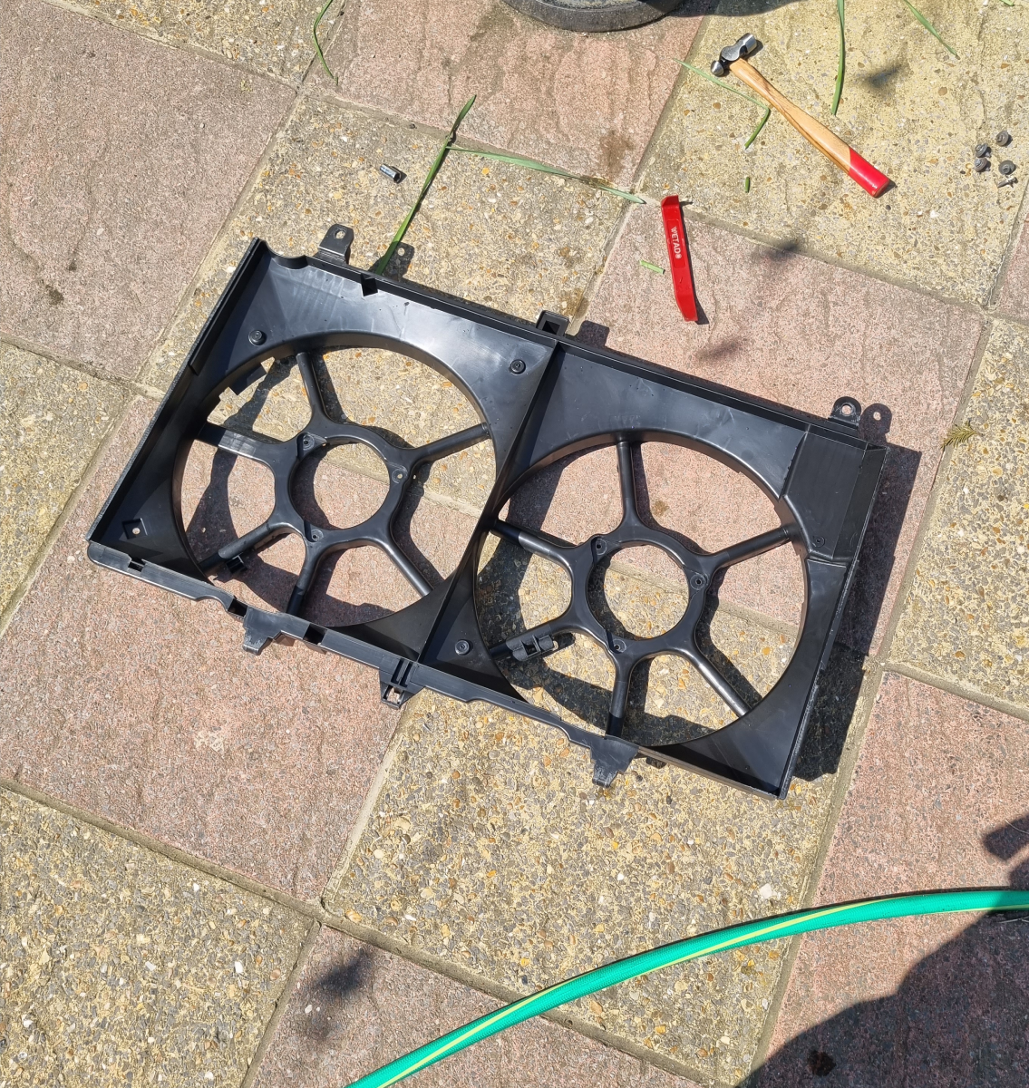

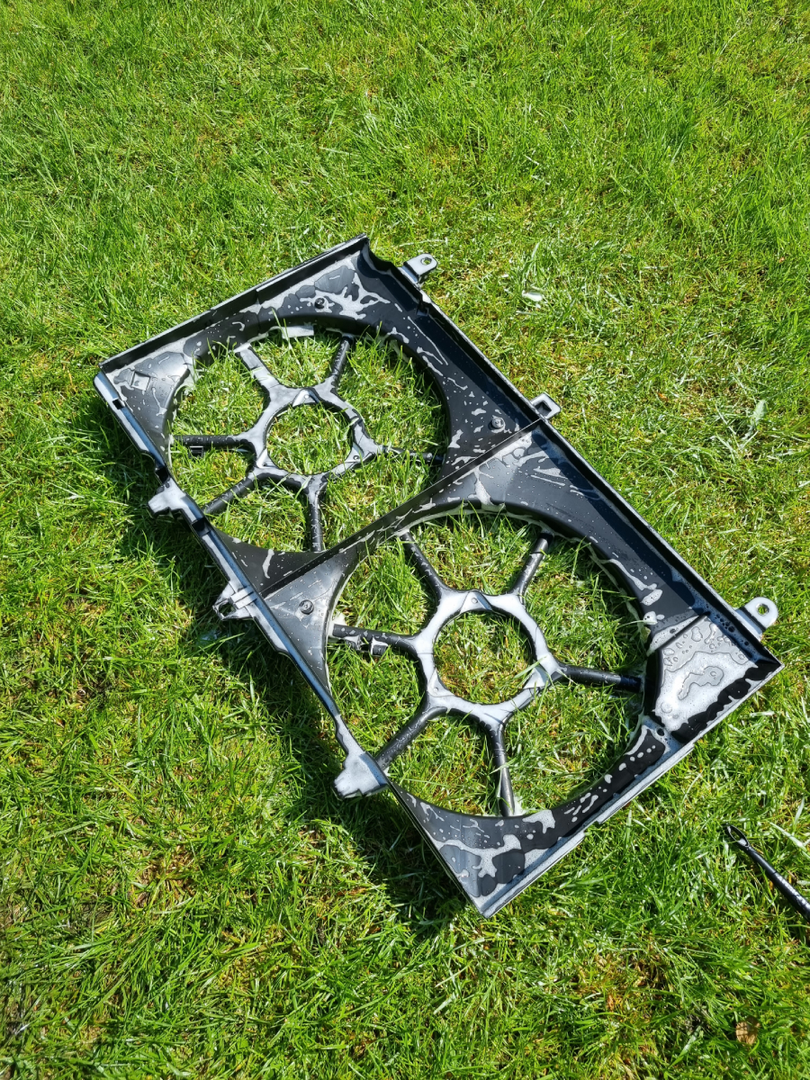

Second, I noticed the P/S radiator fan wasn't spinning and the D/S fan was a bit slow. I followed the forum guide to fix them but to no avail (funnily enough, the D/S motor stopped working and the P/S motor started working). Nissan wanted something ridiculous like £250 per motor but you can get near identical replacements on eBay for £40. The only negative I found was that the wiring is slightly longer.
Failed fix attempt
Cleaning the radiator shroud
Spotless
OEM Motor (left) vs eBay motor (right)
New motors fitted

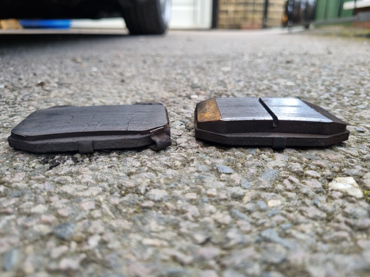

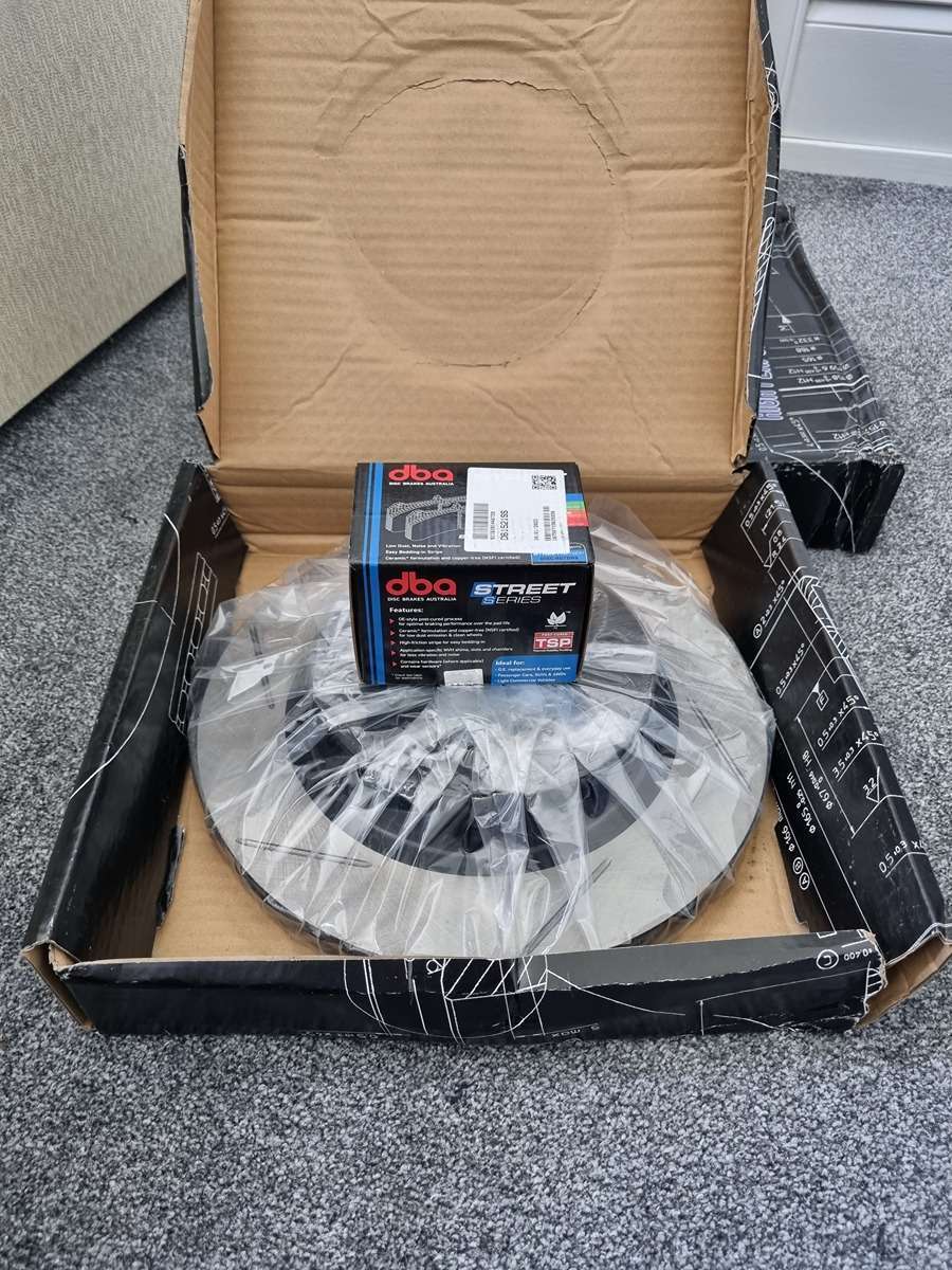

The wear sensor on one of the D/S rear pads started grinding against the disc. I then realised that they were the OEM discs from the factory! Quite a large lip had developed from the many brake pads over the years so I knew they had to go. I don't like taking half measures so I went with some nice StopTech slotted discs and DBA pads from Tarmac Sportz. I also bought new calliper hardware (pins, cross springs & clips) from TORQEN.
Big thanks to Chris @ Tarmac Sportz. He sorted me out with a great deal on short notice.

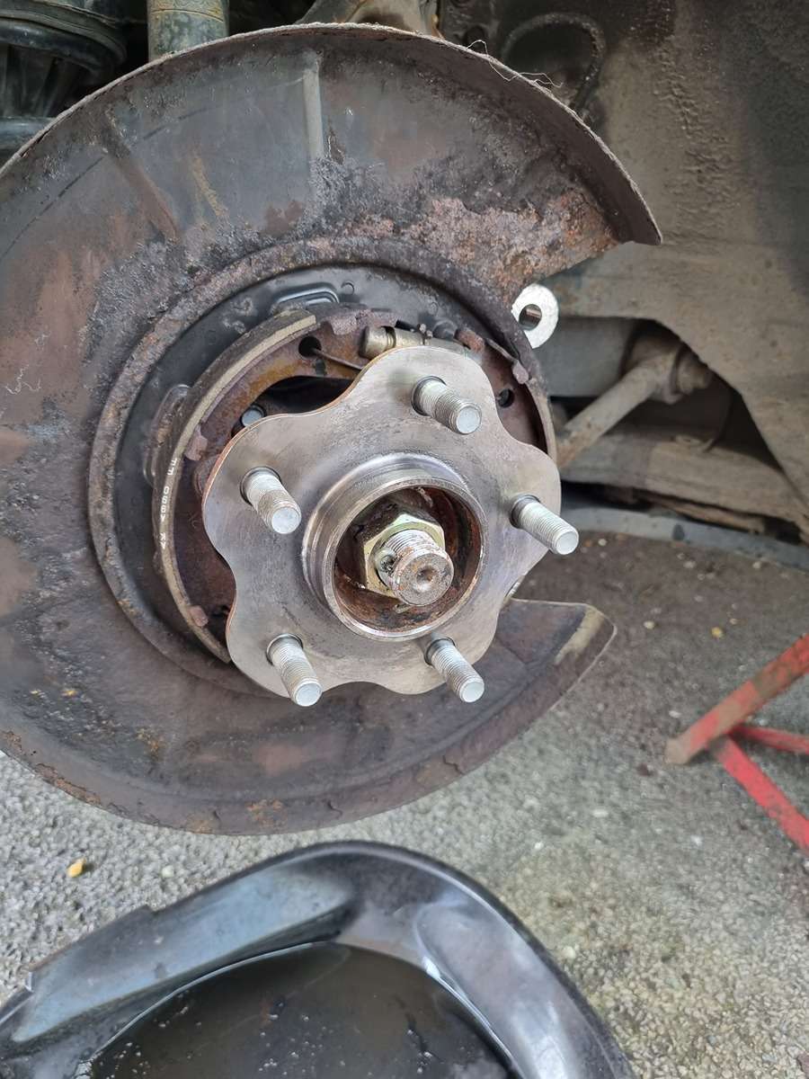

All 4 brake dust shields are crumbling away. I plan to powder coat some new dust shields so they should last much longer and look the business.
Products
StopTech Slotted Discs (ST126.42079SL+R)
DBA Street Pads (DB1521SS)
Liqui Moly 3074 Anti-Squeal Brake Paste
Liqui Moly 3318 Rapid Brake Cleaner
Brass & steel wire brushes
Dremel 442 carbon steel brushes
StopTech Slotted Discs & DBA Street Pads
Products

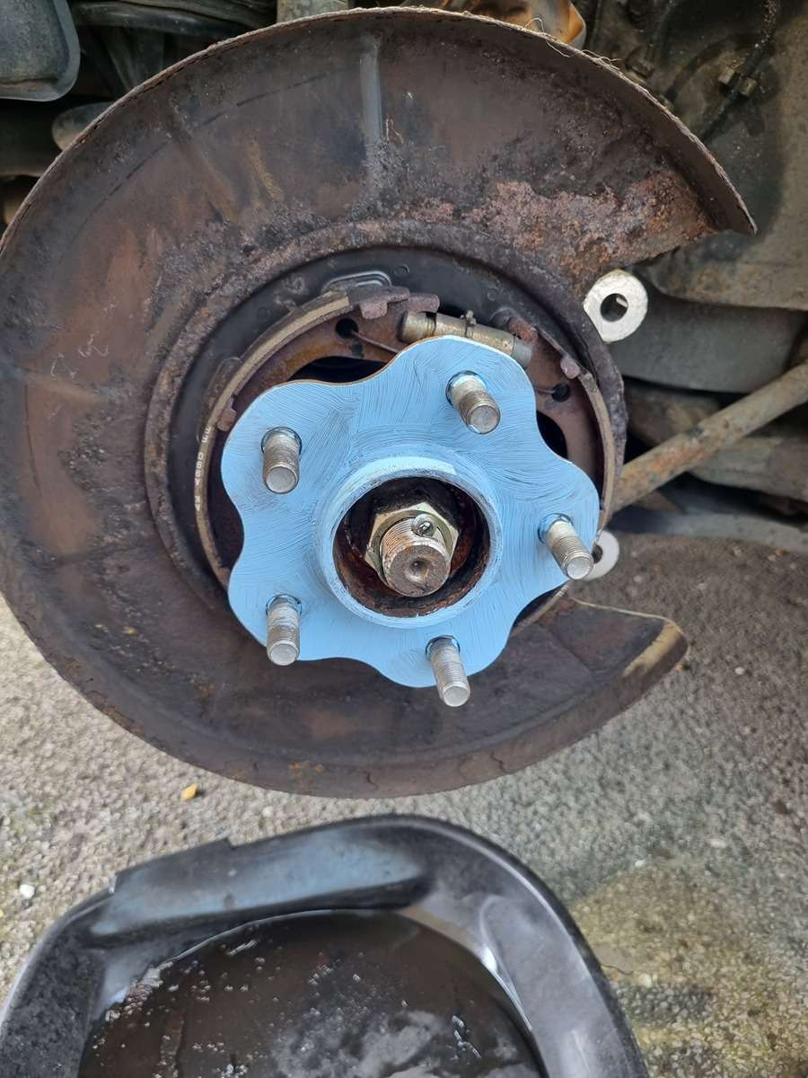

I assumed the contact point between the wheel hub assemblies and discs was going to be pretty rough. Bought some brushes and carbon steel Dremel attachments to get them back to clean and shiny.
The beginning
Old D/S Brake Pads
Either one brake pad was replaced and not the other or maybe it froze it place? Possibly the previous mechanic didn't properly clean, prepare and grease the pads?
Old P/S Brake Pads
Same story. Could one of the calliper pistons have seized up? I'll keep a close eye on the new pads.
D/S Wheel Hub Assembly
After cleaning
Liqui Moly Anti-squeal brake paste
Disc & calliper back on
Brake pads in
P/S Wheel Hub Assembly
Cleaned and lathered up
New disc on
Same as D/S

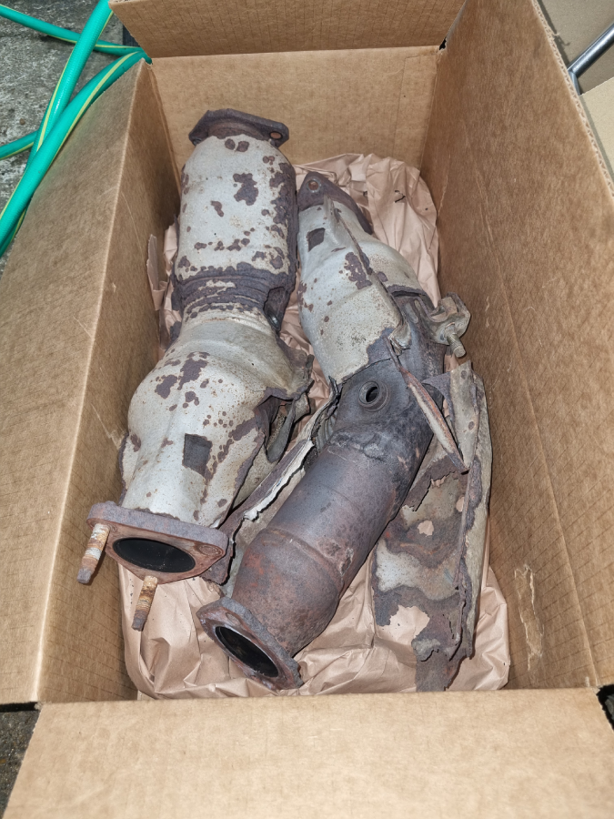

Replaced all the exhaust mounts and gaskets (obviously not pictured). Nissan OEM mounts and original Milltek 3" gaskets to go with 8.8 zinc-plated bolts. Pretty sure I had a minor exhaust leak on one of the gaskets.

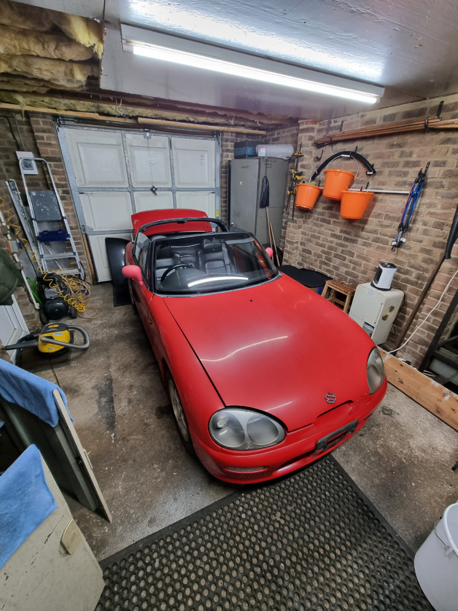

My true ground-up project, a 1995 Suzuki Cappuccino, all stripped down in preparation for sandblasting early next year.
