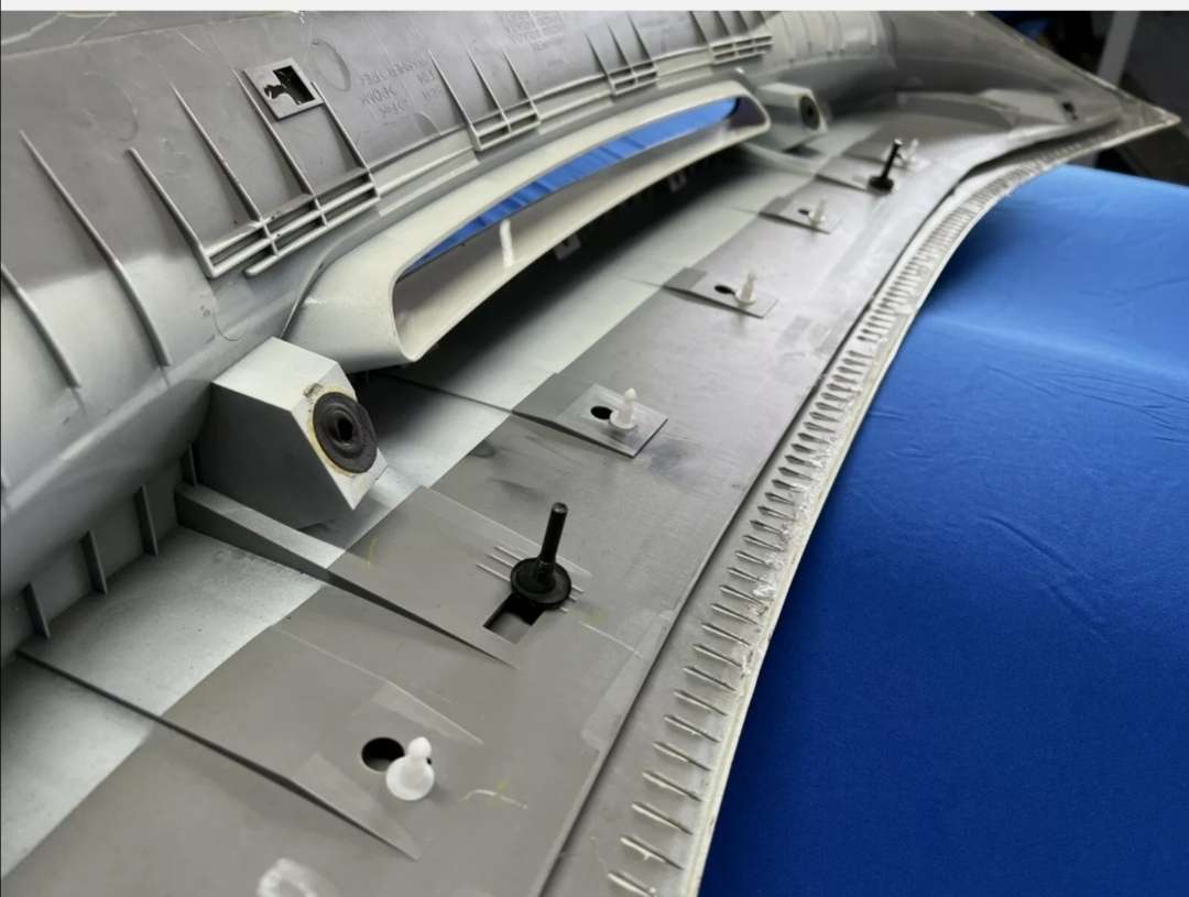

Willsy1980 Posted January 14 Share Posted January 14 Sorry to revive this old thread, but this could be invaluable in my next mod. The V2 spoiler is coming off and being replaced (eventually) I need to get the spoiler off with no damage to it or the clips etc. as once its off im test fitting its replacement to refine it if needed before going to paint etc. Then the V2 will go back on temporary till its ready. So in short, any tips for getting the V2 spoiler off with no damage ? Thinking: Fishing line Cardboard Masking tape Assorted trim clip tools. Do I start on top or at the back when de-clipping ? etc etc All tips appreciated Quote Link to comment Share on other sites More sharing options...

GranTurismoEra Posted January 15 Author Share Posted January 15 19 hours ago, Willsy1980 said: Sorry to revive this old thread, but this could be invaluable in my next mod. The V2 spoiler is coming off and being replaced (eventually) I need to get the spoiler off with no damage to it or the clips etc. as once its off im test fitting its replacement to refine it if needed before going to paint etc. Then the V2 will go back on temporary till its ready. So in short, any tips for getting the V2 spoiler off with no damage ? Thinking: Fishing line Cardboard Masking tape Assorted trim clip tools. Do I start on top or at the back when de-clipping ? etc etc All tips appreciated Must be tricky to get to the screws underneath the hatch after removing the plastic trim. I'm wonder if the clips click in. There looks to be a lot of them on v2 spoiler. Once the screws are off is it a case of using fishing line to undo the glue or tape to separate the spoiler from the body. Then hoping the clips dont keep it stuck. 1 Quote Link to comment Share on other sites More sharing options...
Willsy1980 Posted January 17 Share Posted January 17 On 15/01/2023 at 14:03, GranTurismoEra said: Must be tricky to get to the screws underneath the hatch after removing the plastic trim. I'm wonder if the clips click in. There looks to be a lot of them on v2 spoiler. Once the screws are off is it a case of using fishing line to undo the glue or tape to separate the spoiler from the body. Then hoping the clips dont keep it stuck. Yeah looking at the clips on the pics above, im thinking release the ones at the back with a trim tool then sort of lift and slide towards the front of the car and try and slide them out. then remove the pegs with the tool. Just gonna have to mask the paintwork up and go for it I guess, won't know till I try kinda thing. At least seeing the pics, I know its possible to get it off without damage 1 Quote Link to comment Share on other sites More sharing options...
Olly350z Posted January 17 Share Posted January 17 This is what you'll encounter under the MK2 spoiler on the later model Nismos. All but 4 need smoothing, preparation and painting before the new spoiler is ready to go. I've been really struggling to find a bodyshop prepared to take this on 1 Quote Link to comment Share on other sites More sharing options...

Willsy1980 Posted January 18 Share Posted January 18 21 hours ago, Olly350z said: This is what you'll encounter under the MK2 spoiler on the later model Nismos. All but 4 need smoothing, preparation and painting before the new spoiler is ready to go. I've been really struggling to find a bodyshop prepared to take this on New spoiler covers them all Was going to use some of them as squish through bond holes, the rest will have extra double sided tape applied over them to prevent water ingress. In your scenario, id be buying a new tailgate from a non Nismo and get it painted etc to match. Be cheaper than any quote to fill, smooth and paint to remove the extra holes Quote Link to comment Share on other sites More sharing options...
