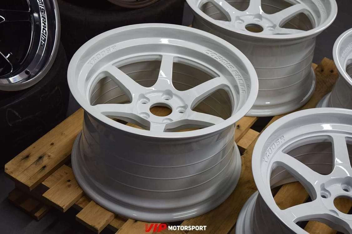

RoadHog Posted February 9, 2022 Posted February 9, 2022 Hello I have some new wheels coming in the coming weeks: Cosmis XT-006R - 18x9.5” ET10 (Front) - 18x11” ET8 (Rear) And 15mm spacers to clear brembos on the front Being new to custom wheels and getting the right fitment I'm after some advice on what tyre sizes I can or should run (bearing in mind I will also be lowing on tein coilovers in the next couple months) I'm thinking 255/35 front and 285/35 in the rear (so I'm not running too much stretch) but can still lower nicely (rears are already rolled) Will these work / look even? 285 sounds huge to me but they probably aren't in the grand scheme of things. I want a good look but I also don't want to be running extra weight where I don't need to Sorry for the newbie questions and thanks in advance Quote

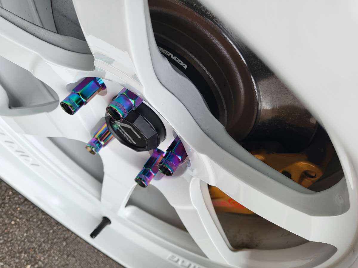

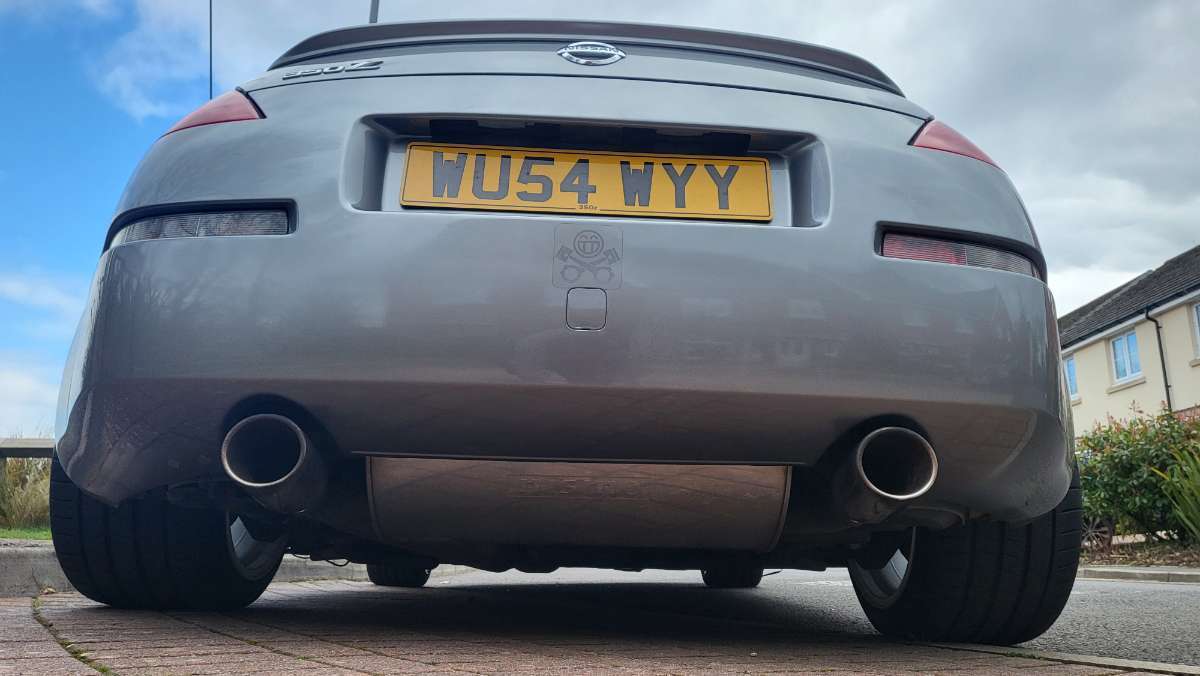

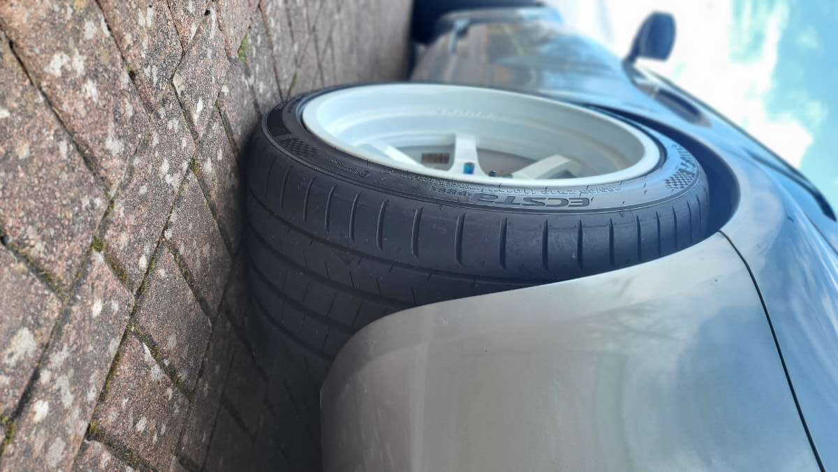

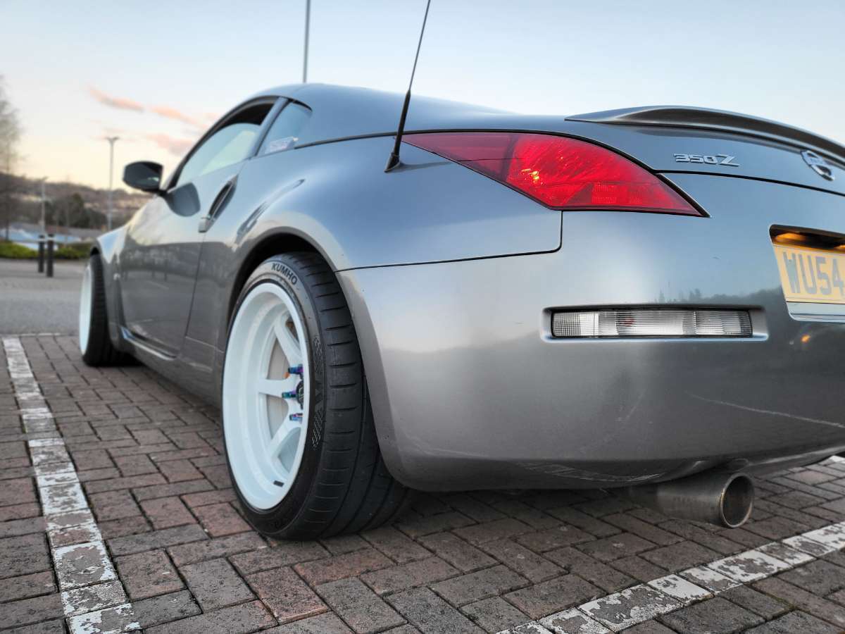

RoadHog Posted March 11, 2022 Author Posted March 11, 2022 PIC HEAVY... Wheels and tyres are on ! Bit of poke currently and rear arches need rolling, possibly pulling, and will be putting it on coilovers in very near future then get a good alignment job done, ...but I'm loving the look of it already Cosmis XT-006R - 18x9.5” ET10 (Front) Kumho Ecsta PS71 255/35 (15mm Direnza spacers to clear brembos on the front) - 18x11” ET8 (Rear) Kumho Ecsta PS91 285/35 Quote
davey_83 Posted March 11, 2022 Posted March 11, 2022 Do love these wheels and work well with lowered ride height. With lowering you'll naturally gain more negative camber too, however arch work definitely needed for your spec. @Dani350z car above 1 Quote
RoadHog Posted March 11, 2022 Author Posted March 11, 2022 23 minutes ago, davey_83 said: Do love these wheels and work well with lowered ride height. With lowering you'll naturally gain more negative camber too, however arch work definitely needed for your spec. @Dani350z car above Thank you! Im very happy with them! ...Yep, I've been looking high and low for someone local that does arch rolling, I'm in South Wales and the only place I can seem to find is Arch Enemy but they wont come this far.. well not without a big added cost anyway unless I had a group around here they might do a deal That's for another post in the near future though 😅 Quote
