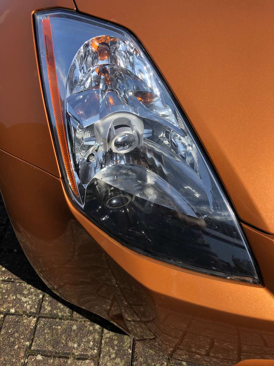

Got hold of an Auto Glym Headlight Restoration Kit, for under £30 and a little bit of time my cloudy headlights look so much better, really pleased with what you get in the kit and the clear instructions. Much cheaper than buying a pair if Headlights.
