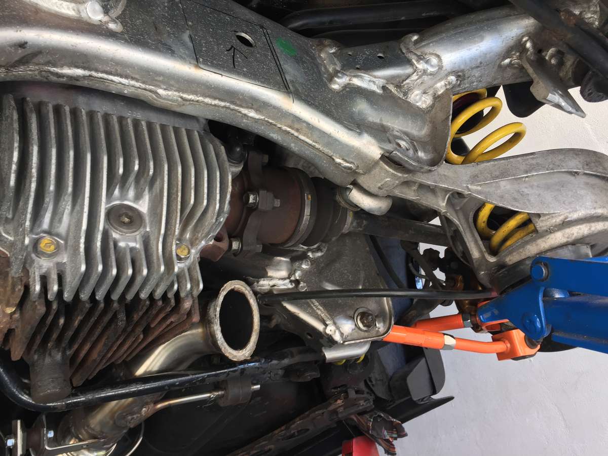

Ortega_9 Posted May 11, 2019 Author Posted May 11, 2019 And having done a few test runs the car is UN driveable with the heavy toe in. so taking the rearend apart to make room for more toe adjustment... i have a set of spc toe bolt on the Way home.... but i have to do something if i want to go Racing tonight.... Quote

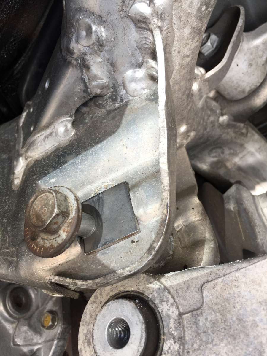

Ortega_9 Posted May 11, 2019 Author Posted May 11, 2019 I'we milled 5mm off the subframe to make room for the bolt to get toe to 0 degree.... then i made some supporte that go into the adjustment slot to keep the bolts into place, and then i hope that will do the trick 2 Quote
